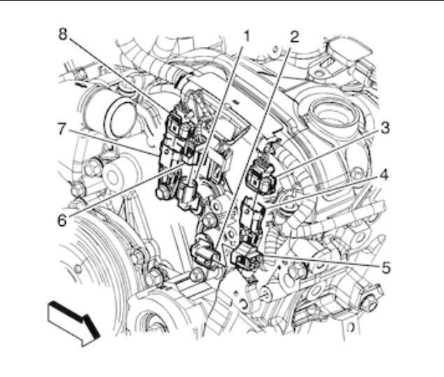

Camshaft position bank 2 location. picture i saw different diagrams and i'm confused. now i'm not sure the location. Please help!

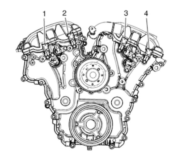

There are 4 cam sensors. On bank 2 there is an intake and exhaust sensor.

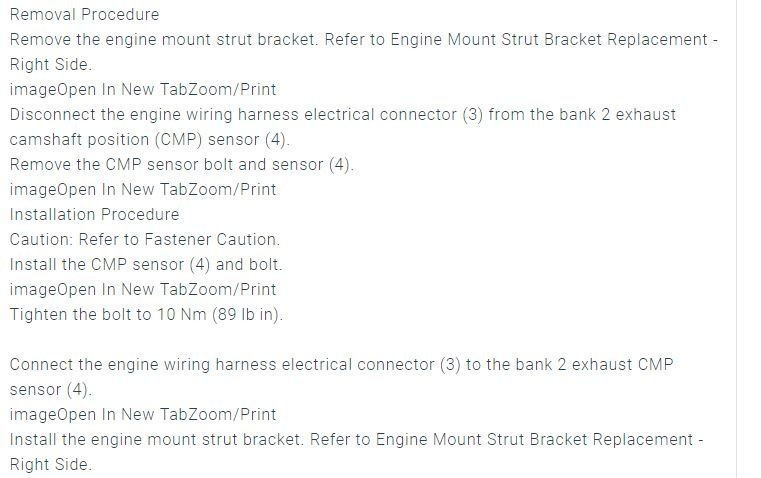

I attached the procedure for replacing it for you below.
https://www.2carpros.com/articles/camshaft-angle-sensor-replacement

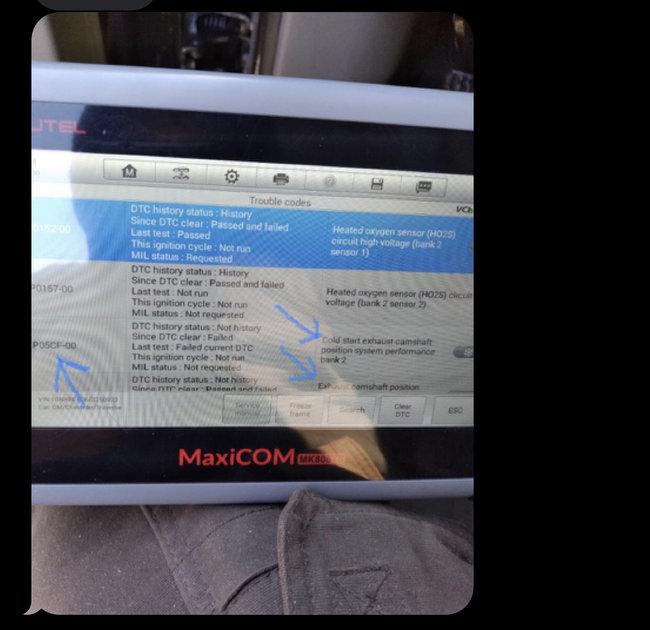

This is the code: P05CF-00 exhaust. Bank 2

Thank you.
It is number 4 in the picture.
