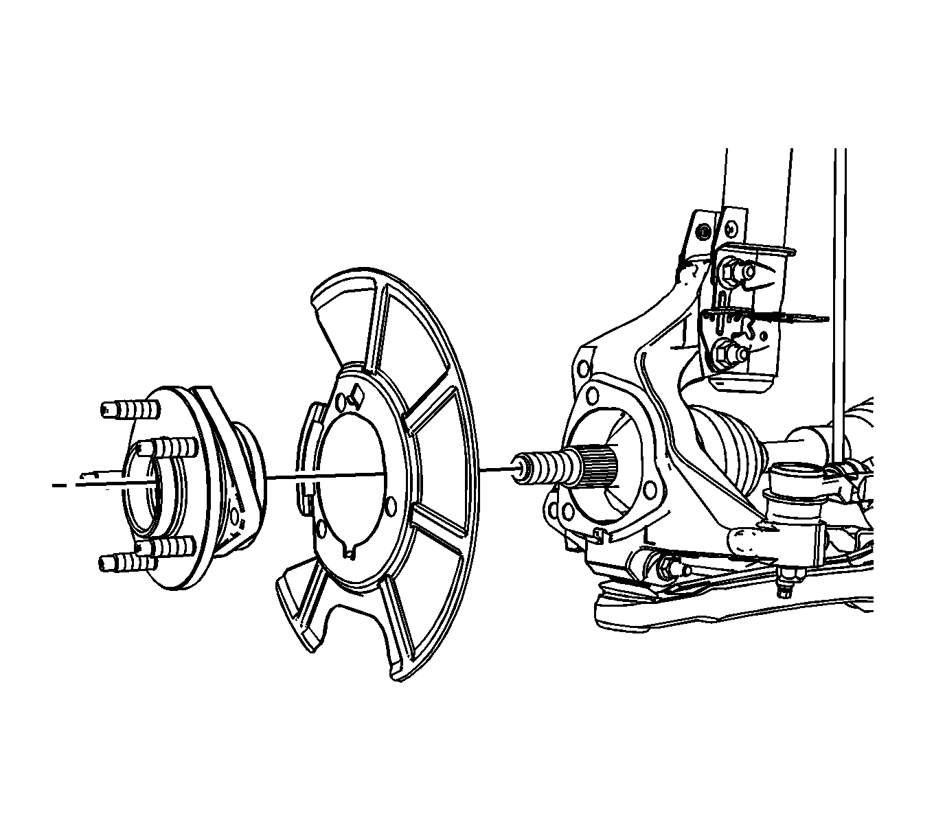

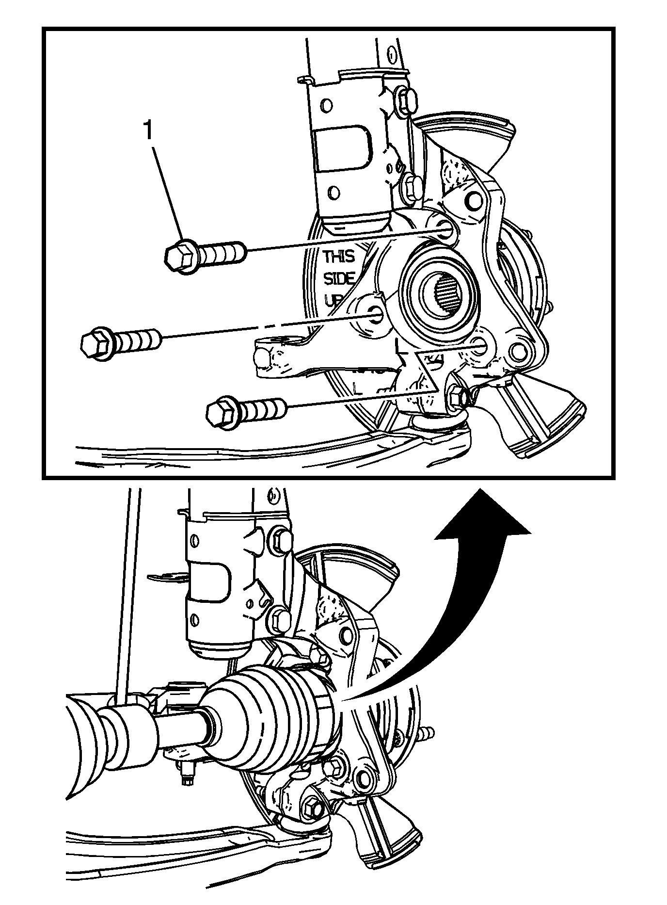

As far as a wheel speed sensor (aka an abs sensor), here is a link that explains how to test one. Also, I attached two pictures to help you locate the sensors. Pictures 1 and 2

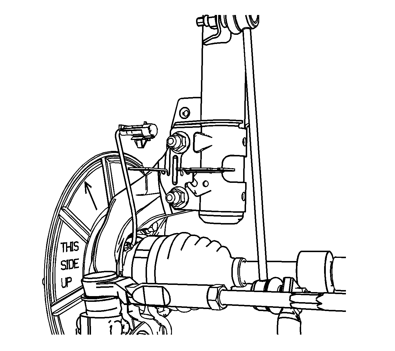

3. Remove the brake rotor. Refer to Rear Brake Rotor Replacement (See: Brake Rotor/Disc > Removal and Replacement).
pic 3
4. Disconnect the electrical connector from the wheel speed sensor, if equipped with ABS.
5. Remove the stabilizer link bolt at the knuckle and position the stabilizer link out of the way in order to provide access to the wheel bearing/hub nuts. Refer to Stabilizer Shaft Replacement (See: Stabilizer Bar, Sway Control > Removal and Replacement > Stabilizer Shaft Replacement).
6. Remove the 4 wheel bearing/hub assembly nuts.
7. Remove the wheel bearing/hub assembly from the knuckle.

pic 3 again
1. Install the wheel bearing/hub assembly to the knuckle.
Caution: Refer to Fastener Caution (See: Vehicle > Vehicle Damage Warnings > Fastener Caution).
2. Install the 4 wheel bearing/hub assembly nuts.
Tighten the nuts to 63 Nm (47 lb ft).
3. Connect the stabilizer link bolt at the knuckle. Refer to Stabilizer Shaft Replacement (See: Stabilizer Bar, Sway Control > Removal and Replacement > Stabilizer Shaft Replacement).
4. Connect the electrical connector to the wheel speed sensor, if equipped with ABS.

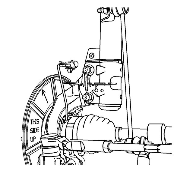

2. Remove the brake rotor. Refer to Front Brake Rotor Replacement (See: Brake Rotor/Disc > Removal and Replacement).
pic 4
3. Disconnect the wheel speed sensor electrical connector, if equipped.
4. Remove the wheel speed sensor electrical connector from the mounting bracket, if needed.

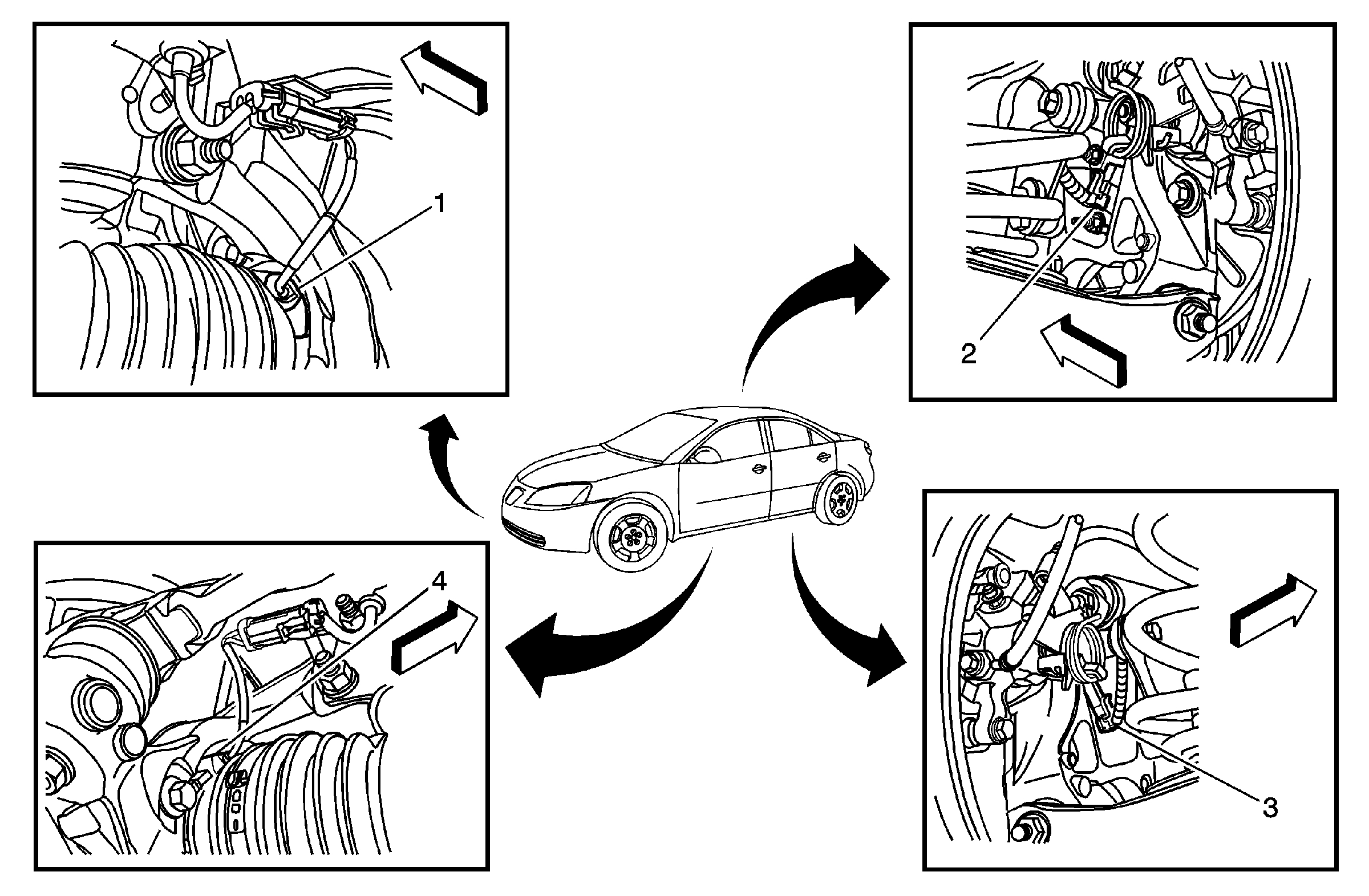

5. Loosen the wheel drive shaft from the wheel bearing/hub. Refer to Wheel Drive Shaft Replacement (See: Axle Shaft Assembly > Removal and Replacement > Wheel Drive Shaft Replacement).

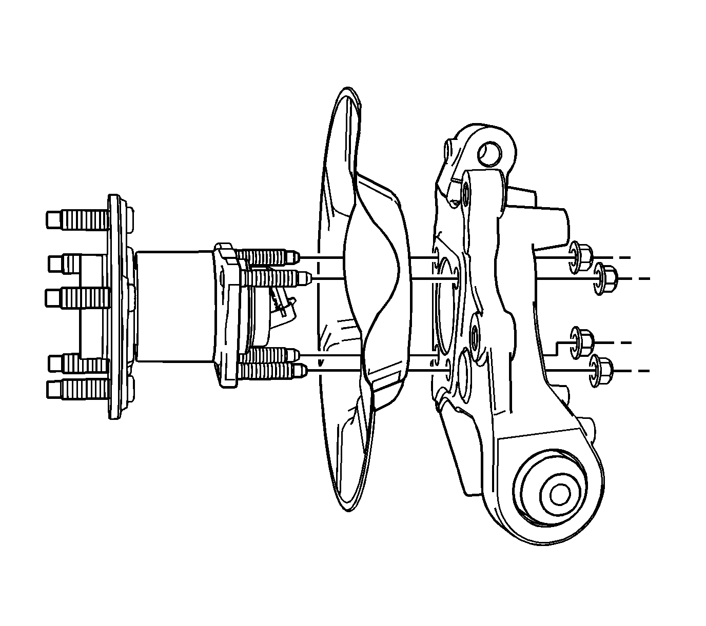

6. Remove the wheel bearing/hub mounting bolts (1).
pic 6
7. Remove the wheel bearing/hub and backing plate from the steering knuckle.

I realize this seems like a lot, but I can help you if needed. If you can, first confirm the brake fluid is full. If it is, the next thing I would do if possible is have the computer scanned by someone that has a scanner that can read more than just power-train codes. That will most likely point you in the right direction of the cause. If that isn't possible, you will need to check each sensor for a signal using the directions I listed above.
