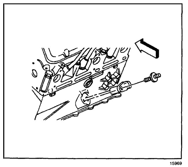

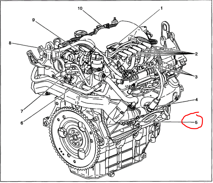

Pic 1 shows location.

pic 2
1. Turn OFF the ignition.
2. Raise the vehicle. Refer to Lifting and Jacking the Vehicle.
3. Remove the right tire and wheel.
4. Turn steering wheel fully to the left.
5. Disconnect the sensor electrical connector.
6. Remove the attaching bolt/screw.
7. Remove the sensor from engine.
8. Inspect for wear, cracks, or leakage if the sensor is not being replaced.

pic 3
1. Lubricate the O-ring with clean engine oil before installation and replace if damaged.
2. Install the sensor to the block.
NOTE: Refer to Fastener Notice in Service Precautions.
3. Install the CKP sensor attaching bolt.
Tighten
Tighten the bolt to 11 N.m (97 lb in).
4. Connect the sensor electrical connector.
5. Install the right tire and wheel.
6. Lower the vehicle.
7. Perform the CKP System Variation Learn Procedure. See: Vehicle > Programming and Relearning

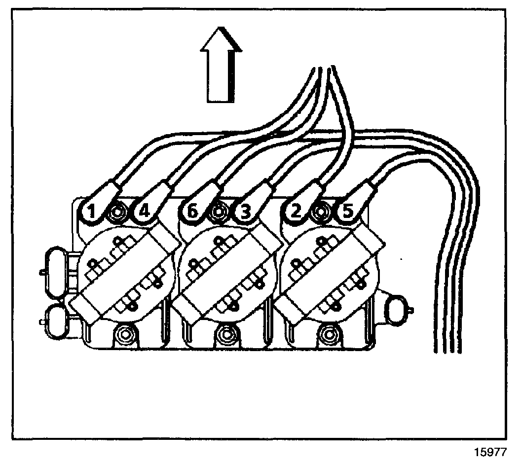

You replaced just about everything. The only thing left is the ICM (ignition control module). It is what the coils mount to. What I would suggest is to remove the module and have it tested at a parts store.
Here are the directions for removal and replacement. The pics correlate with the directions.

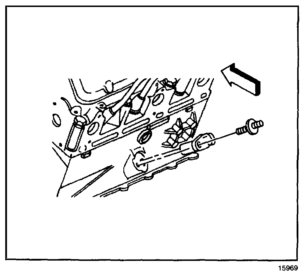

REMOVAL PROCEDURE
pic 1
2. Disconnect all the electrical connectors at the ignition control module (ICM).
3. Note position of spark plug wires for installation and disconnect the spark plug wires from the ignition coils.
4. Remove the screws securing the coil assemblies to the ICM.
5. Disconnect the coils from the ICM.
6. Remove the ICM from the module mounting bracket.
INSTALLATION PROCEDURE
pic 2
1. Install the ICM on the module mounting bracket.
2. Install the coils to the ICM.
3. Install the screws through the coils and the module into the module mounting bracket.
Tighten
Tighten the screws to 4.5 N.m (40 lb in).
4. Connect the spark plug wires as noted during the removal.
5. Connect the electrical connectors to the ICM.
