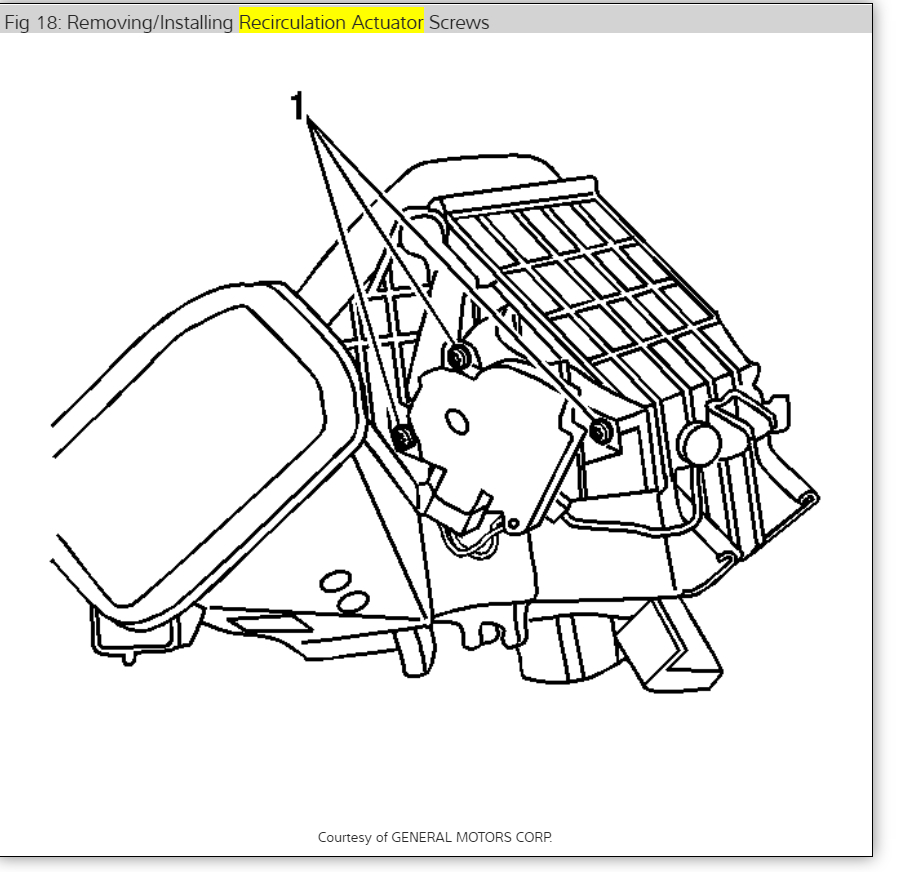

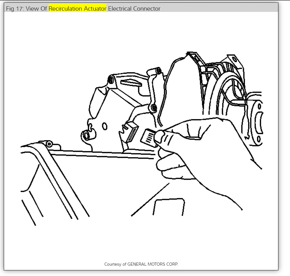

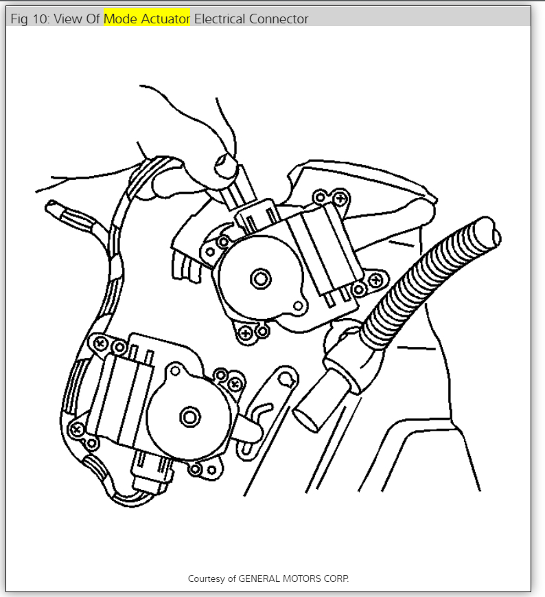

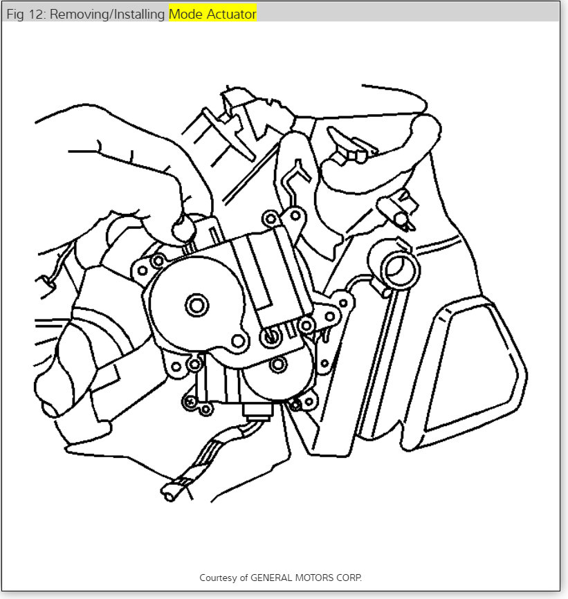

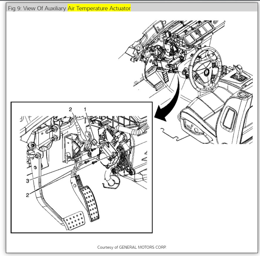

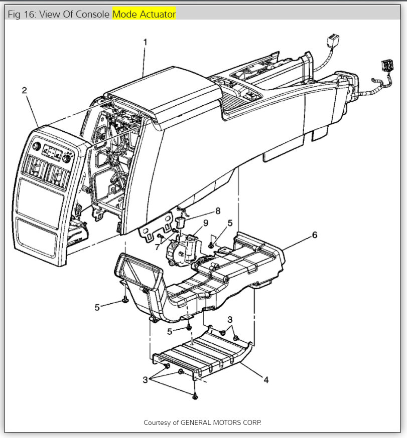

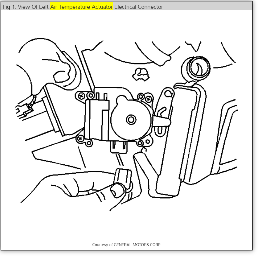

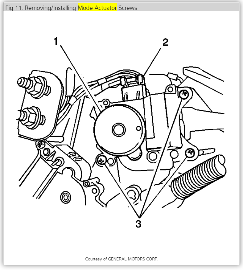

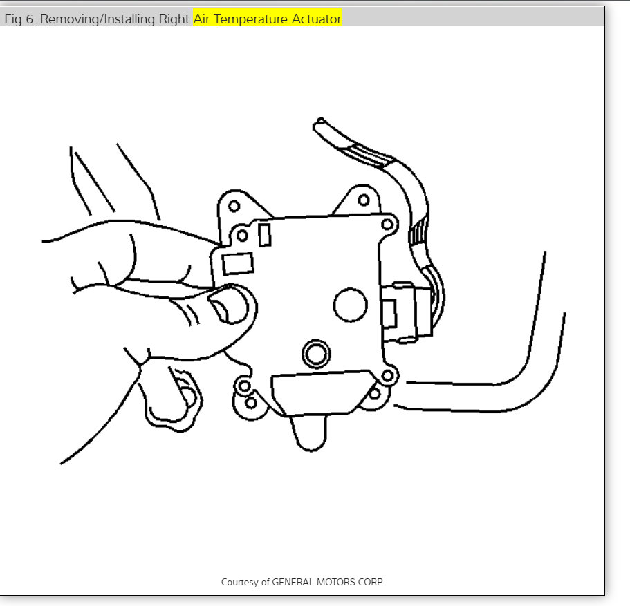

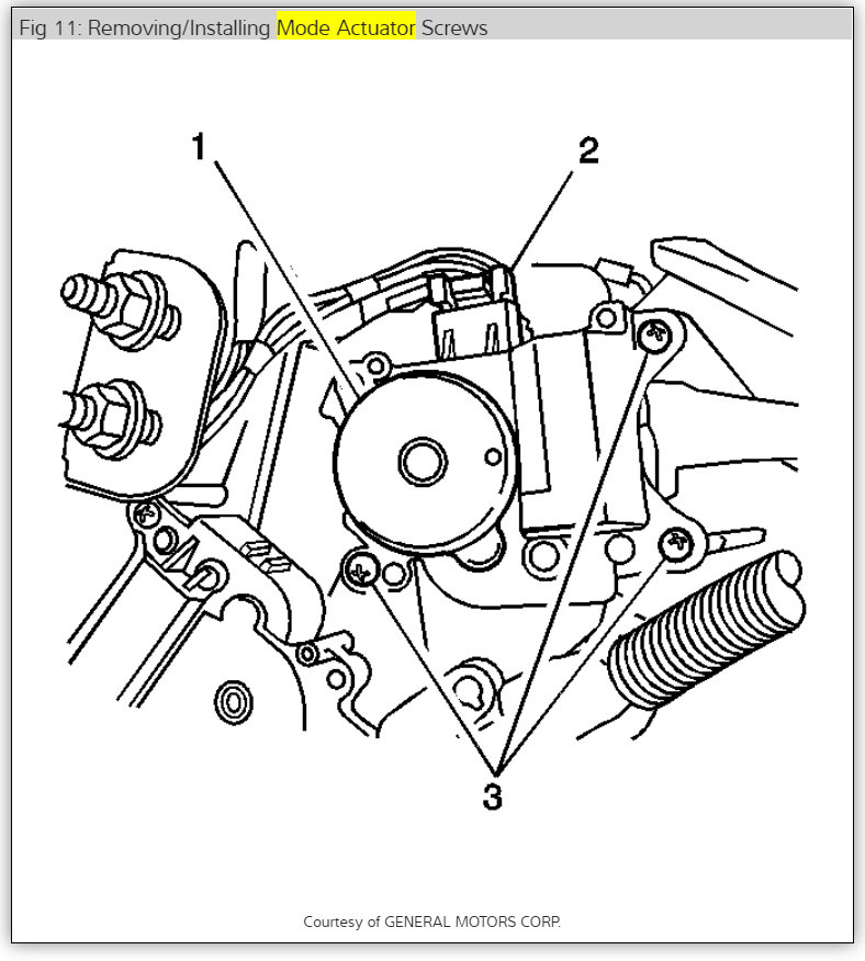

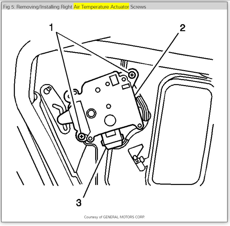

Yes the clicking is telling you you have a air blend door actuator that is out. Here is a guide that will give you an idea of what you are in for when changing the unit out:
Here is where the actuators are in your car (below).
