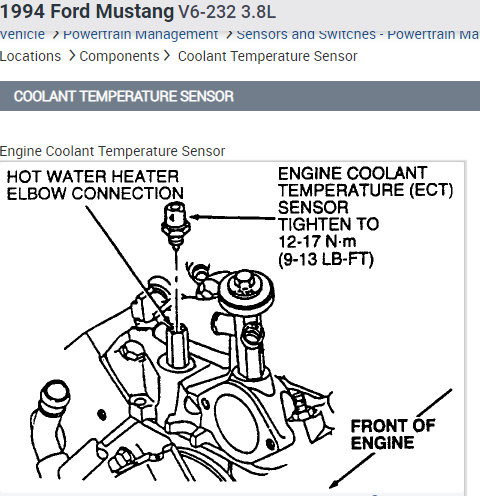

Make sure you do not have any type gunk built-up around where the sensor goes in. Just in case any restriction blocking coolant to reach the sensor.

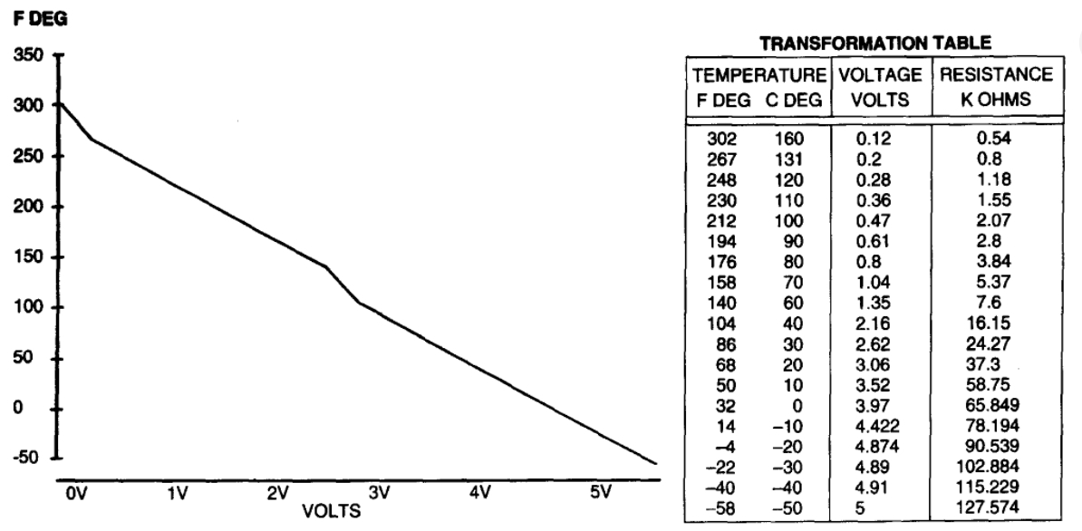

Seems likely that could do it.. after playing around with the multimeter on sensor with car running, sensor will just drop down to like 1.33-1.77 volts after hitting half indicating 104-170 degrees about then it with flat line and ever so slowly continue dropping closer to that .35-.60 volts required to trigger the fans. not sure what would block it there’s coolant under the sensor.

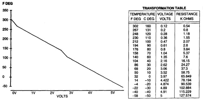

I have attached the temperature chart for your reference.
Keep me posted.
Thank you.

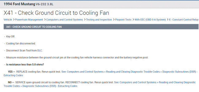

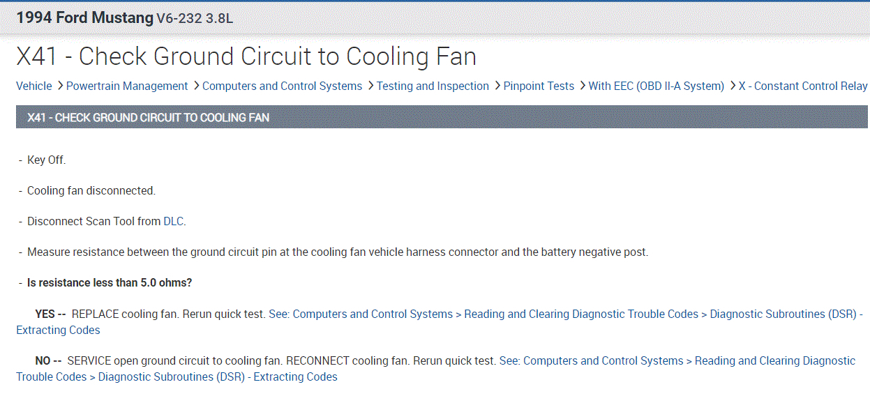

Do me a favor. Check the gound circuit. See the diagnostics below. It's a simple test.
Let me know what you find.
