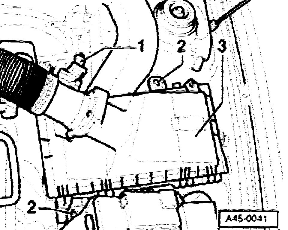

^ Disconnect or connector -1- of Mass Air Flow (MAF) sensor from air filter tube.
^ Remove bolts -2- at air filter -3- and move filter to left side.

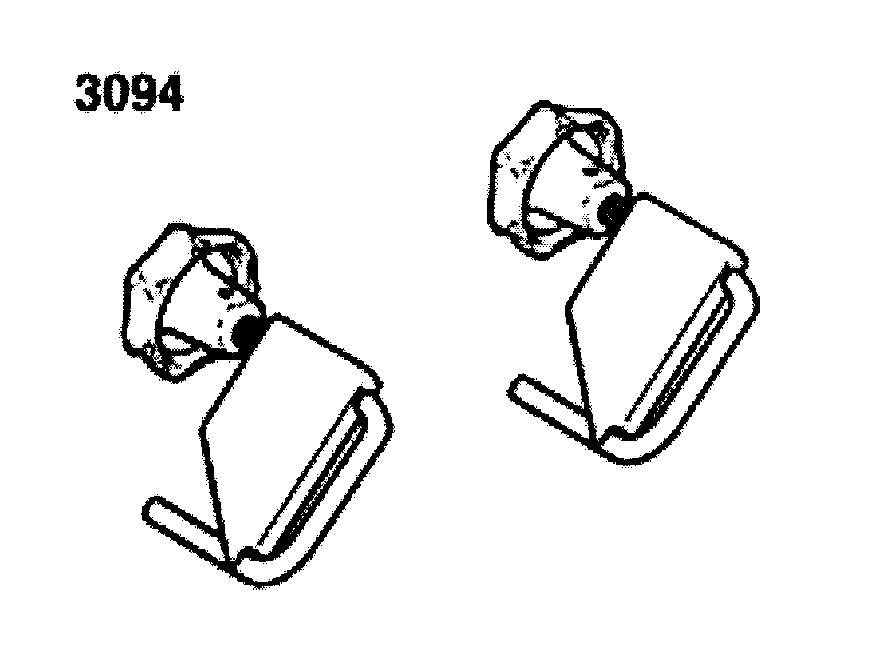

^ Clamp clutch master cylinder supply hose with clamp 3094.
^ Remove clutch master cylinder supply hose from reservoir.

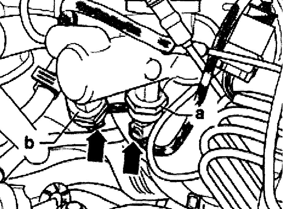

^ Disconnect wiring connectors from pressure sensors -a- and -b-.

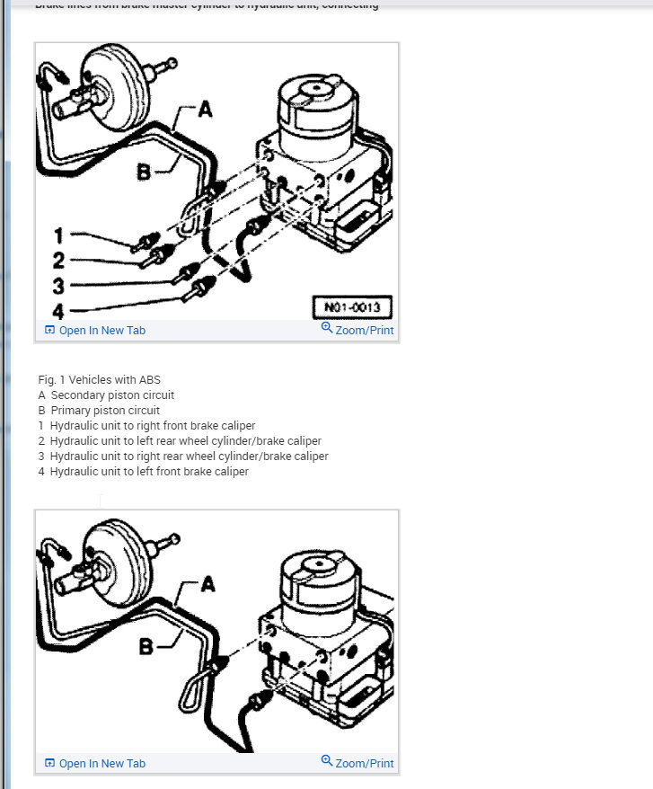

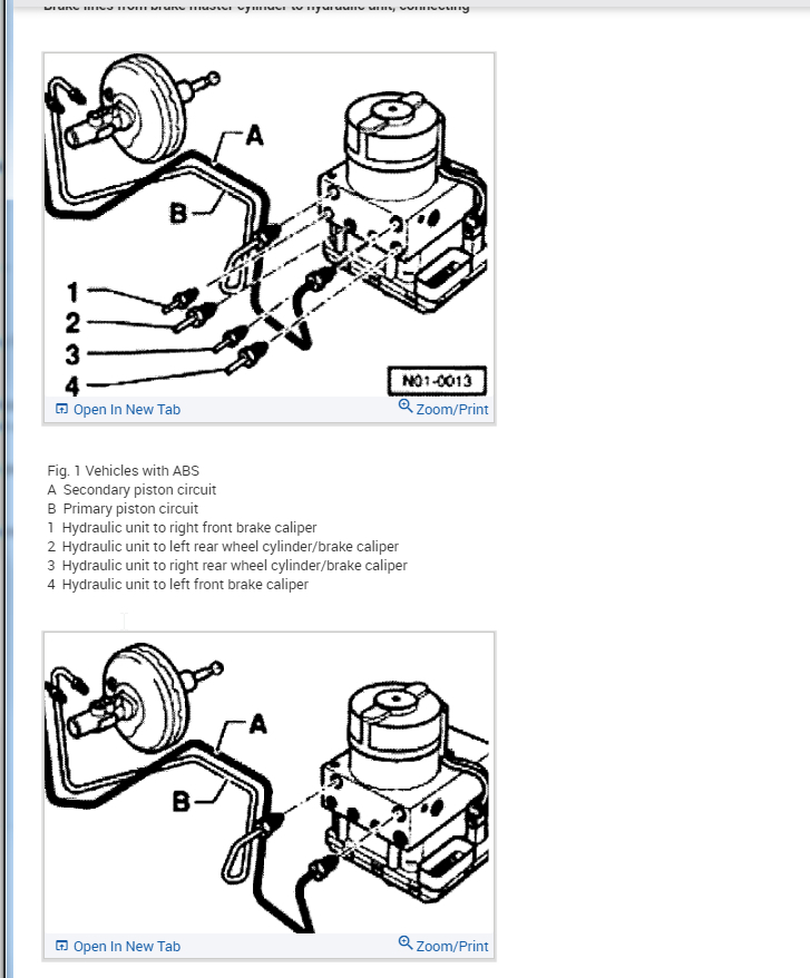

More than likely you have a leak. Have you found any fluid on the ground?
If not, then I suspect the hydraulic unit is leaking internally.

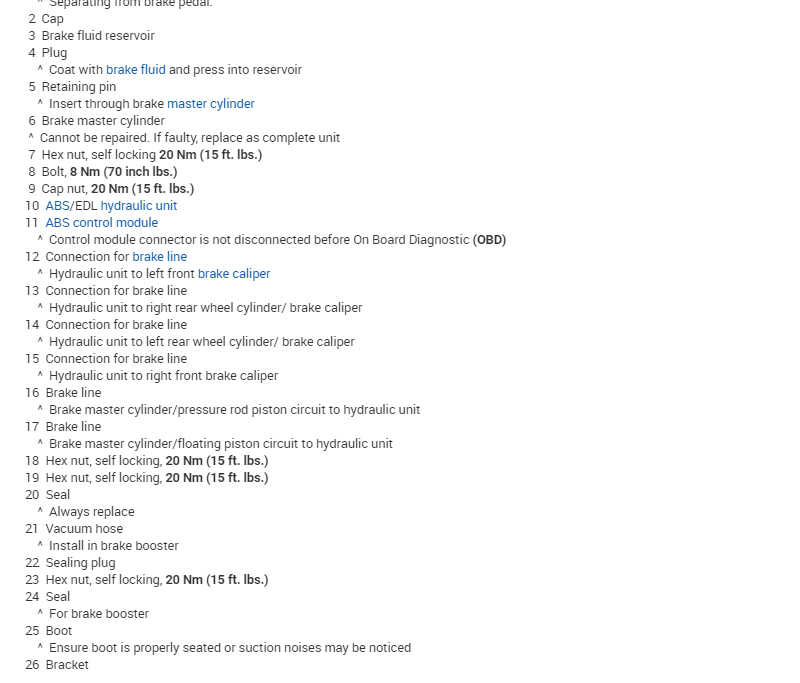

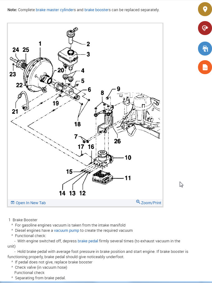

Clearly we need to check out the basics. Here is a guide that will run through the most common causes. Let us know what you find.
I also attached some generic info about your brake system just to get us started.
https://www.2carpros.com/articles/brake-pedal-goes-to-the-floor
