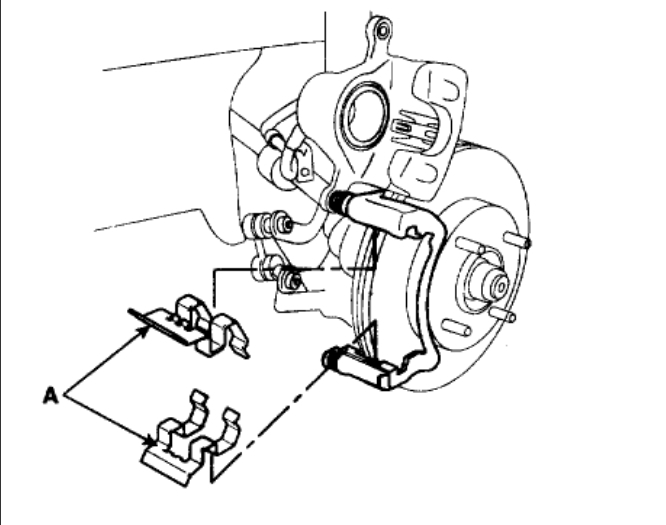

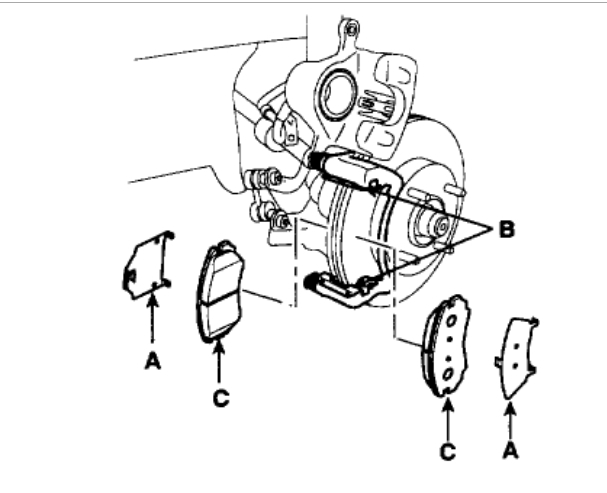

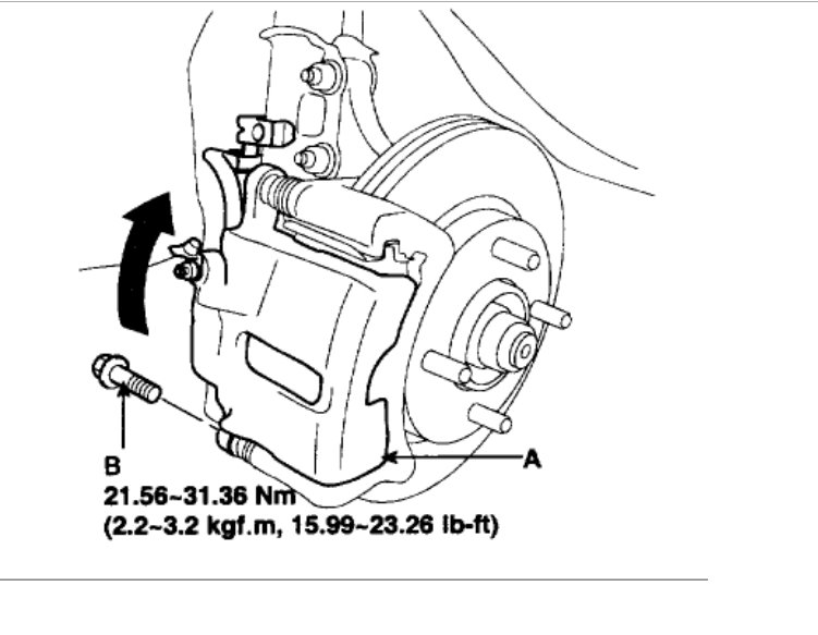

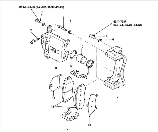

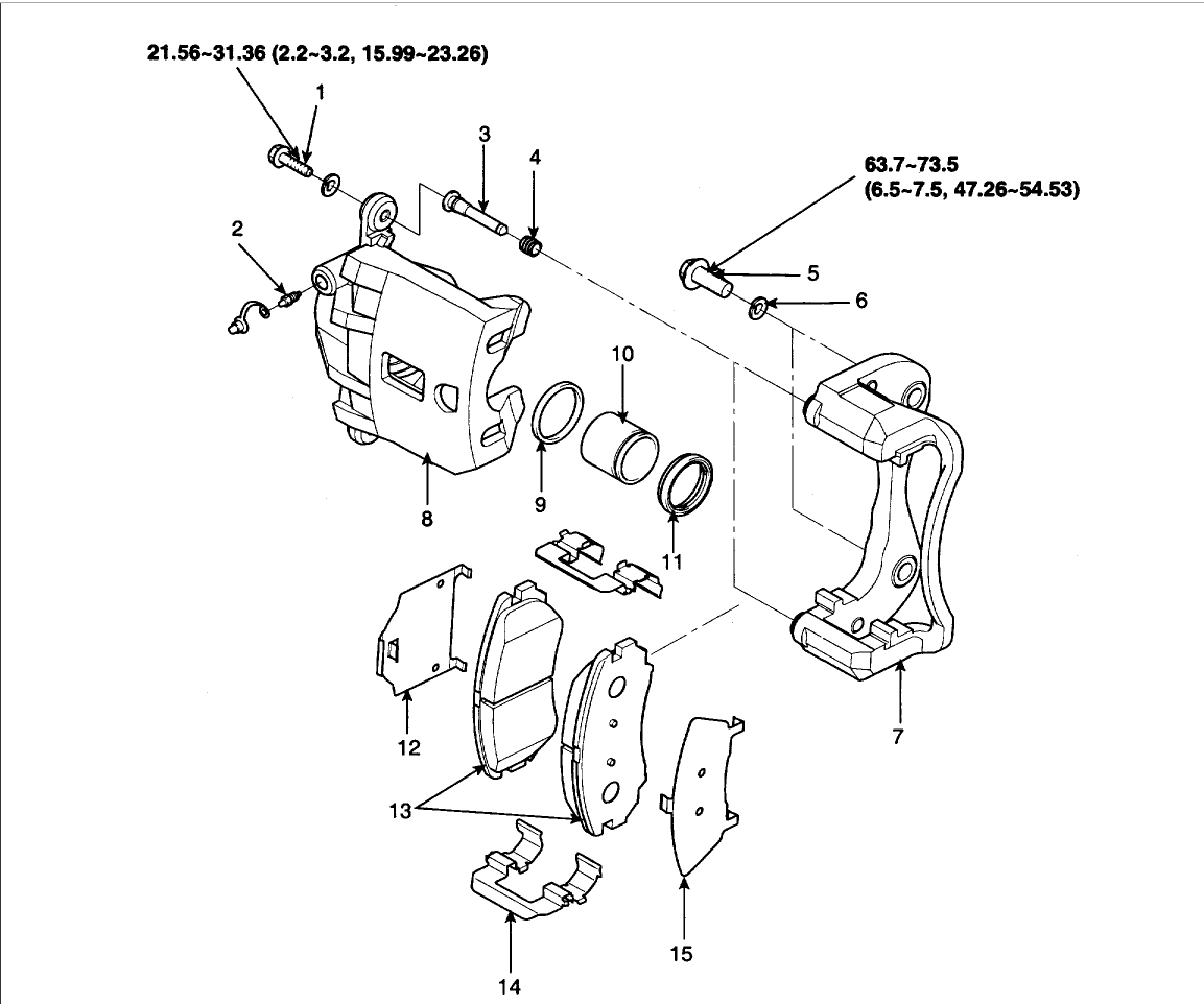

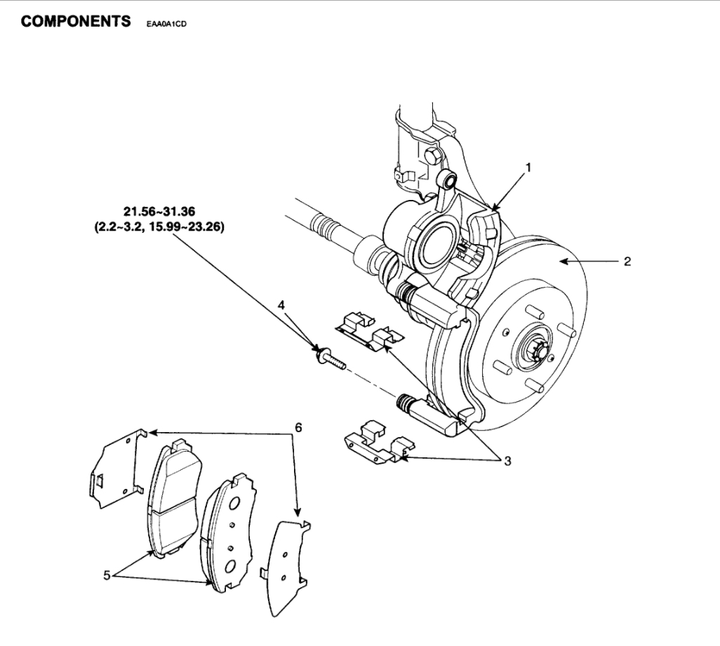

It sounds like for the brake light is the front pads are worn down and it lowers the brake fluid in the reservoir causing the brake warning light to come on.
Here is a video and guide that will show you what you are in for when doing the front brakes:
https://youtu.be/7zjHSFVangI
and
As far as the air bag light you will need to read the codes to see what come up. We are working on a video for that right now and will have it in a few days if you can wait that long.
