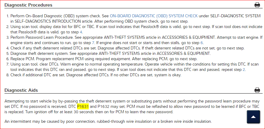

I put the machine and those codes pop out. Please need some help. Turn down sometime and sometimes it will not in the dashboard. It comes out security from time to go the way. No check engine, somebody went through this. Please help me send me a message to let me know how to work on my truck!
Codes p1631 and p1632. Thank you so much.
