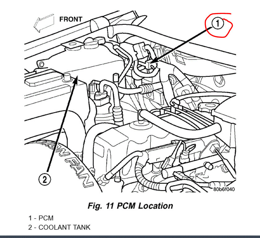

Wow, the codes are all over the place. You have already done a lot. After looking through everything, I see one correlation and that's they are all controlled by the PCM.

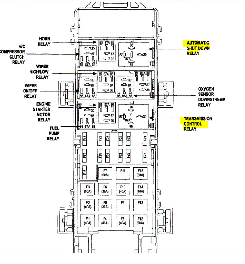

The PCM is next to the coolant overflow reservoir (see pic 1). Check to make sure nothing was disconnected, damaged, or loose. Also, I want you to check the auto shutdown relay (ASD) and the transmission control relay. Both are under the hood in the power distribution box. (see pic 2)
