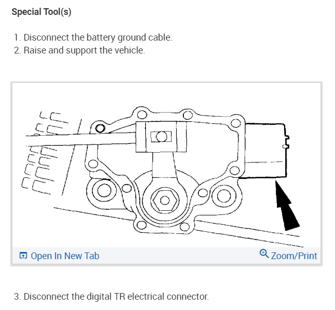

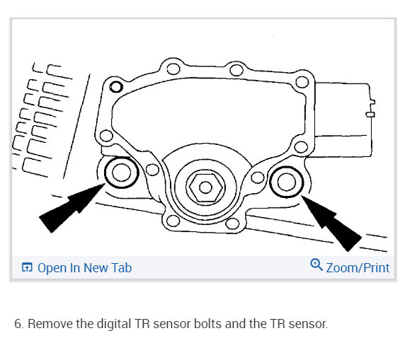

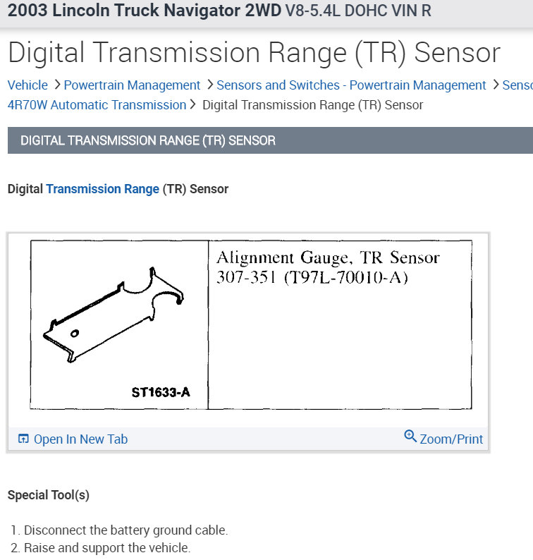

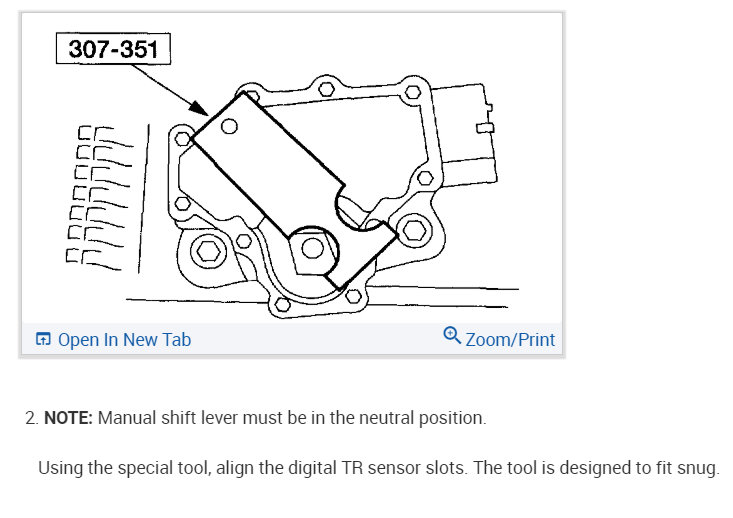

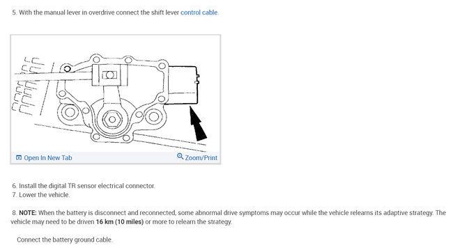

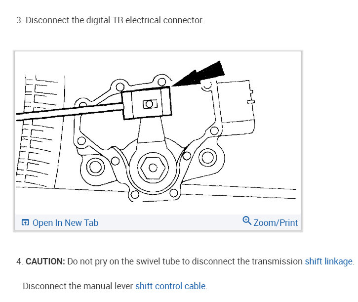

Tried to bypass and jump the starter, starter will crank but vehicle will not. Tried moving the shifter into neutral, will not turn over, tried moving it into park multiple times, will not turn over, all lights and air and radio work, battery has charge.not sure what part I need to get, some dealerships say shifter and shifter nob, others say modulator.
Sep 28, 2019 at 8:27 AM

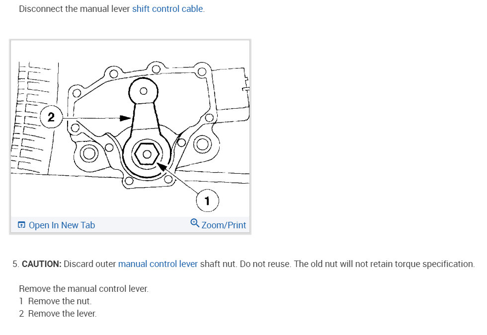

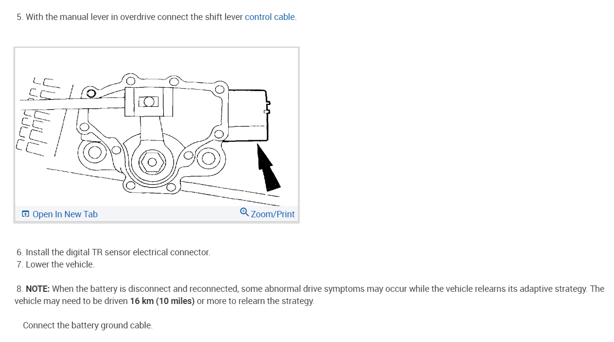

This is common when the gear range sensor needs to be replaced. here are the instructions and location of the sensor so you can change it out and then clear the codes:
https://youtu.be/ahK_eucFi-k
