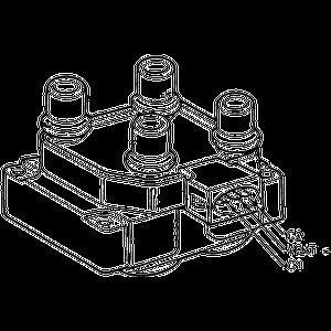

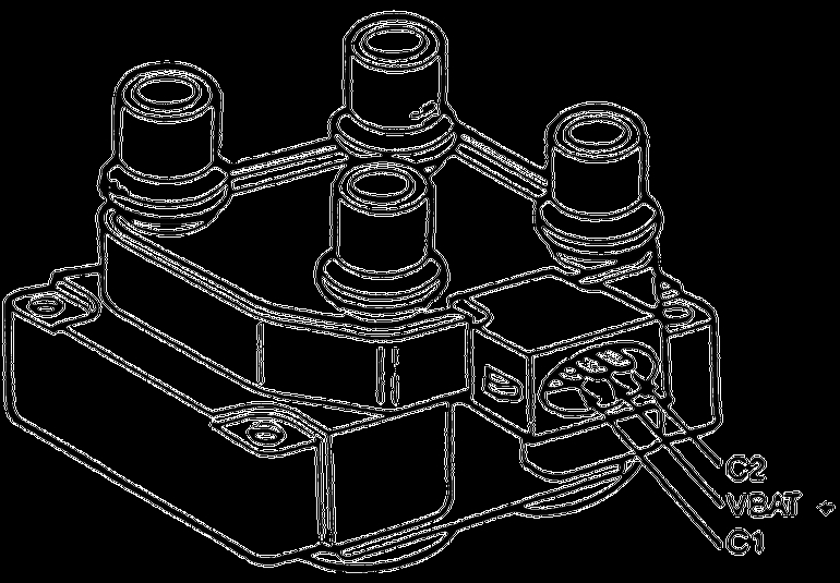

4.Measure the resistance between terminals VBAT + and C1 with a digital volt Ohmmeter (DVOM) set on the two kilohms scale. Refer to the accompanying illustration.
5.If the reading is not greater than 0.4 ohms, replace the coil.
6.Measure the resistance between terminals VBAT + and C2 with a DVOM set on the two kilohms scale. Refer to the accompanying illustration.
7.If the reading is not greater than 0.4 ohms, replace the coil.
Figure 2: Measure the resistance between the EDIS coil pack terminals VBAT + and C1 with a DVOM set on the two kilohms scale.

Fig. 1: Probe the terminals of the coil pack with a DVOM to check resistance.

That does not look right, let me try this.
Nov 2, 2017 at 8:35 AM
PATENTED_REPAIR_PRO
  • 1,853 POSTS
or maybe this,
Nov 2, 2017 at 8:36 AM
PATENTED_REPAIR_PRO
  • 1,853 POSTS
That is better
