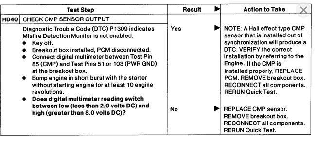

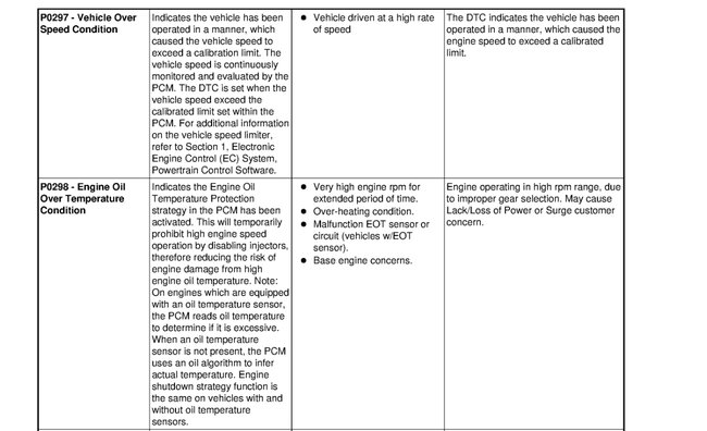

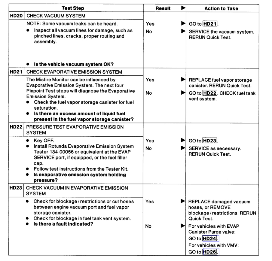

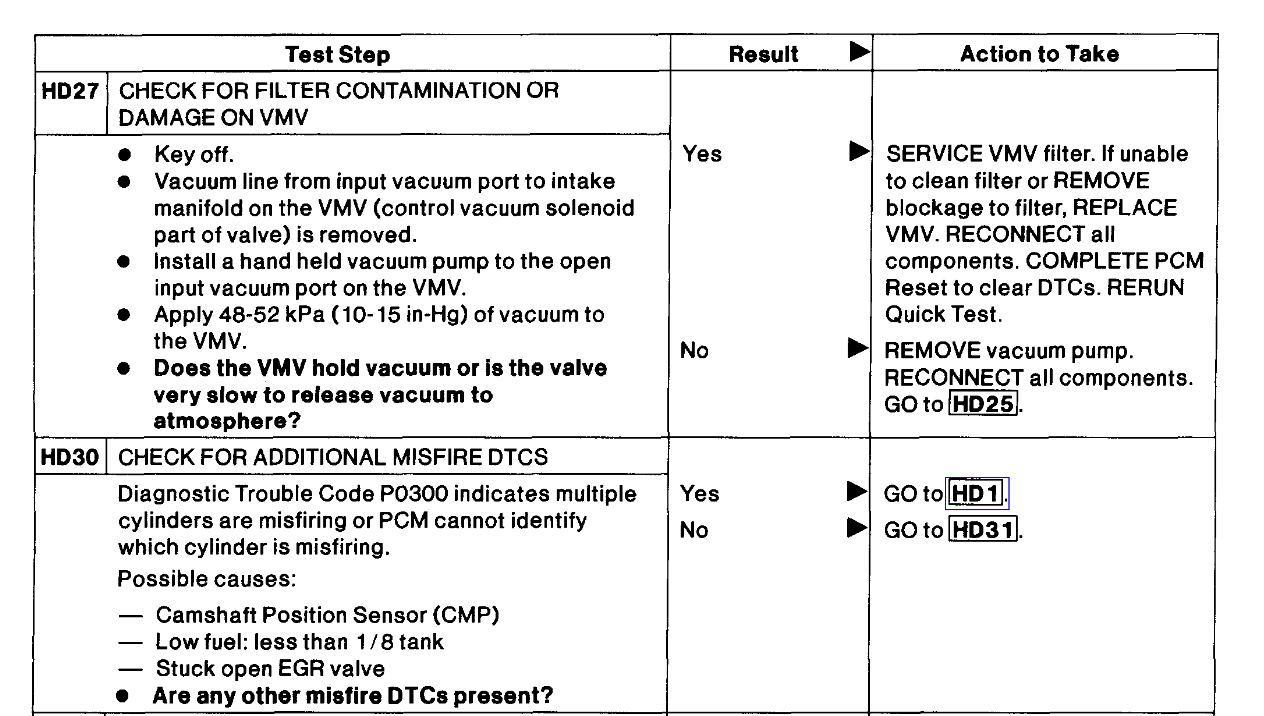

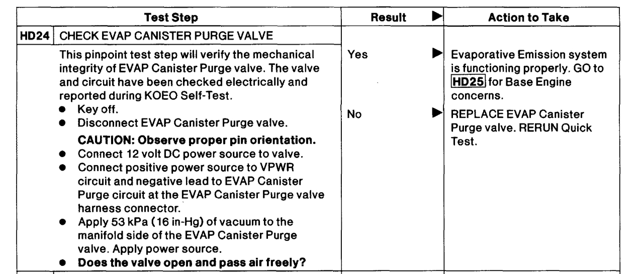

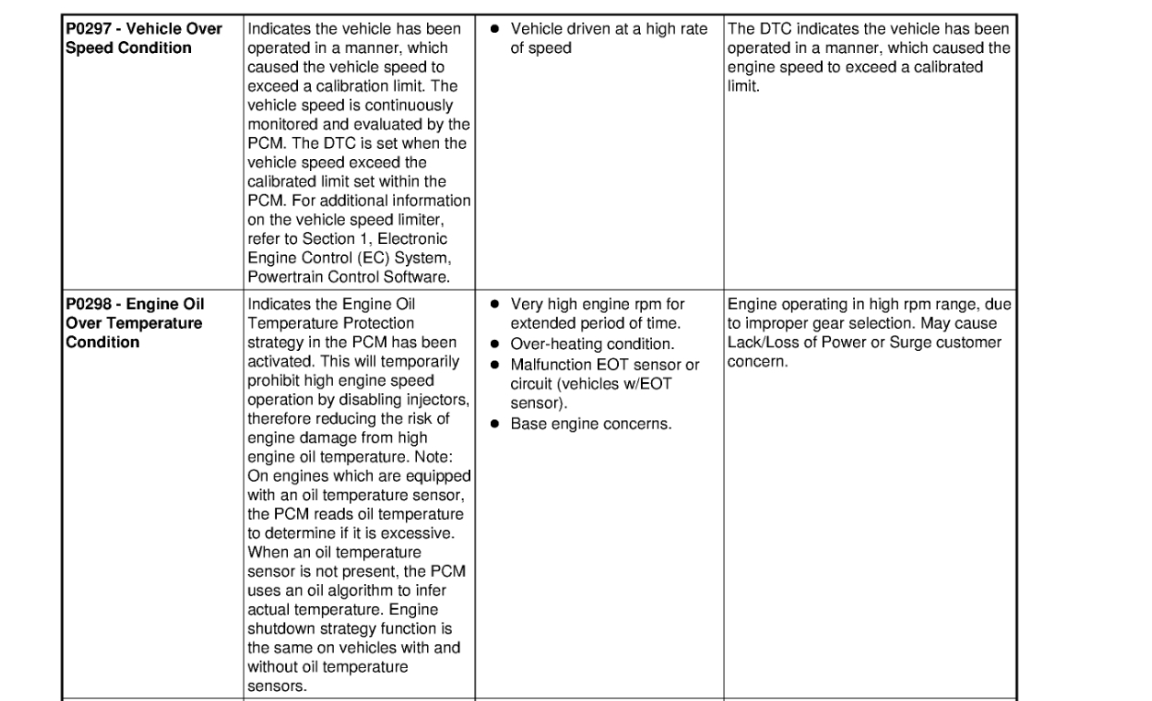

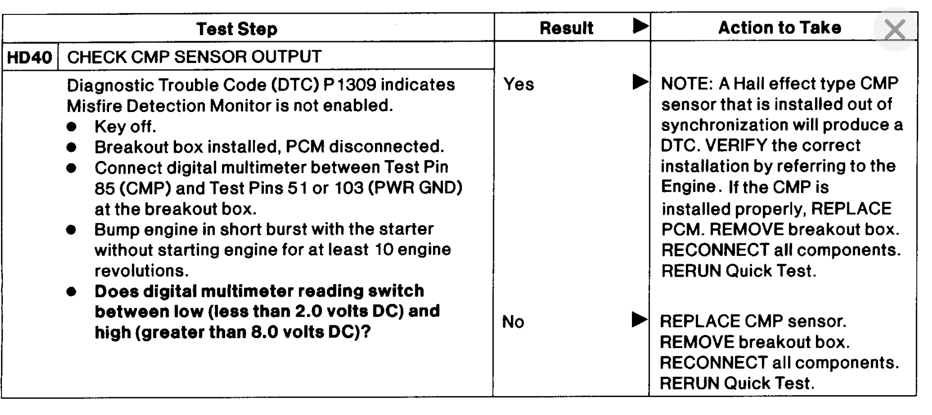

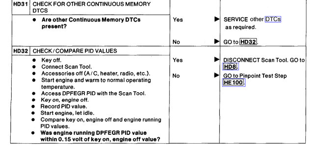

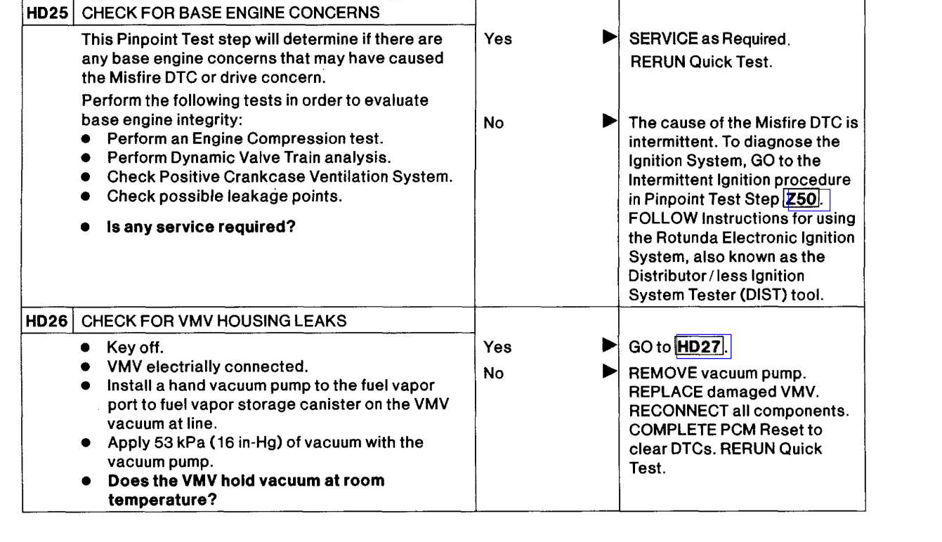

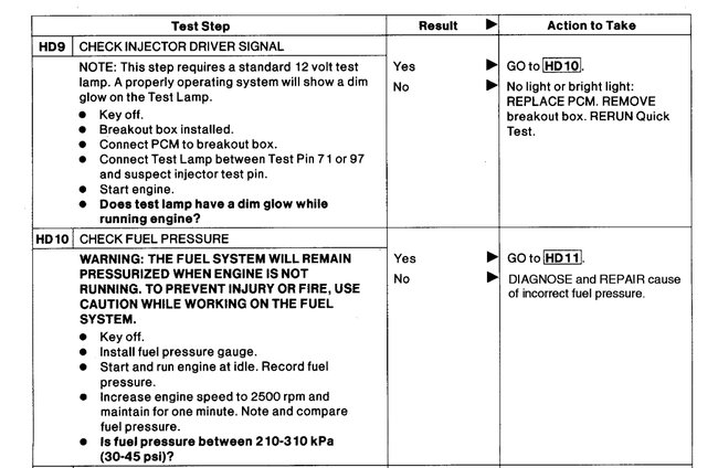

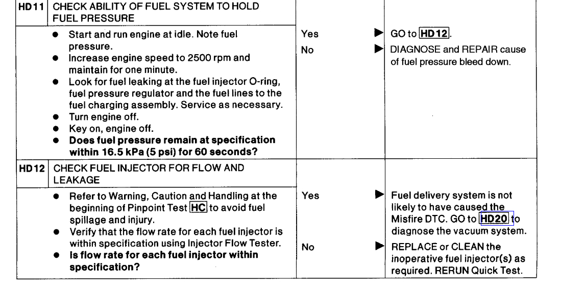

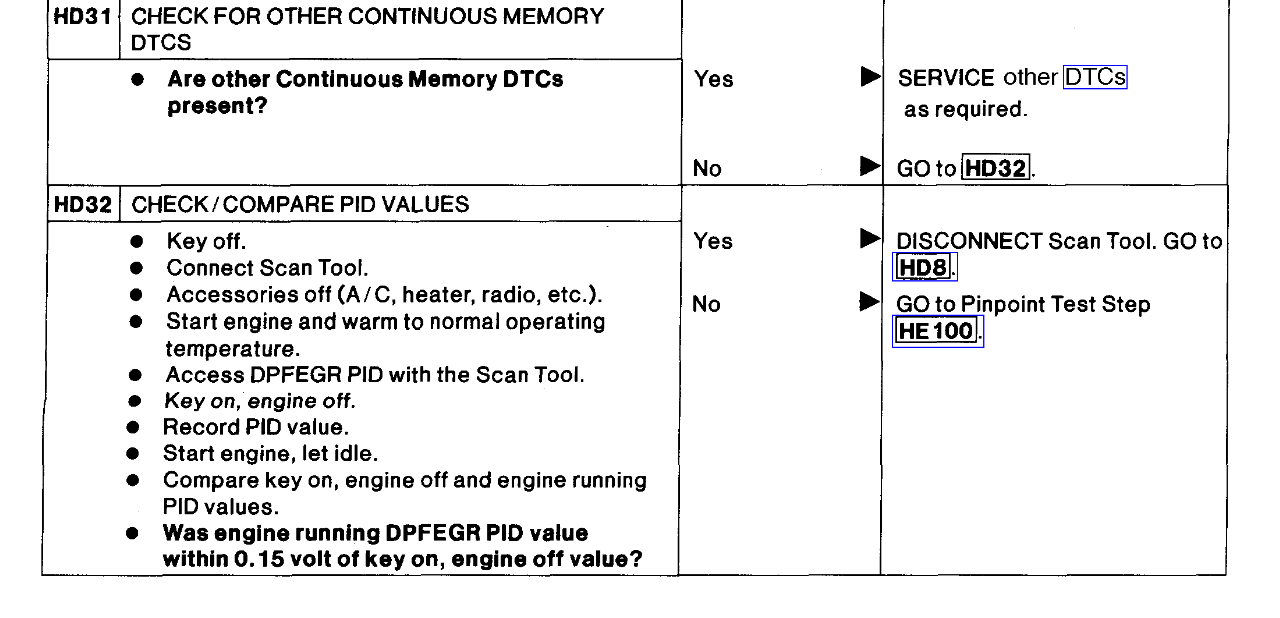

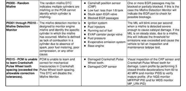

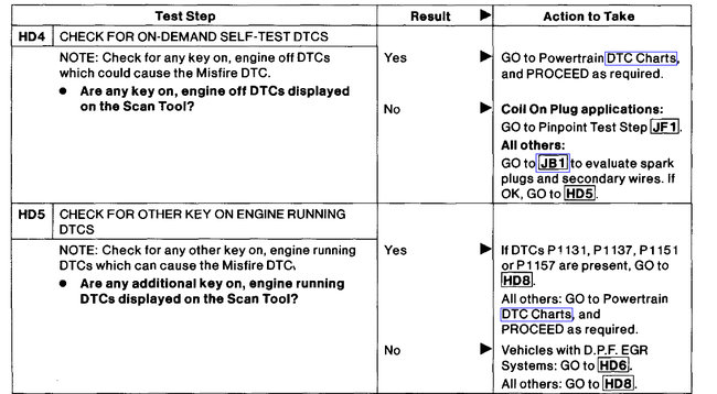

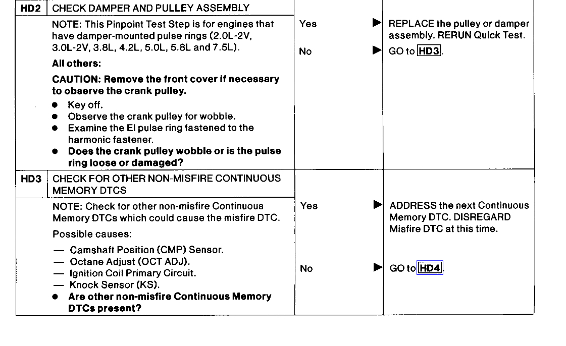

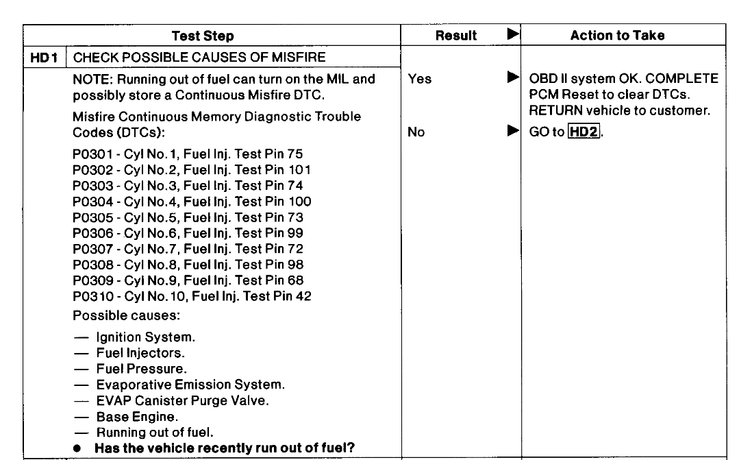

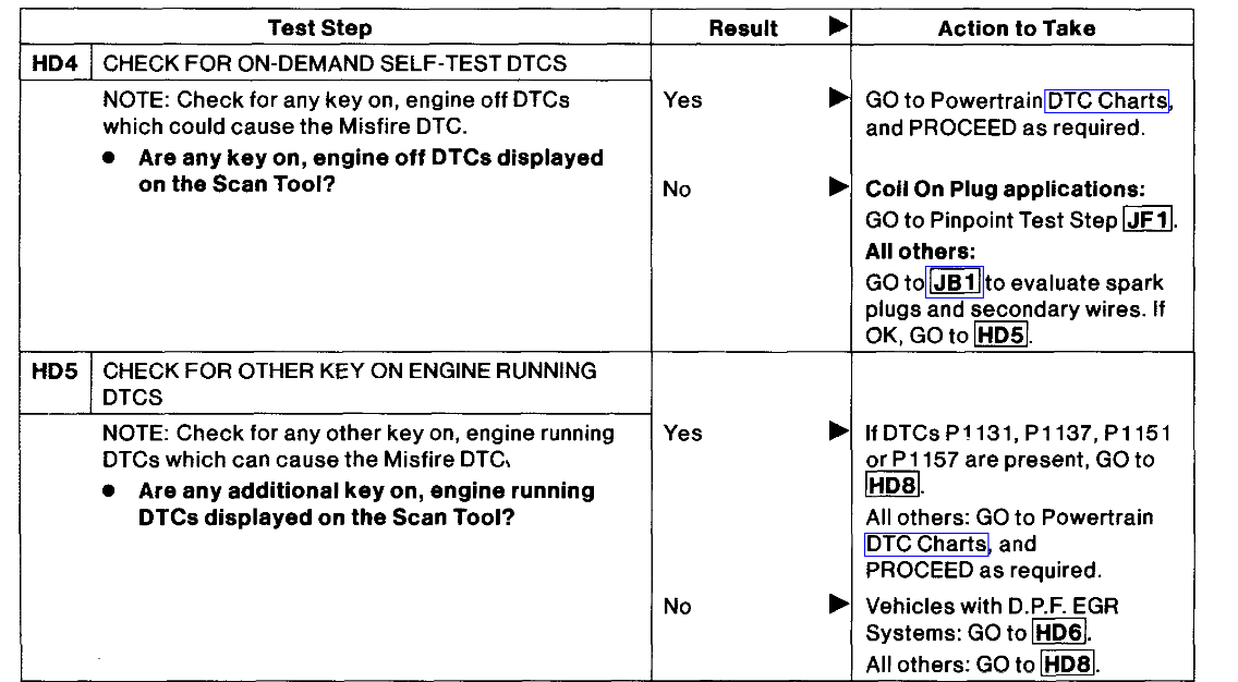

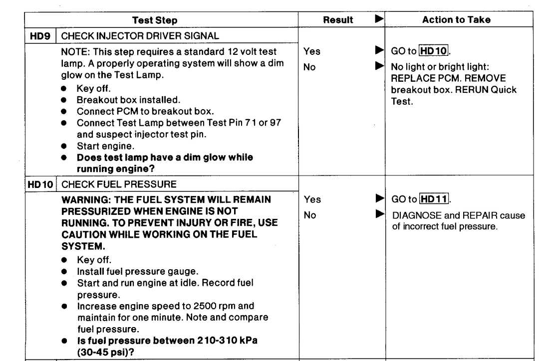

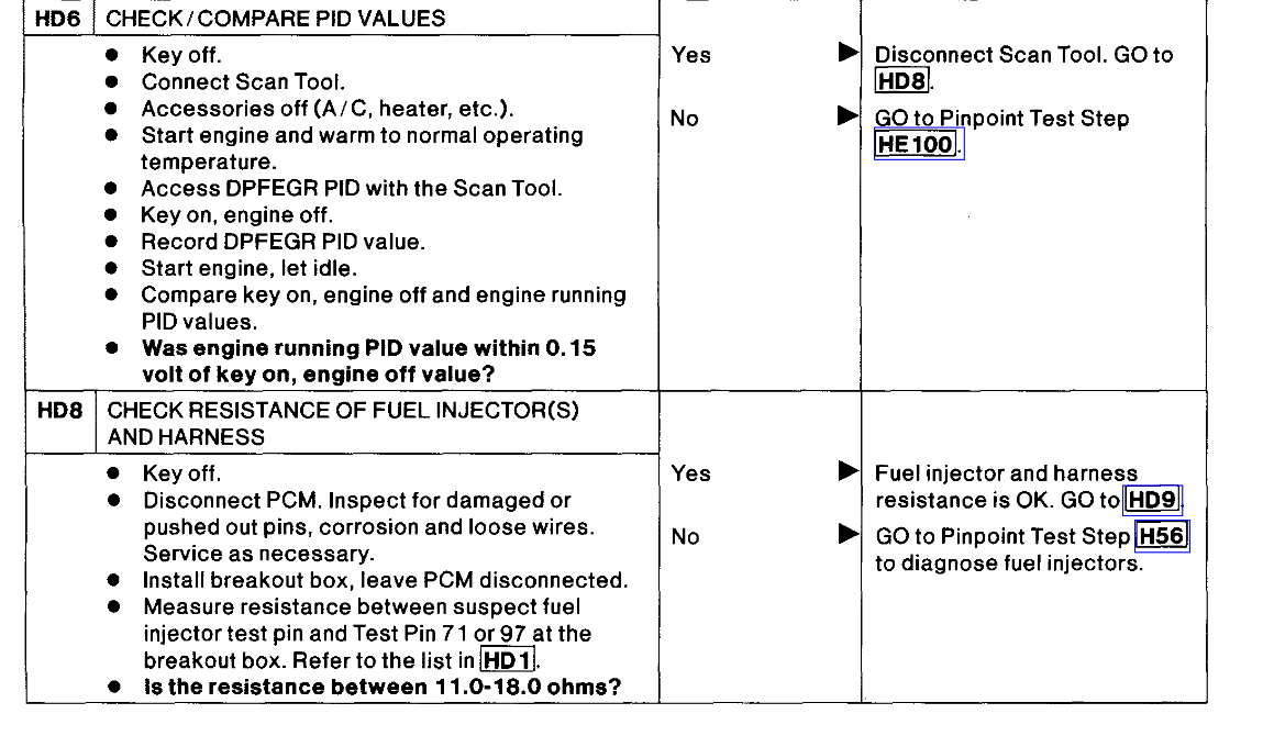

Double check your Direct Trouble Code(s). Misfire DTC's are P0300-P0310. Anyway I have included the factory troubleshooting guide for DTC(s) P0300 - P0310 in the diagrams down below. Please go through these guides and get back to us with what you are able to find out.
Thanks,
Alex
2CarPros
