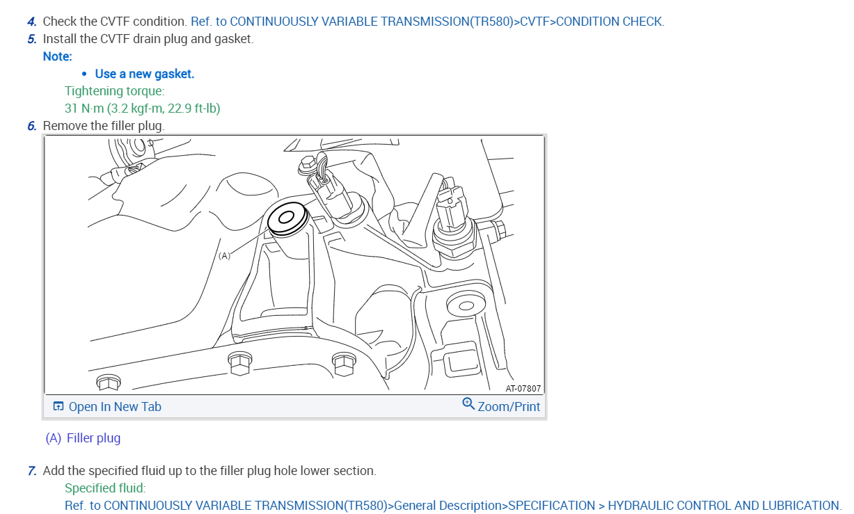

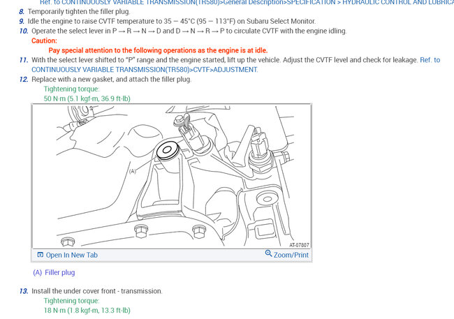

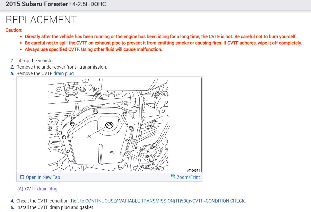

Yes, it is a good idea to service the transmission. Here is a guide to help and the instructions on how to service your car in the images below.
Specified fluid: SUBARU CVT OIL FOR LINEARTRONIC
Caution:
Always use specified CVTF. Using other fluid will cause malfunction.
Although CVTF filter is a maintenance-free part, replace it if a large quantity of wear debris and metal particles are found in CVTF and CVTF filter.
This guide can help walk you through the steps:
Check out the images (below). Please let us know if you need anything else to get the problem fixed.
