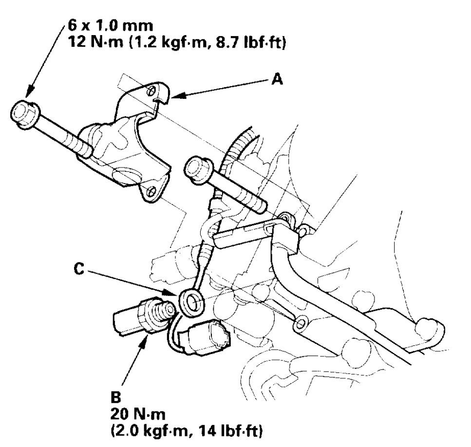

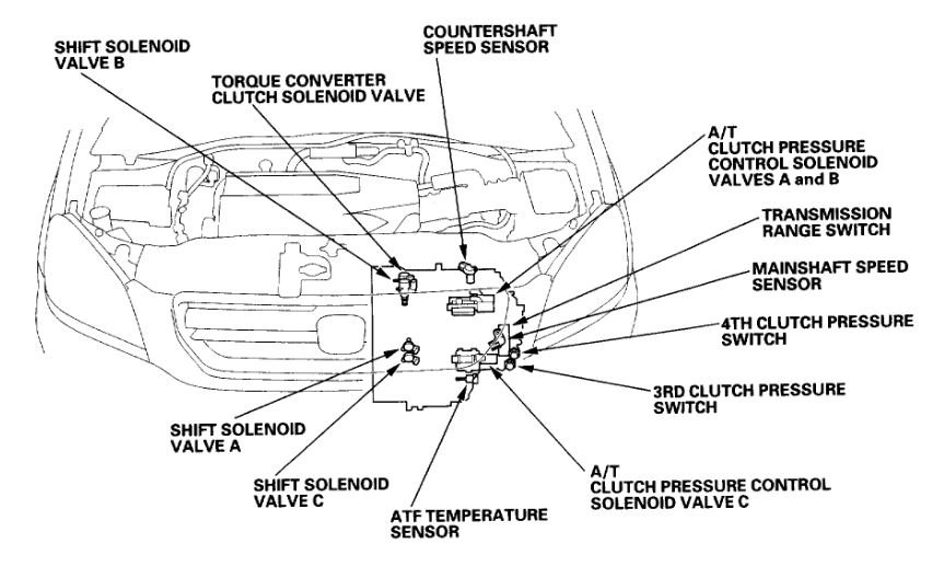

Welcome to 2CarPros. The third pressure switch is hidden under a cover on the bottom corner of the transmission case on the drivers side. You remove the cover, disconnect the wiring, then be sure the replacement has the new seal on it. Now remove the old switch and install the new one. There are a couple versions of the switch, one uses a regular hex wrench and the other uses an oil pressure sender socket. Check the old part and the new one to be sure you have the correct tools first.
