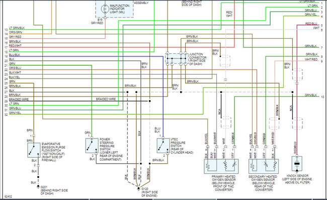

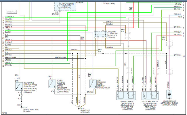

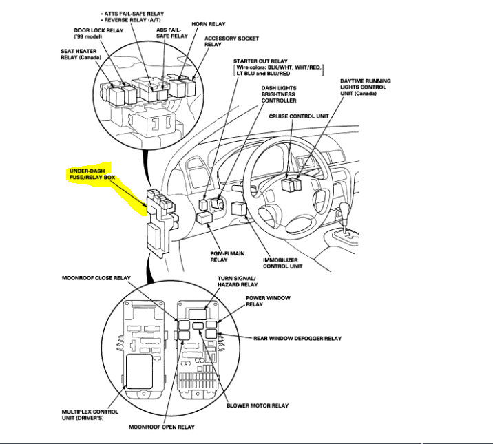

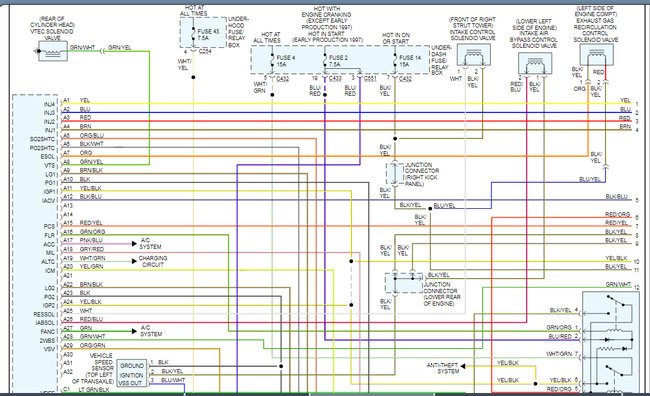

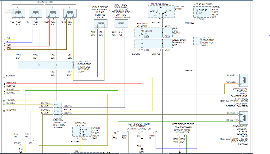

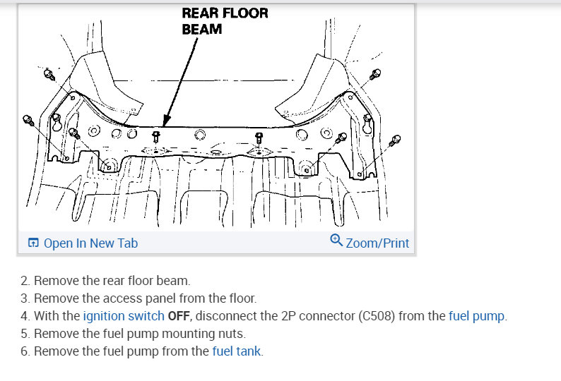

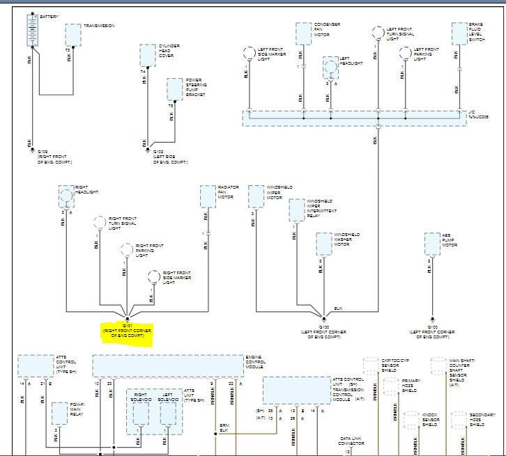

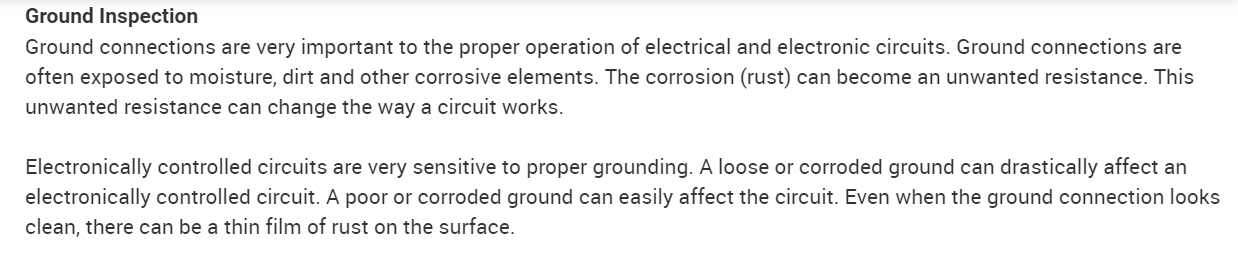

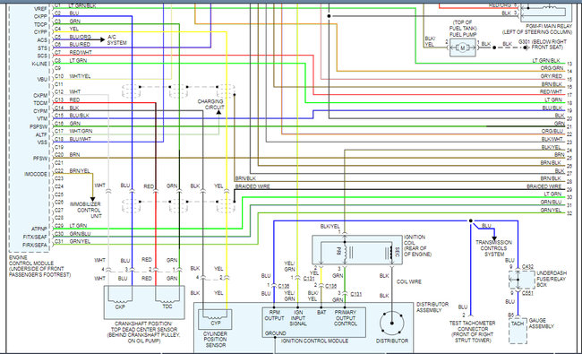

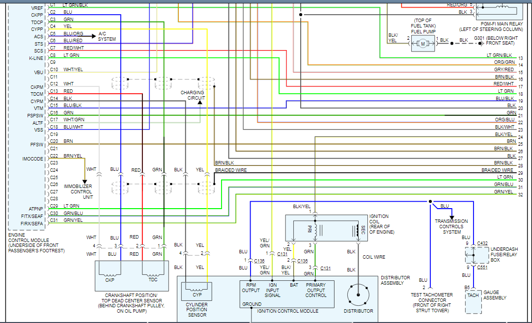

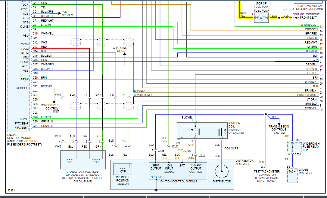

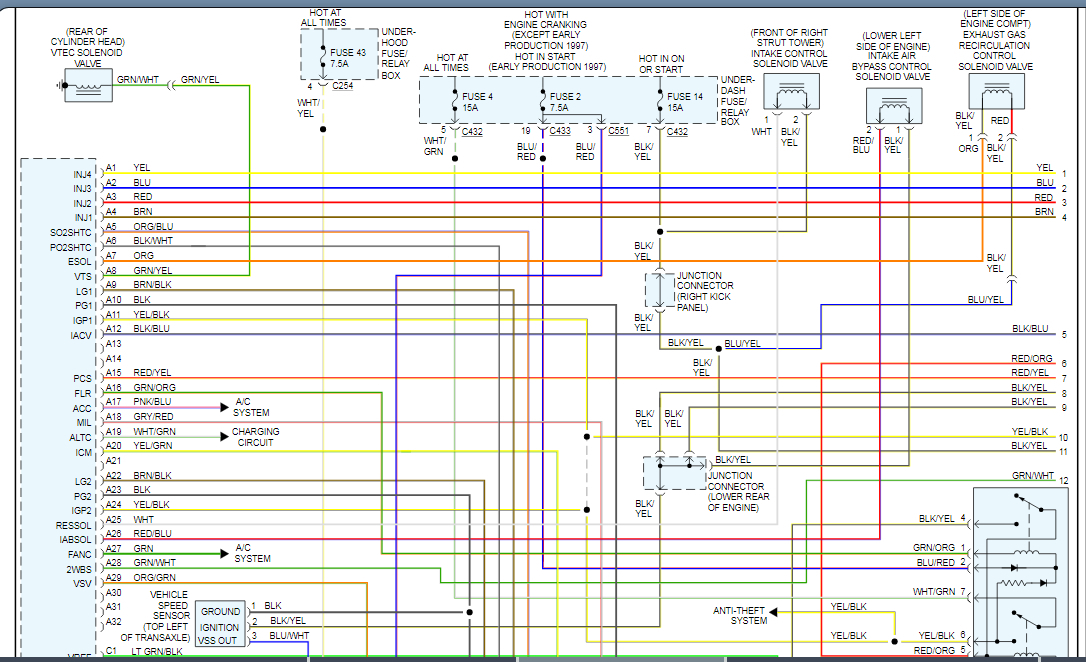

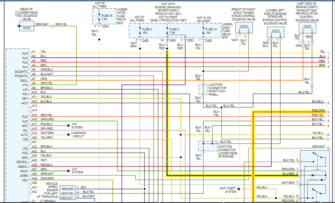

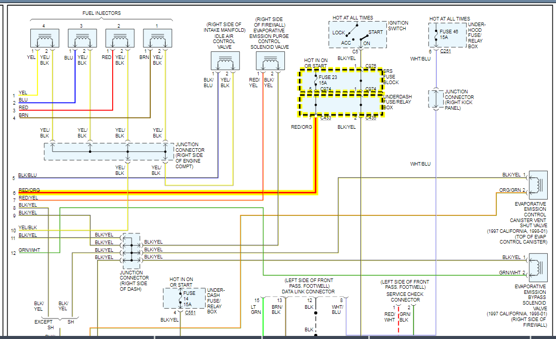

Okay, so let's see if battery voltage is making back to the fuel pump. In the diagrams down below I have included the Engine Performance Wiring Diagrams for your vehicle. I have highlighted the pertinent wires for you. I have also included the instructions for the removal and installation of the fuel pump for your vehicle as well. With a helper turning the ignition key to the "run" position, please take a voltage reading for us at pin 2 of the fuel pump electrical connector. You will need to use a Digital Multi-meter[DMM] to do this, so here is a link describing how to use one below.
Please go through these guides, take the reading, and get back to us with what you find out. This will let us know if the fuel pump is bad or we need to inspect the wires for the problem.

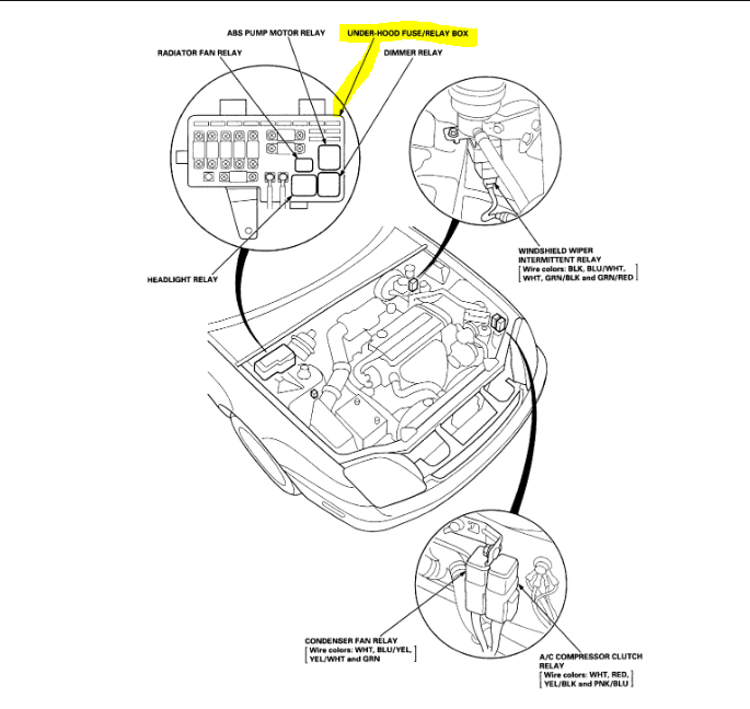

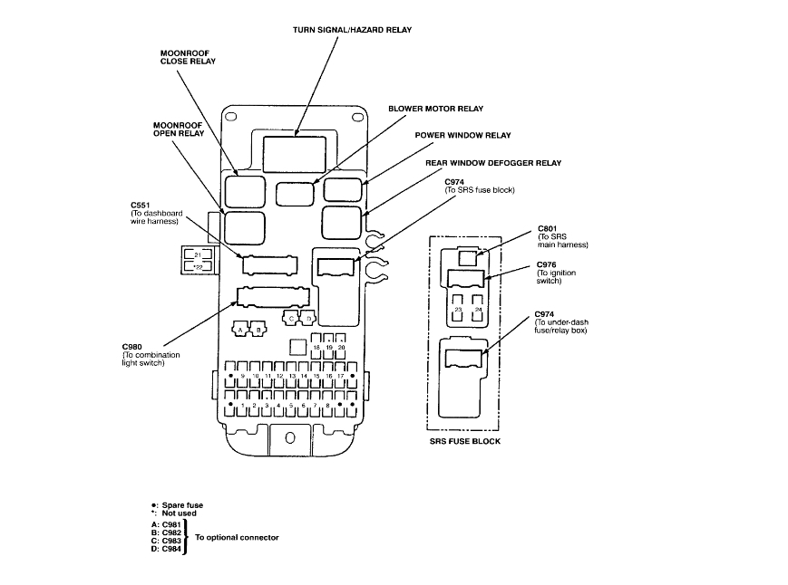

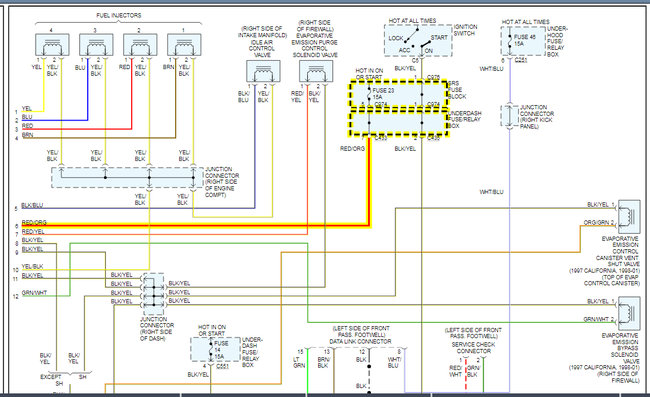

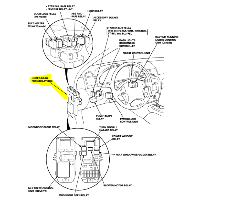

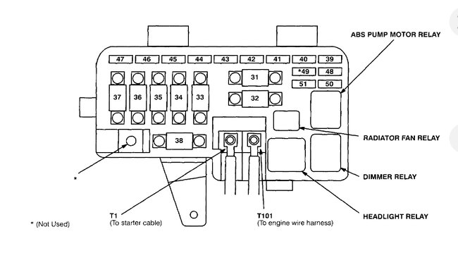

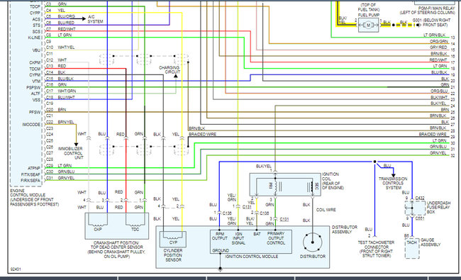

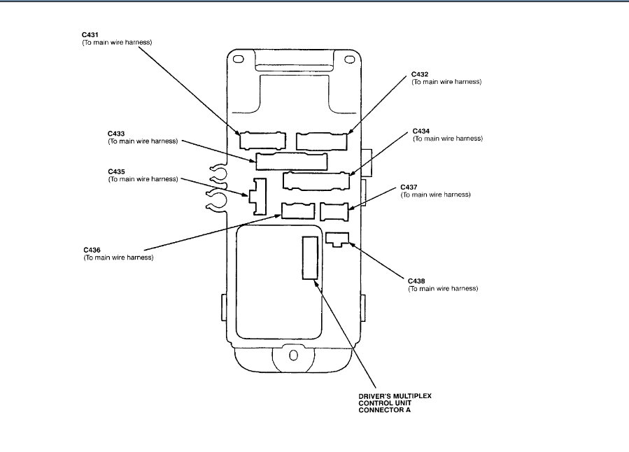

Hello again,
Well, you are in luck so to speak because when I was going to school to learn how to twist wrenches, I went to Butte Community College and took the Honda PACT program, so Honda was who gave me my training. Having said that, the term "PGMFI" is a Honda Acronym which stands for Programmed Fuel Injection. The fuel injectors, and in fact, any, component that is controlled electrically by the Power-train Control Module[PCM] or "computer" is controlled by the PCM providing ground or taking ground away from the electrical circuit that services that component. This would also include all of the fuel injectors. For right now though, can I get you guys to check Fuse 46 in the Under hood Fuse Box and Fuse 14 of the Under dash Fuse Panel for us. In the diagrams down below I have included the location, layout, and callout for the fuse box/panel in your vehicle. I have also highlighted the two fuses that need to checked for you as well. Here is a link below on how to check a fuse, if needed:

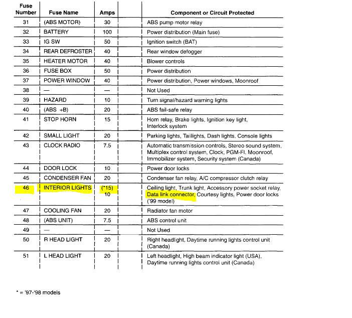

https://www.2carpros.com/articles/how-a-car-fuse-works
Please go through these guides and get back to us with what you find out.

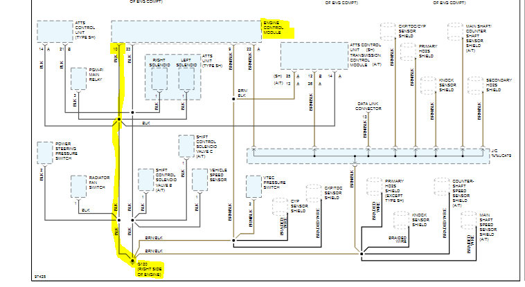

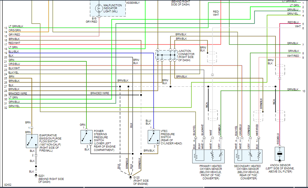

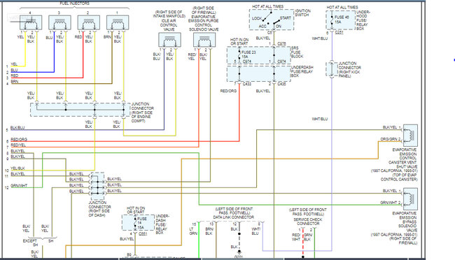

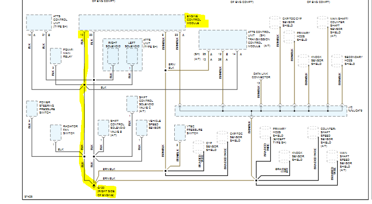

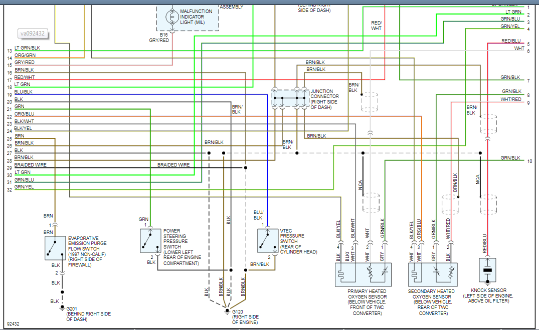

Okay, so no voltage at ECM pins A11 or A24 with black probe on pin A10 of ECM connector. I need you guys to check ground 120 on the right side of the engine. In the diagrams down below I have included the Power-train Management wiring diagrams as well as a guide on how to check grounds for you. Please go through these guides and get back to us with what you find out.

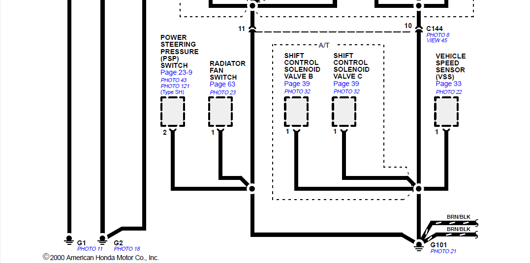

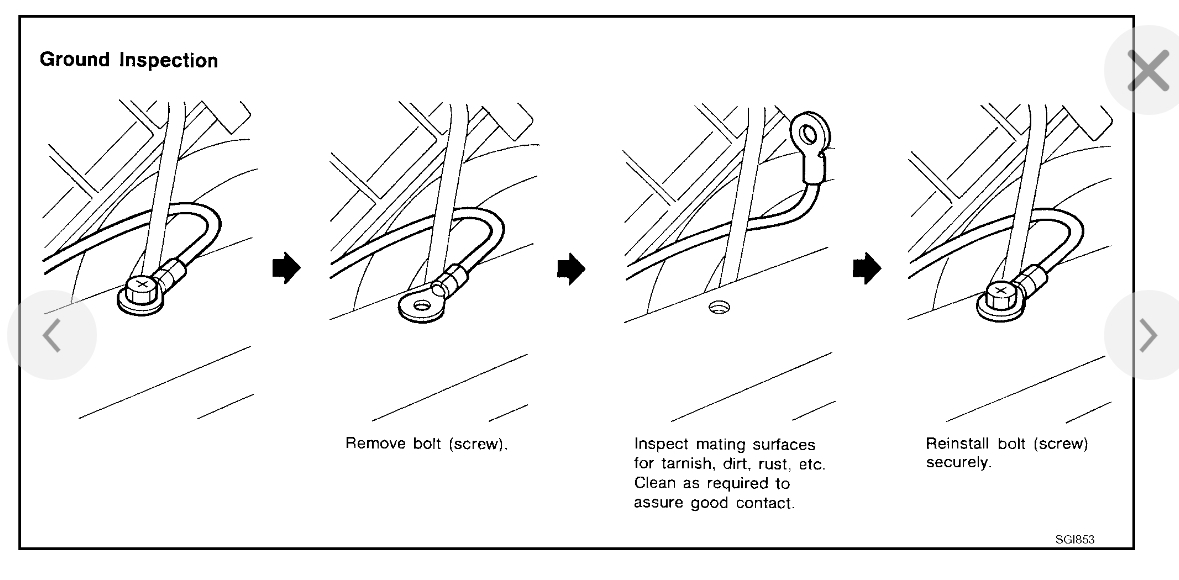

It seems to us that ground 120 is the same as G101, perhaps we're reading this incorrectly?
This was mentioned earlier in my posts, as it was quite oil soaked I'm sure from rushed oil top ups over time. This is what I stated in my original post:
"• Checked the grounds - G101 was actually soaked in oil, I'm assuming from rushed oil top ups as she burns oil like pretty much any Honda does, and spills down onto the thermostat housing where this ground sits. Hubs cleaned the ground, however did not sand the housing where the ground would be bolted back on, which I think is a rather silly thing to ignore but, whatever."
He's out there now to recheck it, remove it and take a wire brush to the site to ensure it's clean and would have a good connection. He's good with that side of wiring, so if he tells me it's good, I believe it's good.
If the ground is fine, where do we go from here? :(
Nov 5, 2019 at 3:48 PM
SCGRANTURISMO
  • 4,897 POSTS
Ground 101 is not the same as Ground 120. If you follow the black wire from pin A10 of the ECM connector in the diagrams I sent earlier, it leads to Ground 120. I have also included a partial Ground Distribution Wiring Diagrams in the diagrams down below. They show what components are grounded to Grounds 101 and 120. Please check Ground 120 on the right side of the engine, and get back to us with what you find out. We can go from there if needed.
