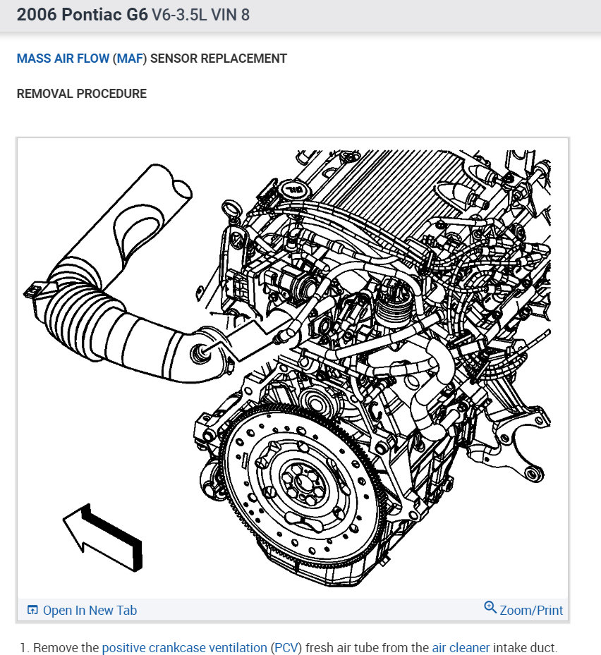

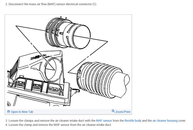

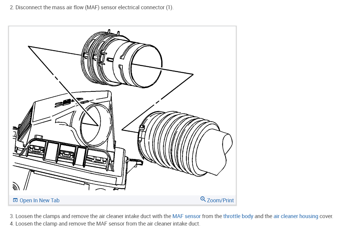

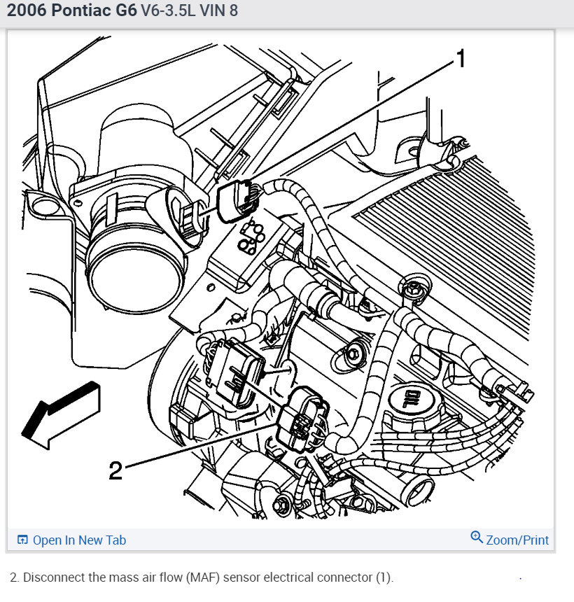

It sounds like you have more than one problem. We will handle the misfire issue on this post please make a new question for the ABS problem. The misfire issue sounds like the MAF or fuel pump need to be replaced. Here are two guides to help us see whats going on:
and
https://www.2carpros.com/articles/how-to-replace-a-mass-air-flow-sensor-maf
