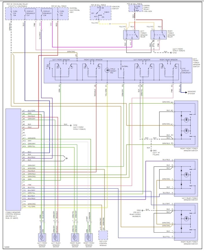

They both work intermittently, and only right after the car is turned on, and only for a minute. Then they stop. If I turn the car off and let it sit for a little bit, they sometimes start working again (and sometimes not).
Not the switch as one switch does not control both, but they are on the same relay. But a relay I would think would just fail or not. What is the missing link?

It soudns like the window control module is going out, here is a wiring diagram that shows it control both the windows and the sunroof. Let me know hat happens so it will help others
