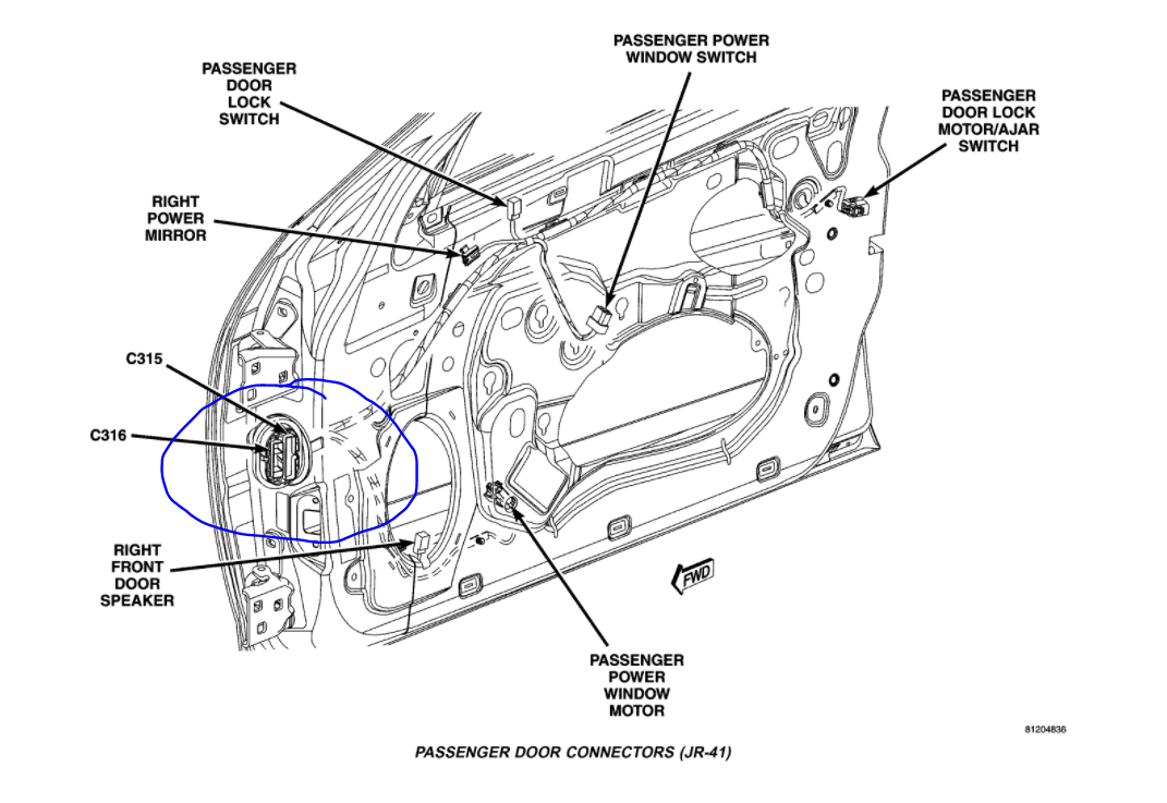

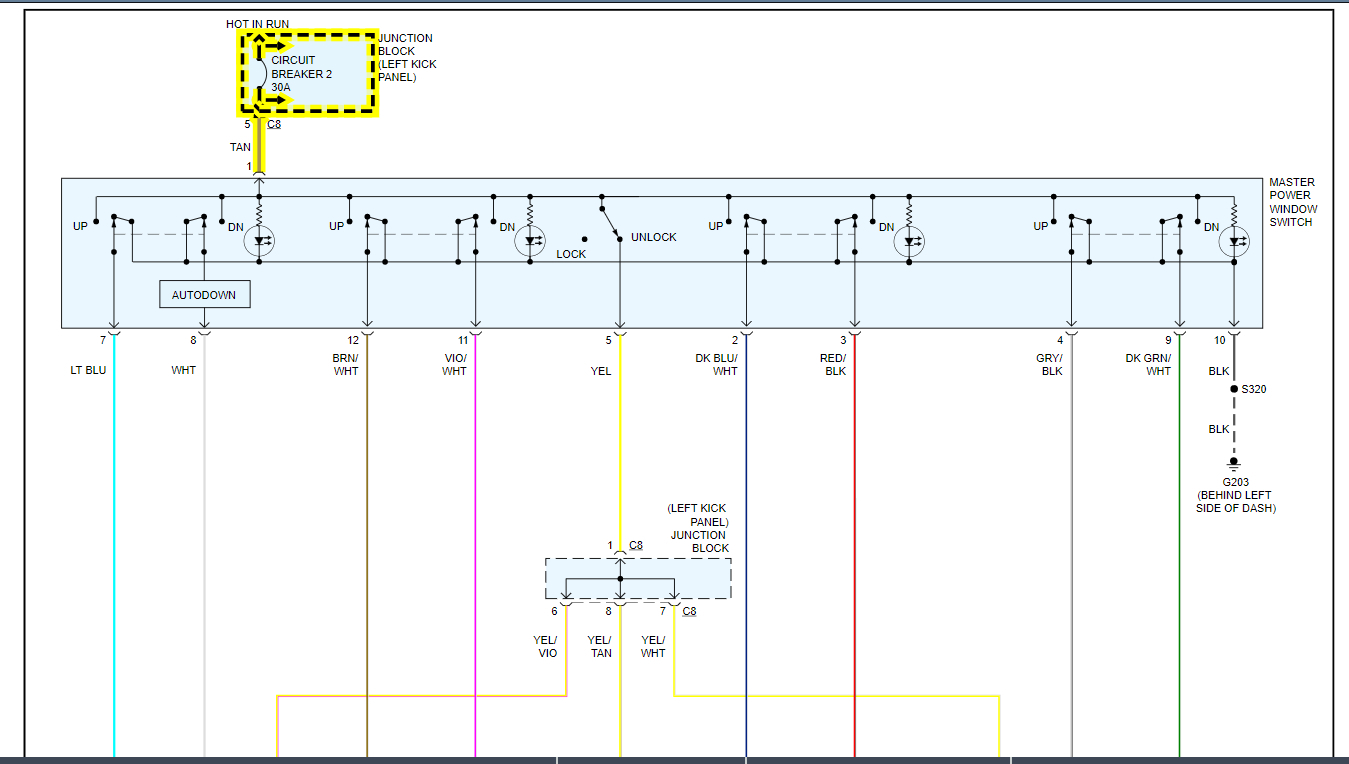

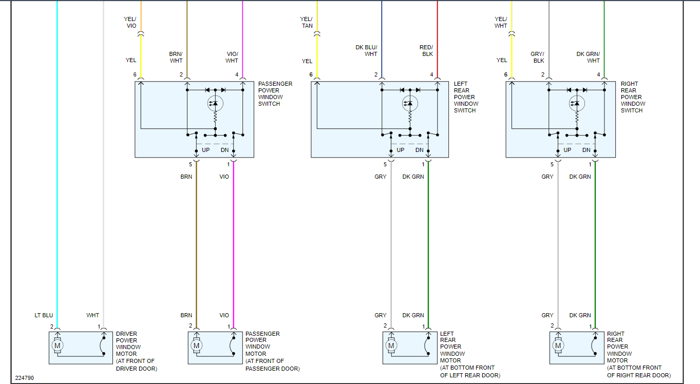

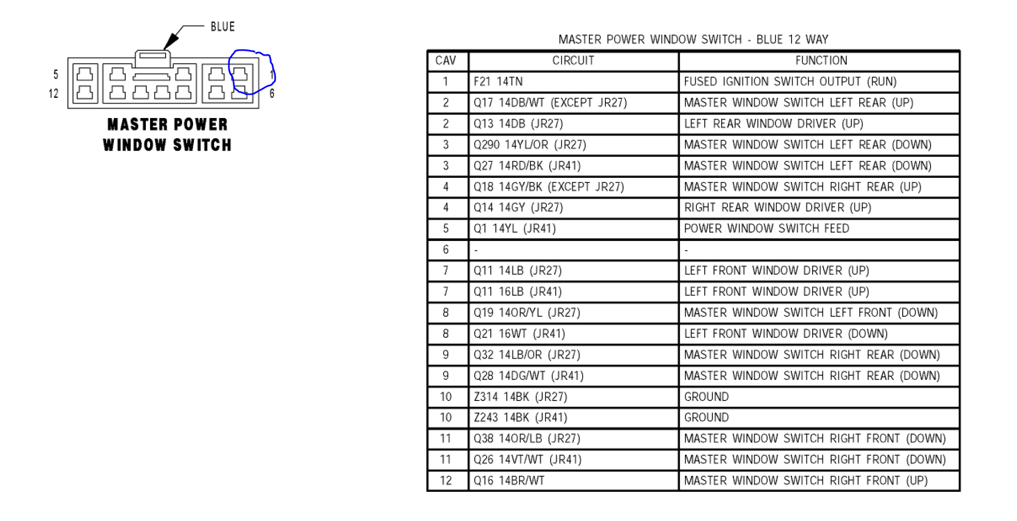

I've changed the fuses in the power window circuits both under the hood and the interior fuse panel, but none of the windows or door lock switches will work still. Is there another fuse somewhere else in that circuit? Or if the driver door window motor burned up would that cut power to all of the other window motors?
