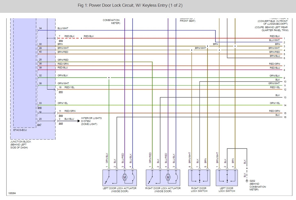

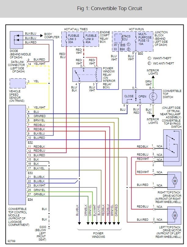

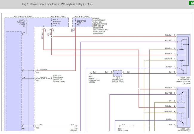

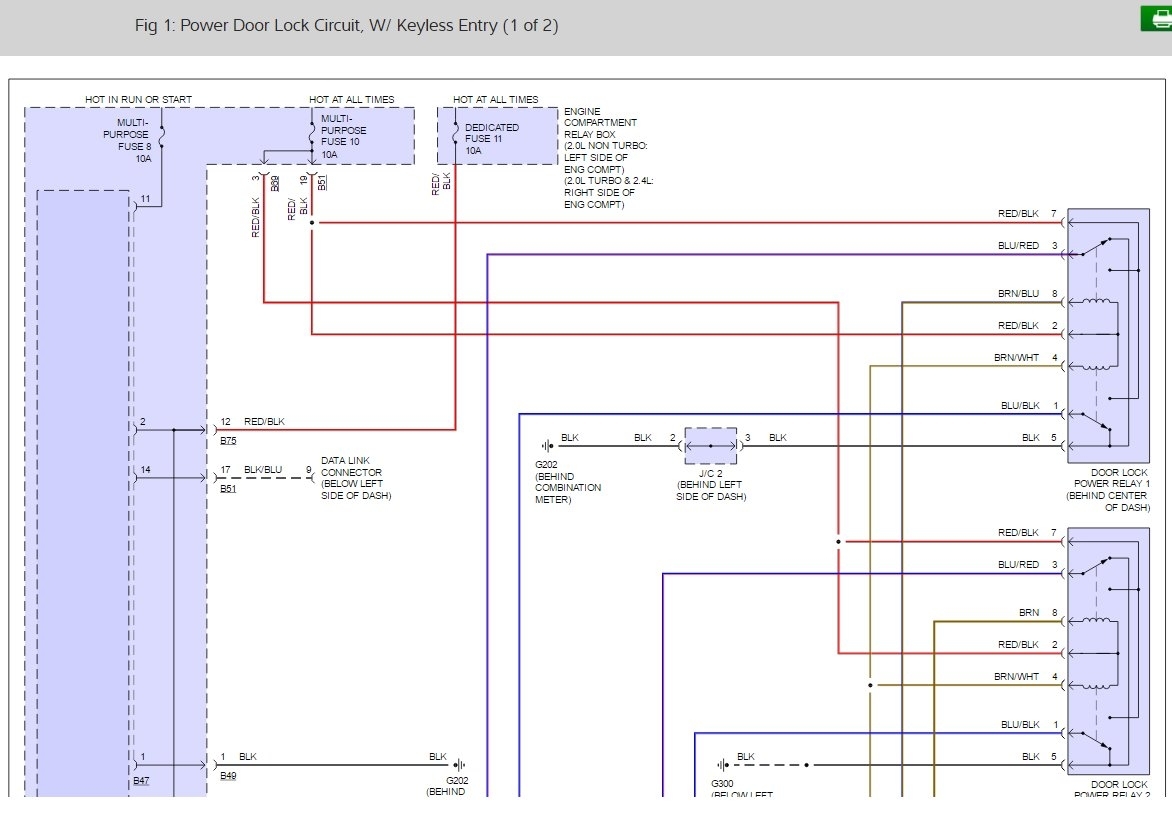

The power locks and windows are not working, blower does not work and the top for the convertible is not working. I installed a new battery but it drained over night. The lights work. what could it be?
Apr 12, 2017 at 2:29 PM
There must be a main fuse or fusible link out, here are some wiring diagrams and a guide to help you get the problem fixed.
https://www.2carpros.com/articles/car-battery-dead-overnight
and
Please run some tests and get back to us so we can continue helping you.
