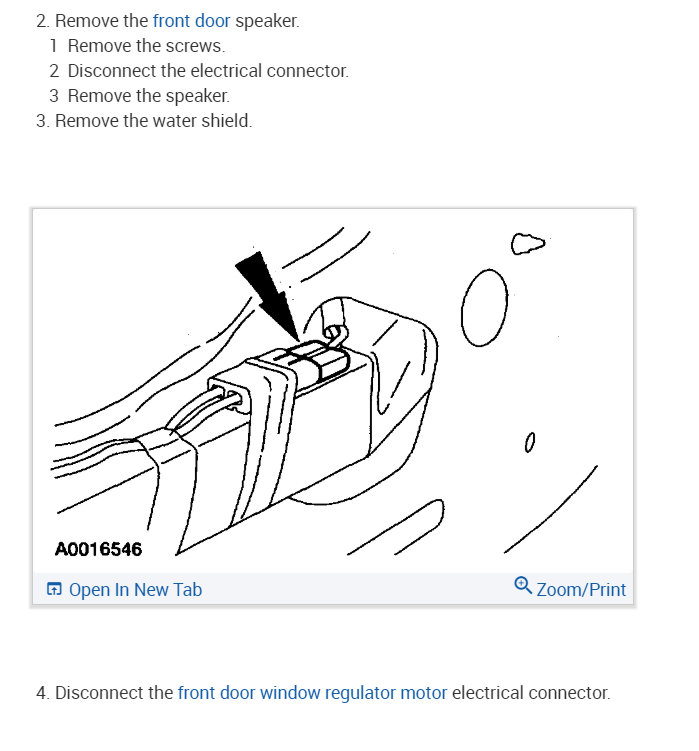

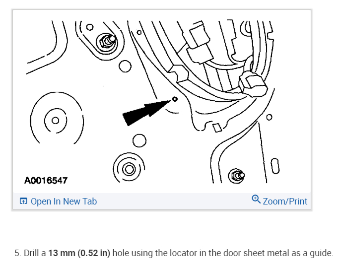

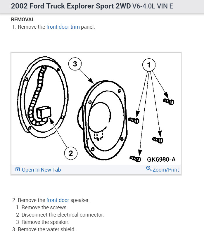

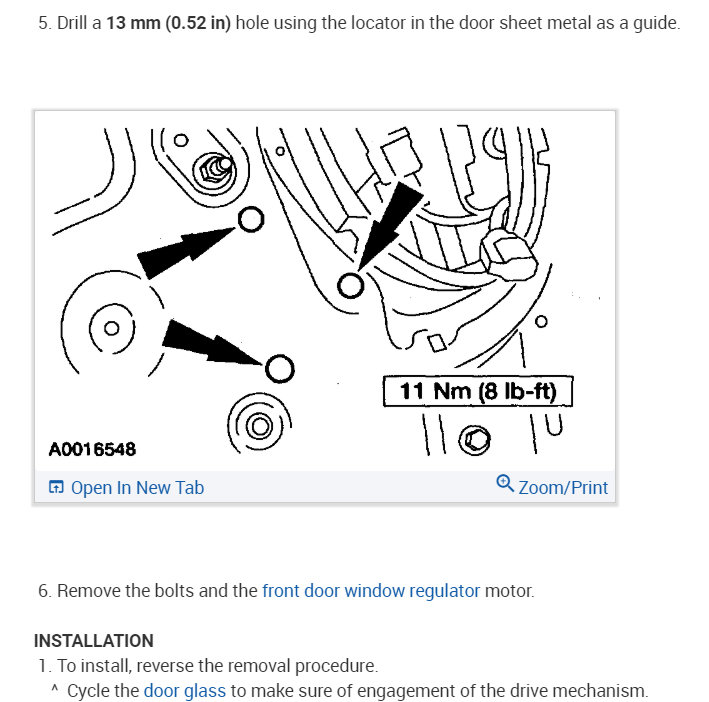

It sounds like the window motor went out because the system runs off one fuse. but to be sure here is a guide to walk you through the tests with diagrams below to show you how to replace the window motor/regulator:
https://www.2carpros.com/articles/electric-window-repair
This guide walks you through the steps on a similar car check the diagrams below for yours:
https://www.2carpros.com/articles/how-to-check-and-replace-a-electric-power-window-motor
You can get the part from Amazon or Rockauto. Check out the diagrams (below). Please let us know if you need anything else to get the problem fixed.
