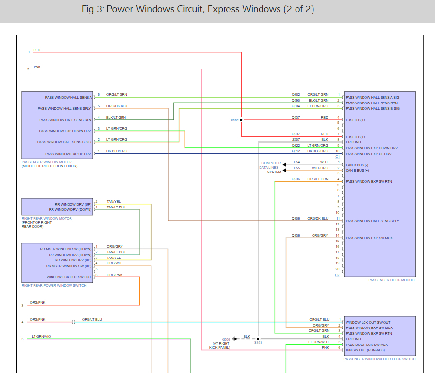

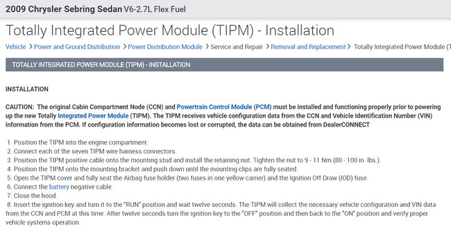

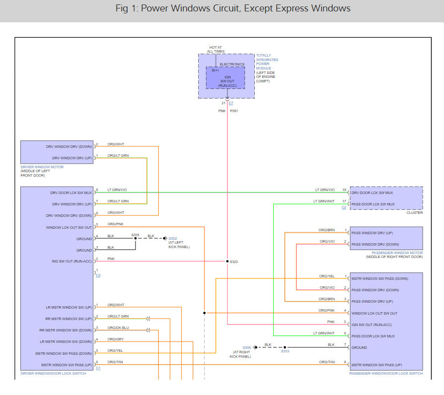

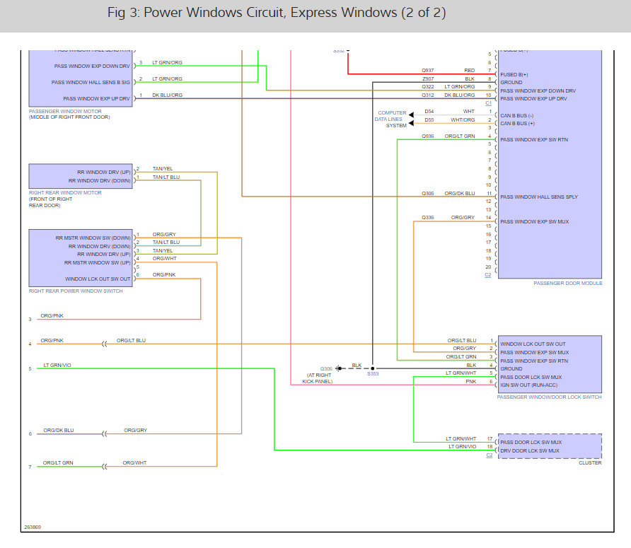

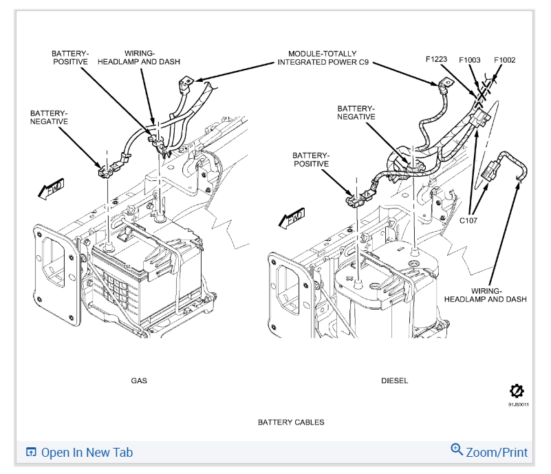

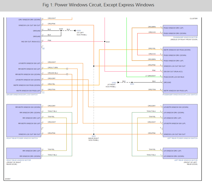

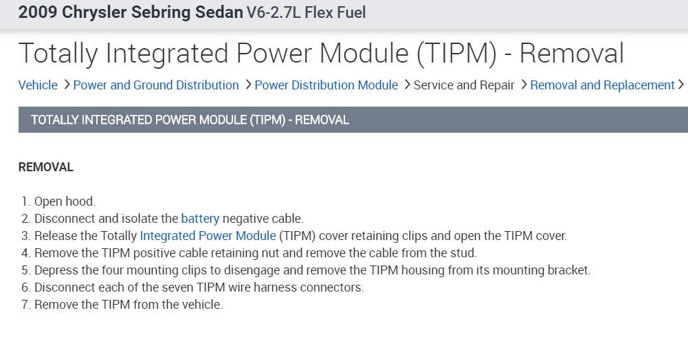

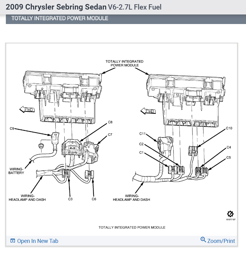

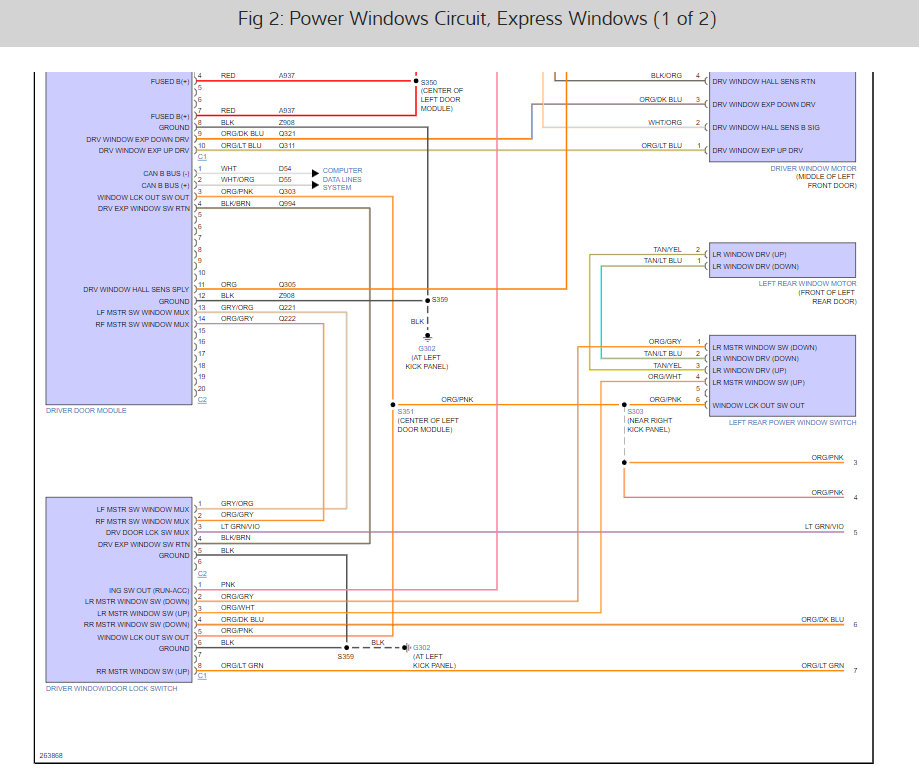

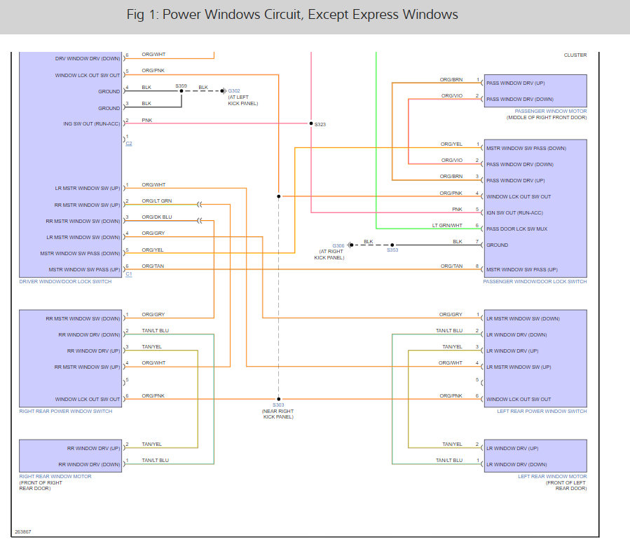

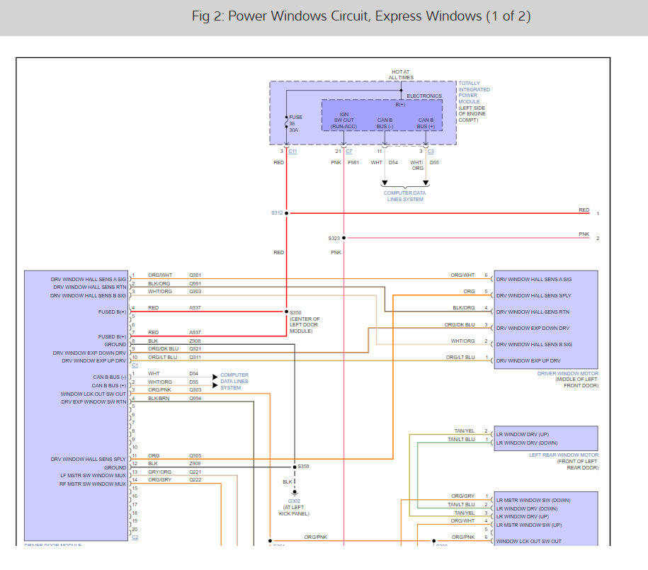

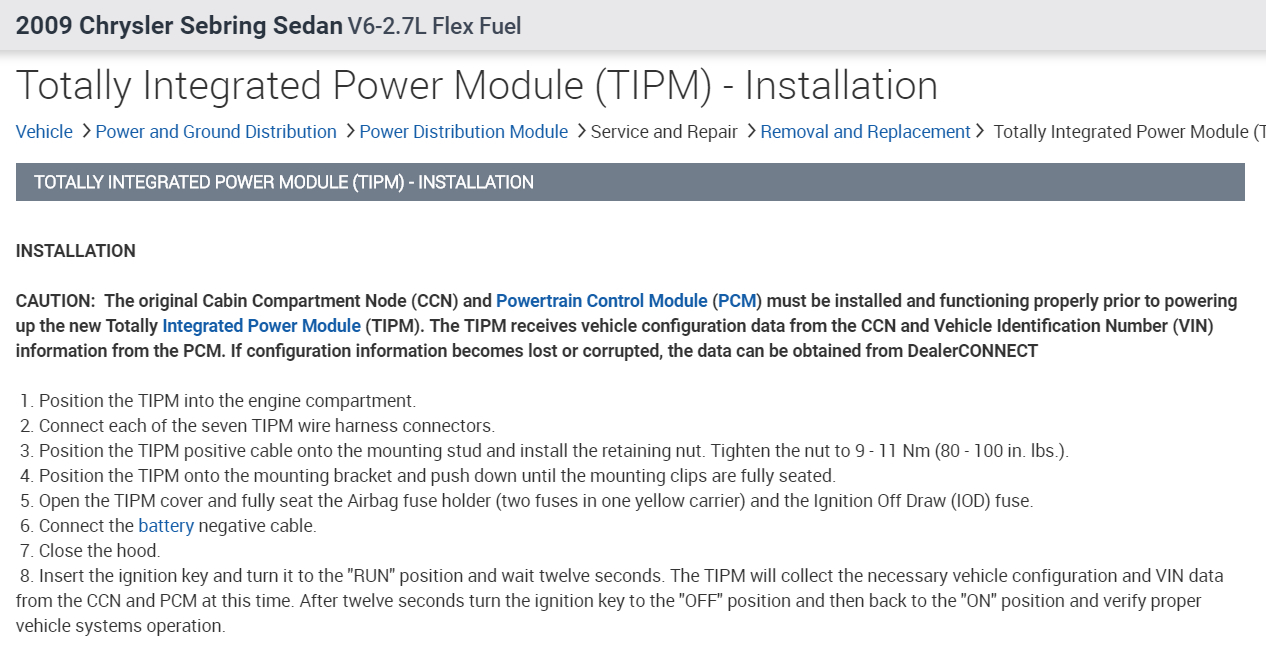

This sounds like it could be the switch, driver's door module or the TIPM, but to me the driver's door module or TIPM is the most likely failure, to be sure you will need to check for power at each of these which means removing the door panels on both drivers and passengers' side to check for power. If the pink wire going to the driver's door switch does not have power, it will be the TIPM which I have giving instructions to change in the diagrams below along with the window wiring diagrams. To streamline this repair, you should do a CAN scan which is easy if you follow this guide and video:
https://www.2carpros.com/articles/can-scan-controller-area-network-easy
This guide can show you how to test for power at the switches and modules. If not, power is present, follow the window wiring diagrams to see where the power comes from and replace that part.
Please don't be afraid of wiring diagrams, it is just like reading a road map (back in the day) and the TIPM self learns so there is no programming required. Check out the diagrams (below). Let us know what happens and please upload pictures or videos of the problem.
