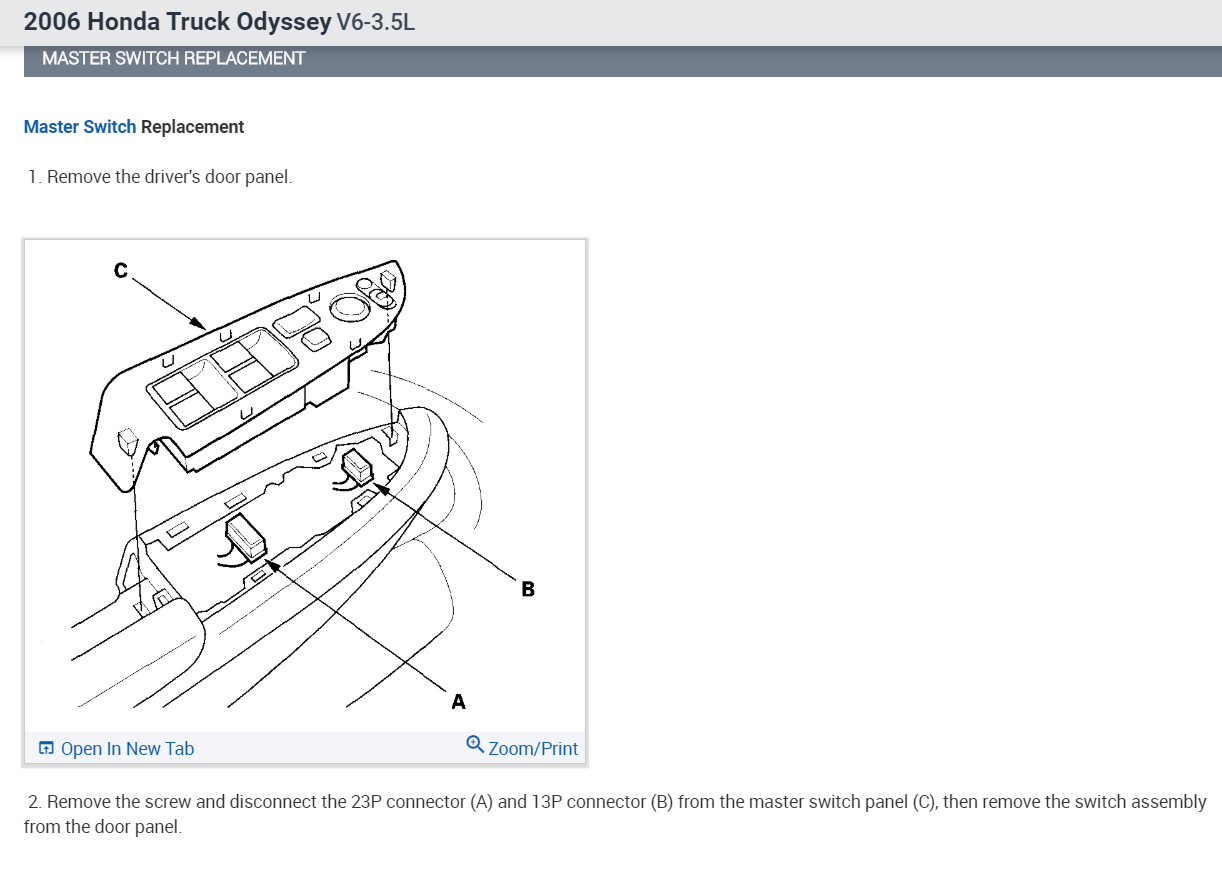

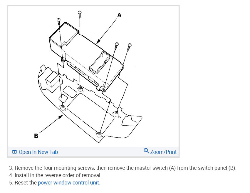

It does sound like the main switch is out because there is a processor that does not like to get wet inside the switch. here is how you replace it. Check out the diagrams (below)? Please let us know what happens.

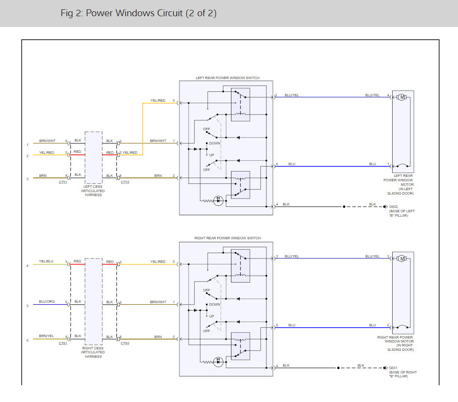

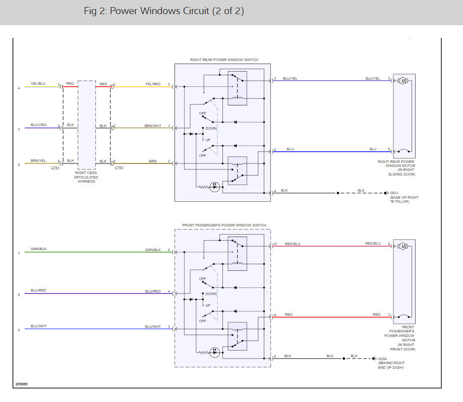

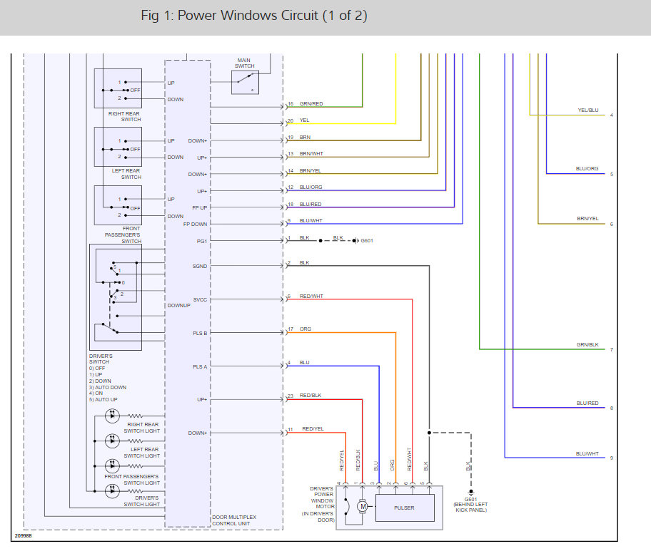

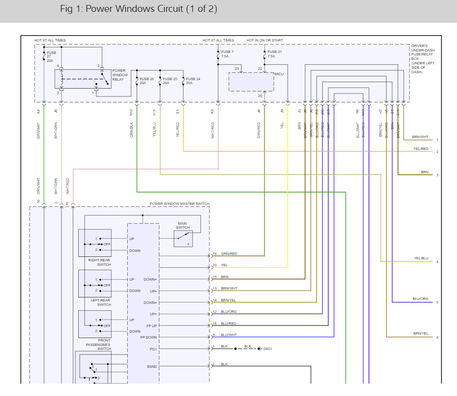

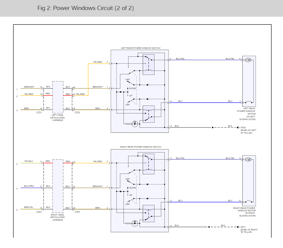

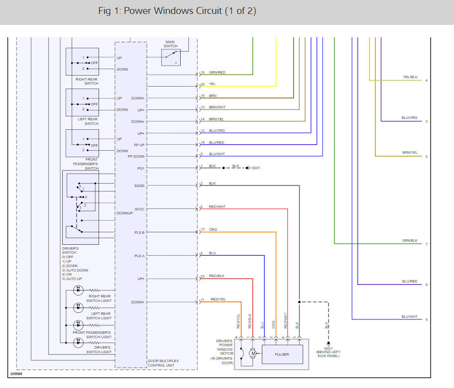

You can test the power and ground with the window control output by using this guide and the window wiring diagrams below so you can see how the system works:
