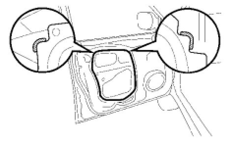

1. REMOVE FRONT DOOR LOWER FRAME BRACKET GARNISH LH
pic 1
(a)Using a screwdriver, remove the lower frame bracket garnish.
HINT: Tape the screwdriver tip before use.

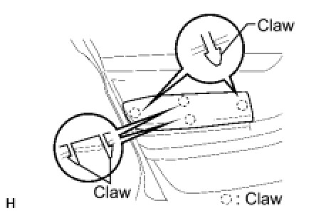

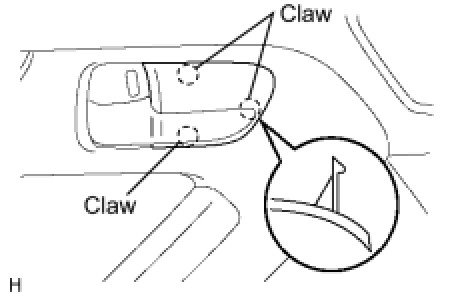

2. REMOVE FRONT DOOR INSIDE HANDLE BEZEL LH
pic 2
(a)Using a screwdriver, disengage the 3 claws, and remove the inside handle bezel.

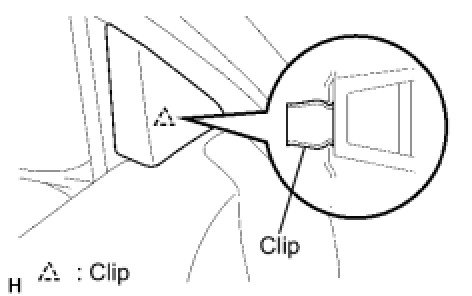

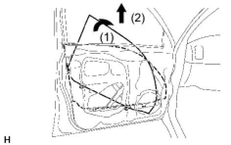

3. REMOVE FRONT ARMREST ASSEMBLY LH
pic 3
(a)Disengage the claws, and remove the armrest from the trim board.

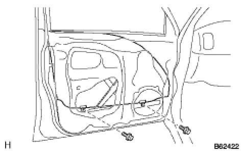

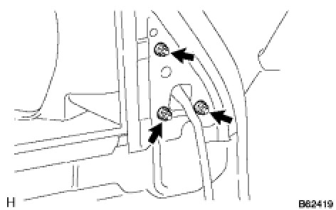

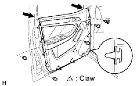

4. REMOVE FRONT DOOR TRIM BOARD SUB-ASSEMBLY LH
pic 4
(a)Remove the 2 cushion rubbers.
(b)Remove the 2 screws and clips.
(c)Using a clip remover, remove the 11 clips.
(d)Remove the trim board upward.
HINT: In order to prevent the door from being damaged, cover the parts indicated by arrow marks in the illustration with tape.

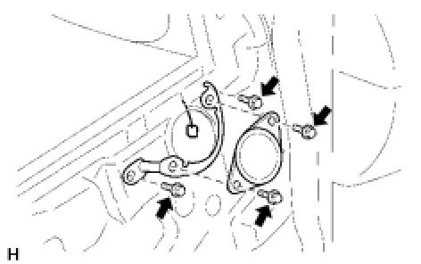

pic 5

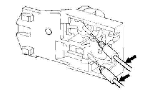

(e)Disconnect the 2 cables from the inside handle as shown in the illustration.
(f)Remove the inner weatherstrip.
(g)Remove the 3 screws and power window master switch.

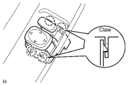

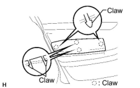

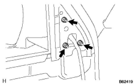

pic 6
(h)Using a screwdriver, disengage the 4 claws.
(i)Remove the power mirror switch, as shown in the illustration.

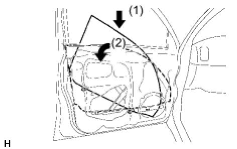

5. REMOVE FRONT DOOR SERVICE HOLE COVER LH
pic 7
(a)Remove the front door service hole cover LH.
NOTE: Remove the remaining tape on the door side.

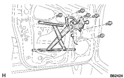

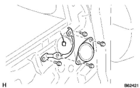

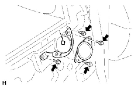

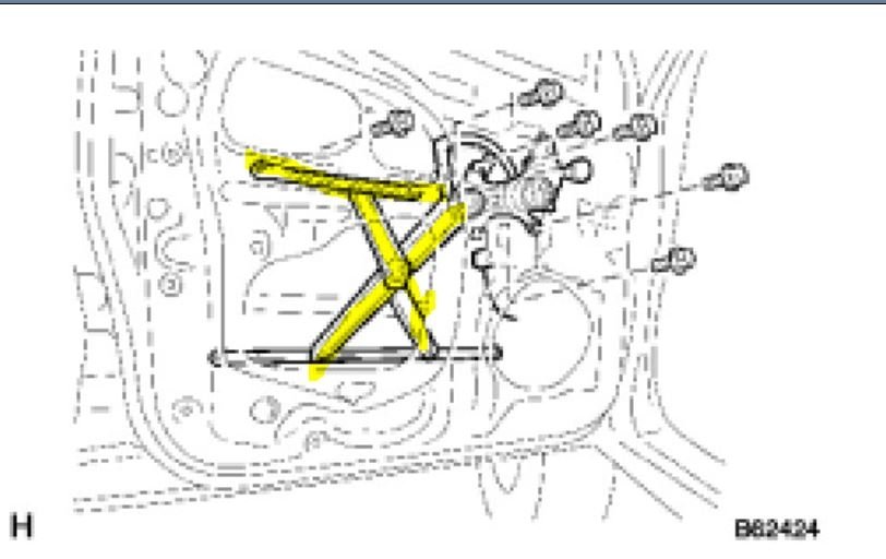

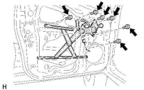

12. REMOVE FRONT DOOR WINDOW REGULATOR SUB-ASSEMBLY LH
pic 12
(a)Disconnect the window regulator connector.
(b)Remove the 6 bolts and window regulator.
NOTE: When the bolts are removed, the window regulator might drop and be deformed.
HINT: Remove the window regulator through the service hole.

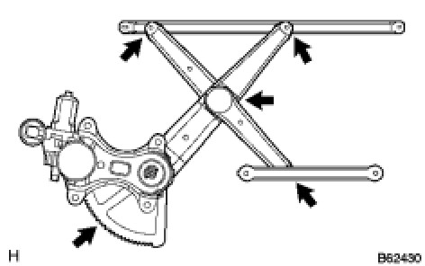

8. INSTALL FRONT DOOR WINDOW REGULATOR SUB-ASSEMBLY LH
pic 13
(a)Apply MP grease to the sliding and rotating parts of the window regulator.
NOTE: Do not apply grease to the spring of the window regulator.
pic 14
(b)Install the window regulator with the 6 bolts.
Torque: 8.0 Nm (82 kgf-cm, 71 in-lbf)
(c)Connect the window regulator connector.
NOTE: Be careful not drop and deform the door window regulator.

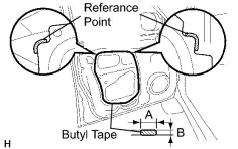

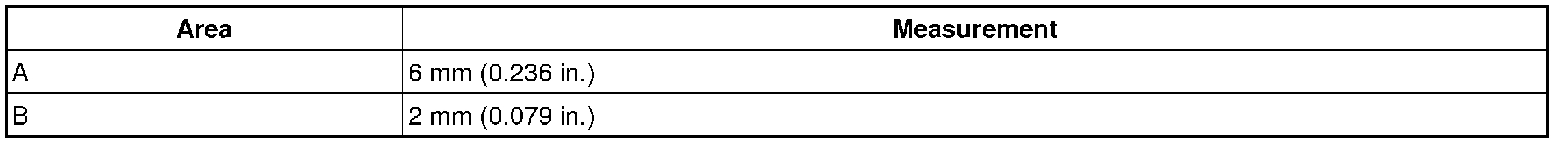

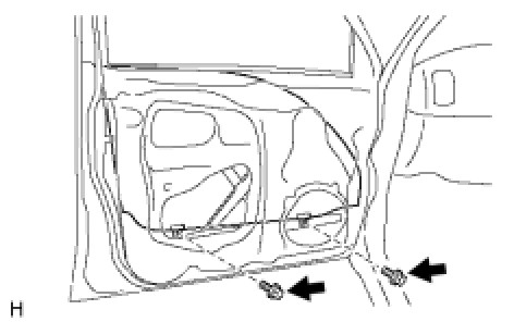

12. INSTALL FRONT DOOR SERVICE HOLE COVER LH
pic 19
(a)Apply butyl tape to the door, as shown in the illustration.
Adhesive:
Part No. 08850-00065, Butyl Tape Set or equivalent
(b)Install the service hole cover.
Standard dimension:
