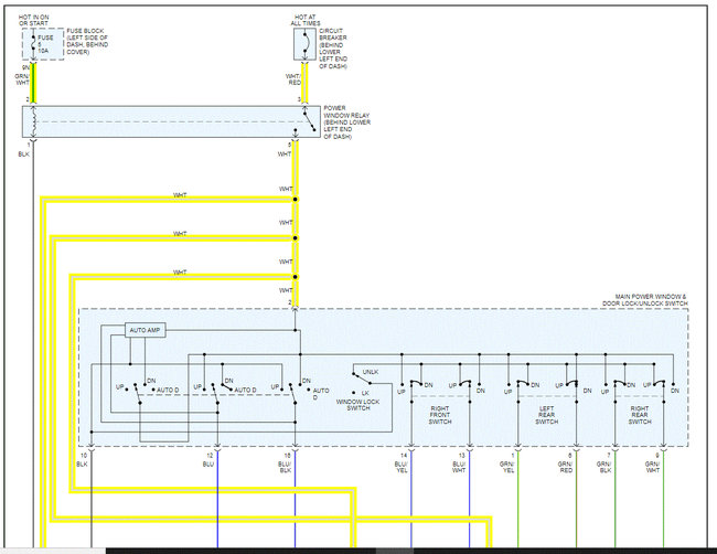

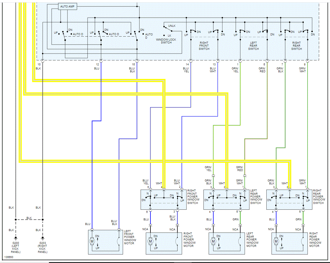

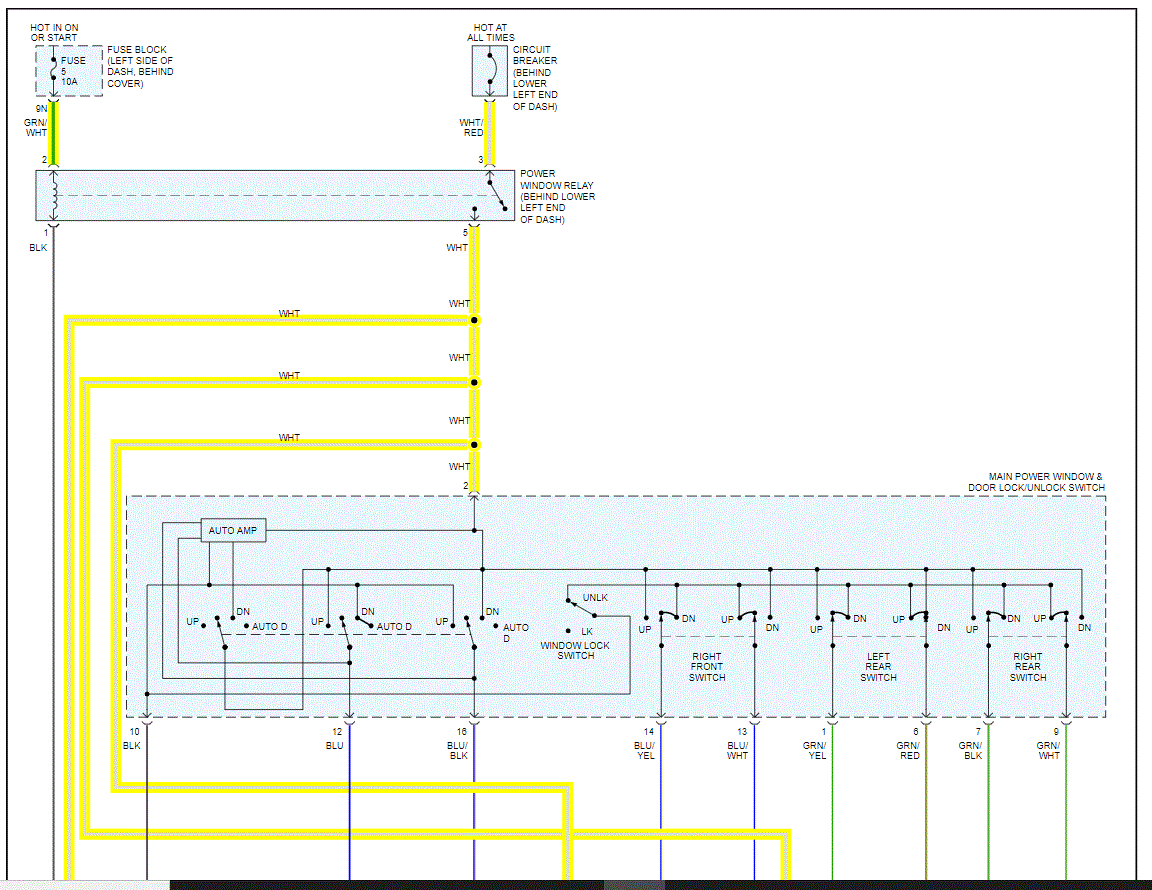

I attached the entire wiring schematic below for you to review. At the window switch, there should be a white wire. Check that for power. It comes from the window relay. Also, note that power is from a circuit breaker.
The actual wiring schematic is one page long. I had to cut it in half to make it readable for you. I did overlap the two so you can follow from one to the next.
See pics below.

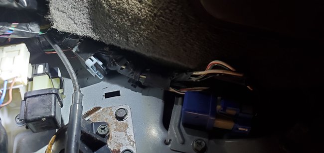

Need to know which one of these is the circuit breaker to the power widows. I see two of them here; a black, and a blue. That's the hood latch in between the two. Do you know which is for power windows?
Sep 27, 2021 at 12:11 PM
SHAYNSHAWN
Also my photo is turned, so the black one is top, blue is bottom.

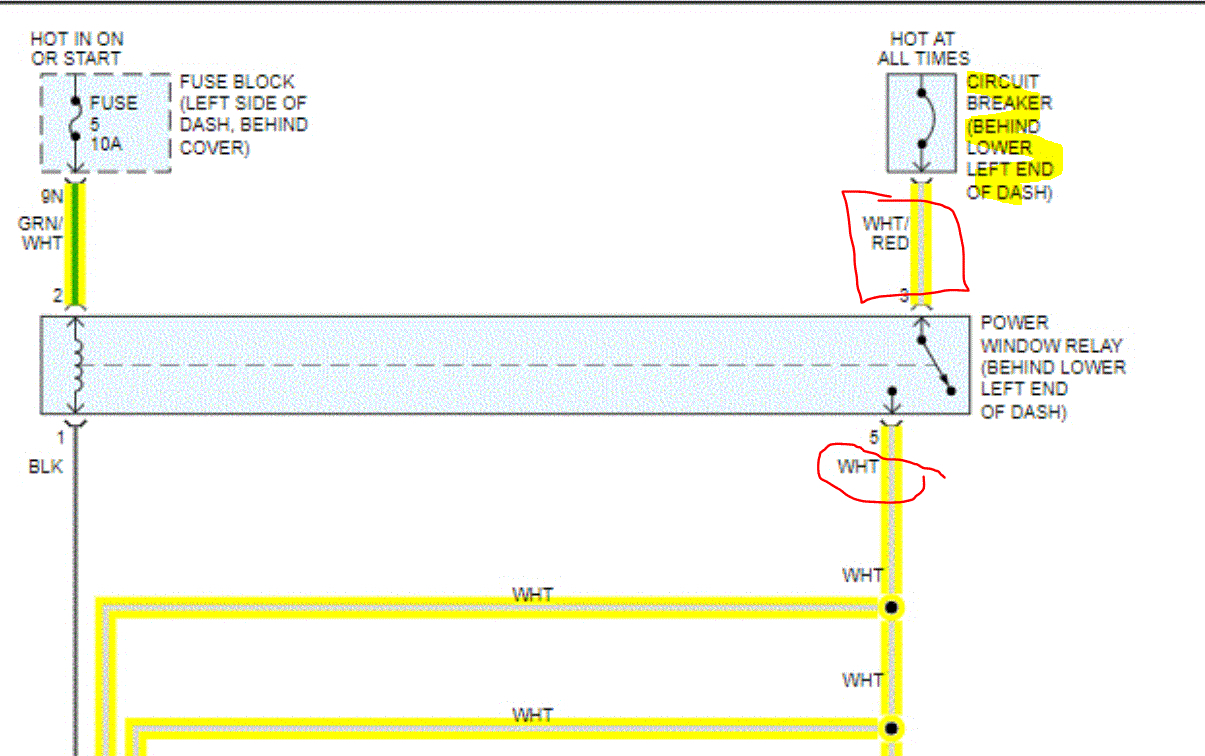

I just looked at the schematic again. Power from the circuit breaker is provided via a white wire with a red tracer to the power window relay. From there, it is a white wire.
See attached.
