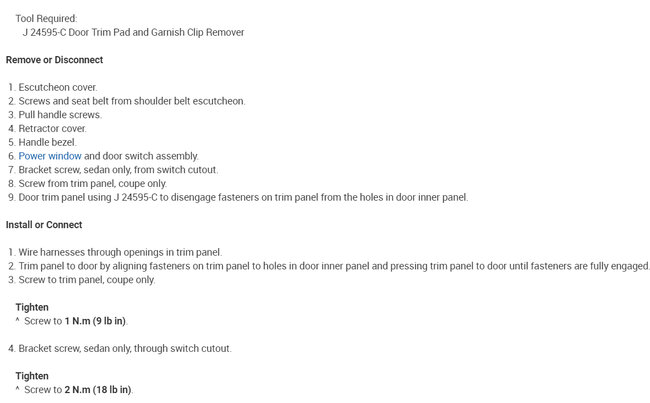

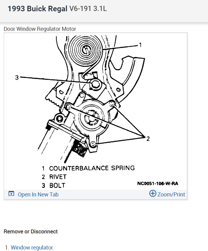

Sure here is how to change the window regular out.
Remove or Disconnect
1. Window regulator.
CAUTION: Step 2 must be performed once regulator is removed from door. The regulator lift arm is under tension from the counterbalance spring and can cause personal injury if the motor is removed without locking the sector gear in position.
2. Drill hole through regulator sector gear and backplate.
Important
^ Do not drill hole closer than 13 mm (1/2 inch) to edge of sector gear or backplate.
3. Install bolt and nut to lock sector gear in position.
4. Drill out ends of three rivets using 1/4 inch drill bit.
5. Motor and remaining portions of rivets.
Install or Connect
1. New motor to backplate.
2. Rivet to motor at bottom location using ball peen hammer.
3. Clamp motor to backplate using locking pliers.
4. Remove bolt and nut securing sector gear.
5. Supply power to regulator to gain access for remaining two motor rivets.
6. Two rivets.
7. Remove locking pliers.
8. Window regulator.

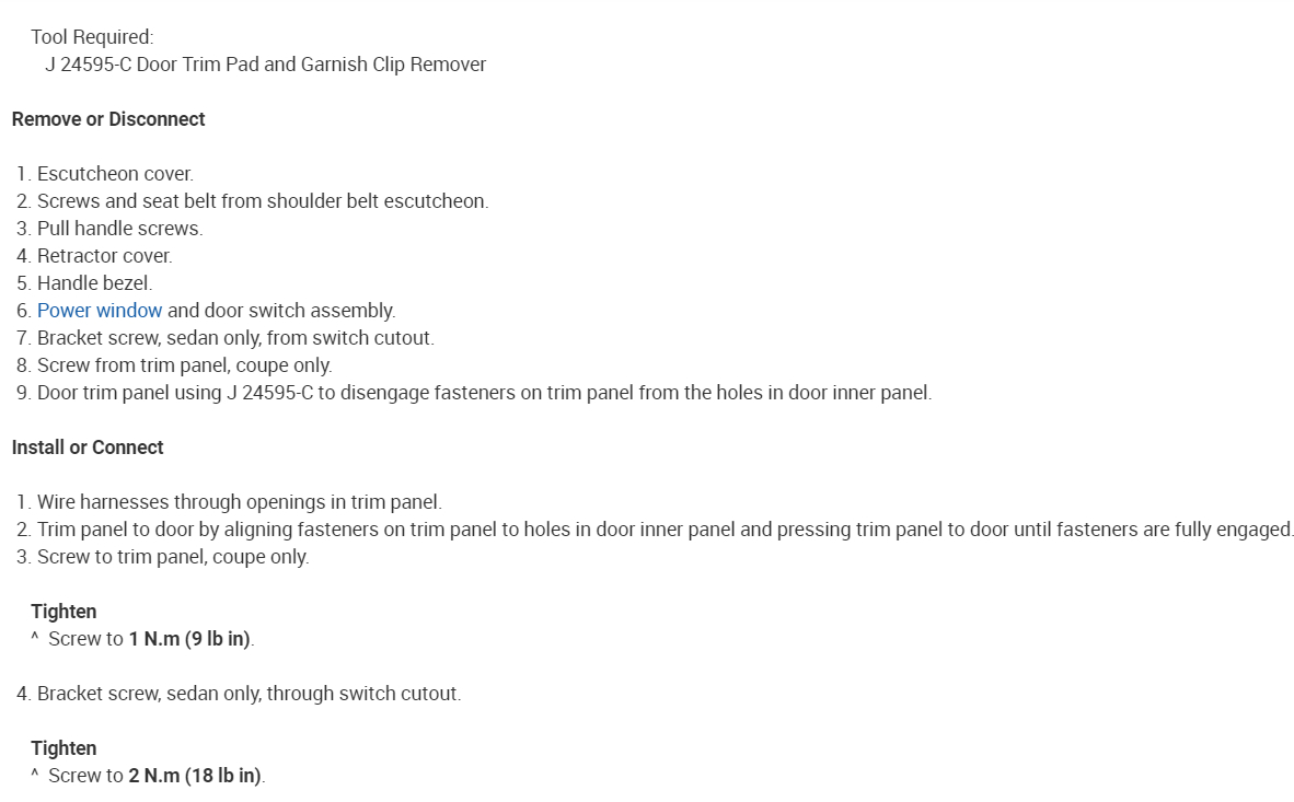

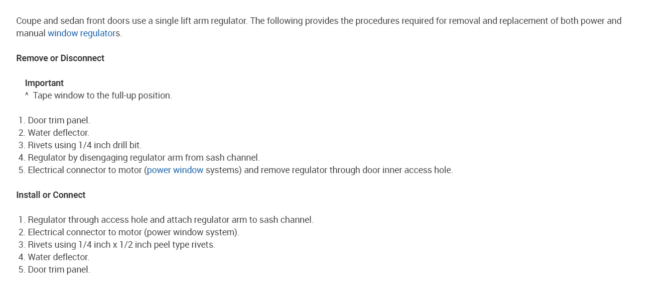

Check out the images below.
May 15, 2023 at 3:04 PM

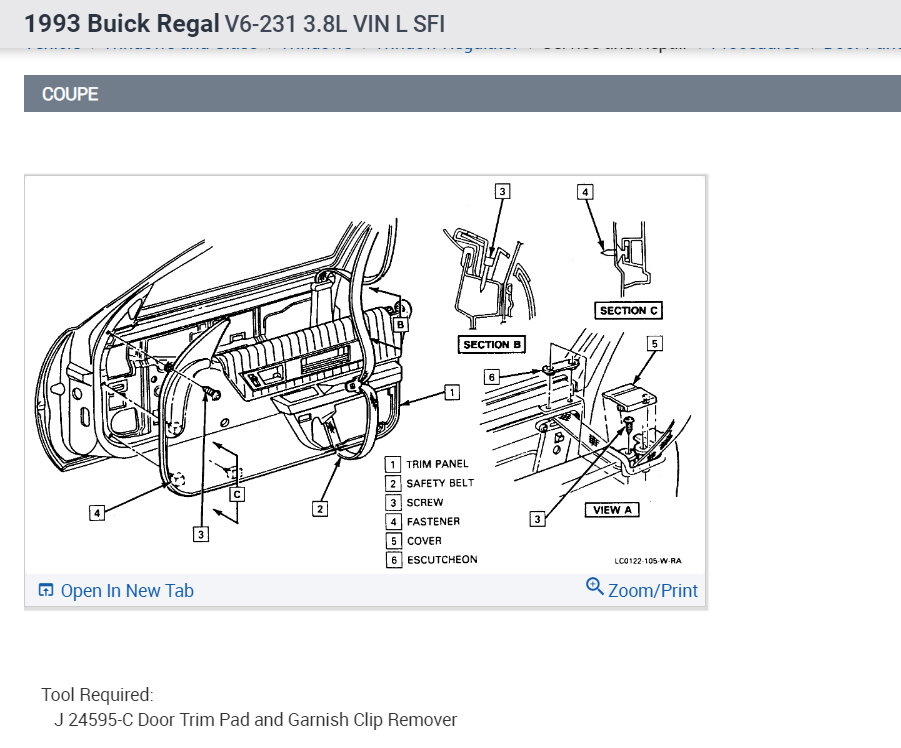

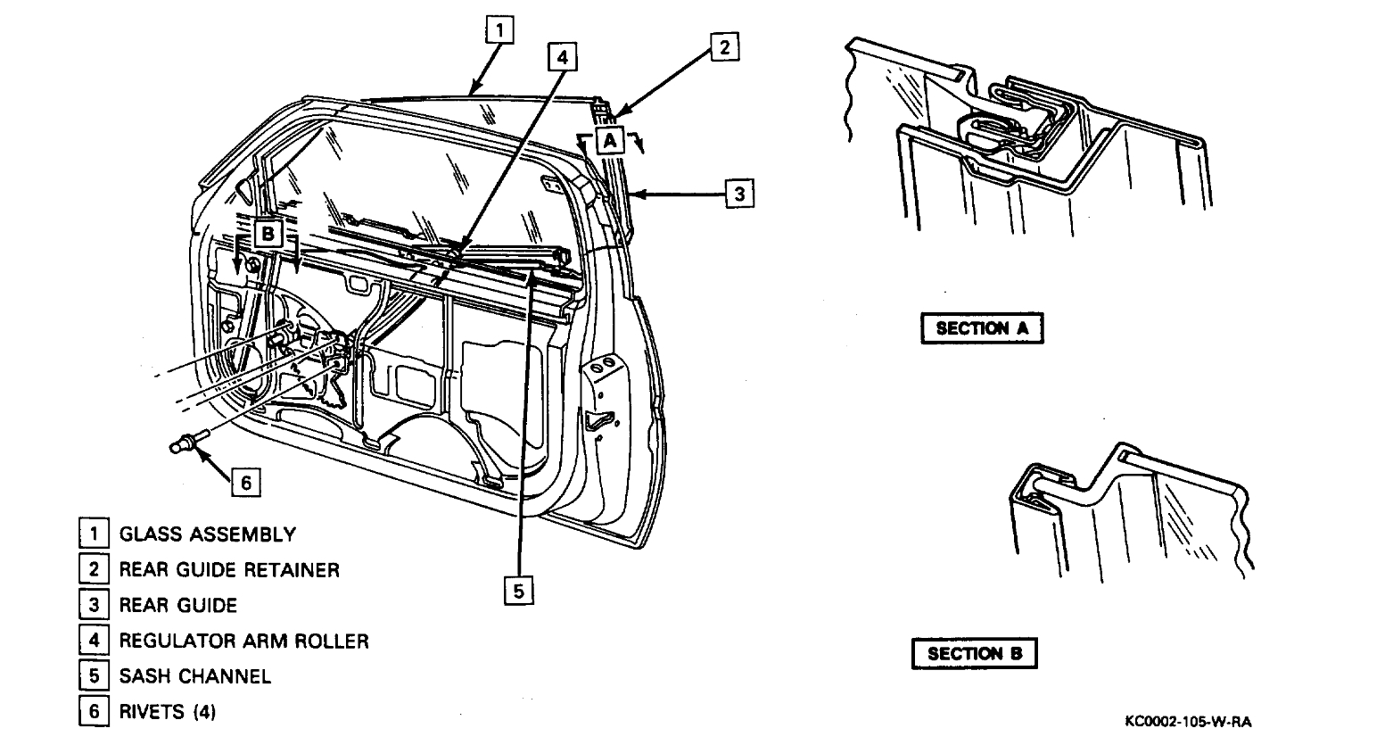

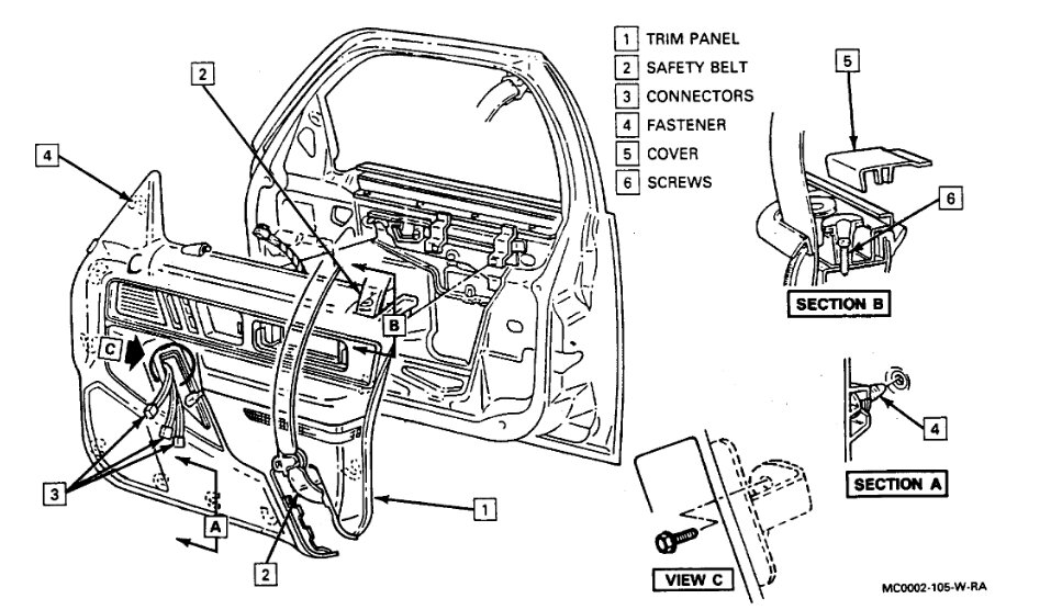

Is there somewhere online where I can see an exploded view of the window regulator and components? I know I'm going to have to fix it one way or another but there's not much room to work.
May 15, 2023 at 4:23 PM
Sure, here is what we have to do the job. Check out the images (below). Let us know what happens and please upload pictures or videos of the problem so we can see what's going on.

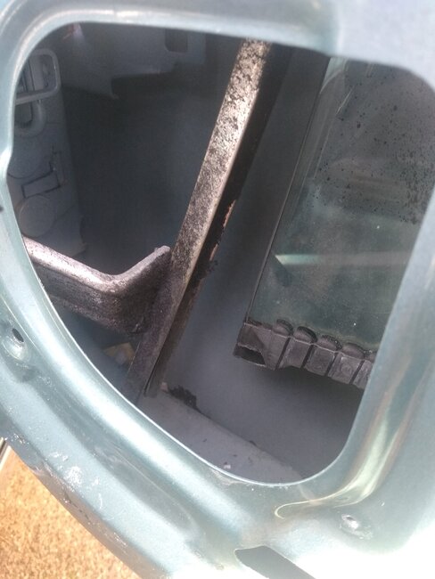

Can you tell me the part that goes here the clamps to the window? This is what's broken. The motors working fine the window is going up and down just sideways. Thanks
May 21, 2023 at 2:50 PM
It looks like the window rail mount has broken off. It should be down in the door so you can get a replacement at the auto part store.
May 22, 2023 at 11:14 AM

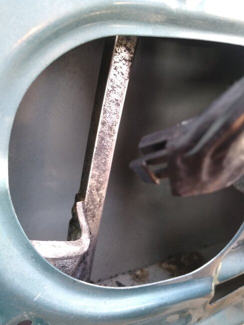

Not much felt left in the guide. Only two bolts hold on the lower window channel. The plastic piece looks like it's glued to the window on the bottom left. There is a small piece of it missing. The channel is adjusted over to the right as far as it can be.

That has to be frustrating. Have you tried glass repair shops? Also, I attached a pic below. Do you see the part you are needing?
See pic below.
May 31, 2023 at 8:32 PM
BW74
  • 50 POSTS
That window channel bar and that black plastic piece on the bottom left of the window is what I need.
Jun 1, 2023 at 5:59 AM
I see it. I feel the only place you will find one is a salvage yard. Here is a link that checks nationwide for salvage parts. You may want to try this.

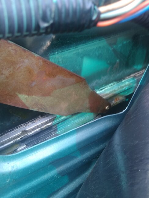

I actually found a guide on eBay but before I put it in the roller was in really bad shape on the regulator, so I put a new one of them in and now even before putting the window channel and guide back in it only rolls up three quarters of the way and stops. Almost like the roller is binding but it slides back and forth on the track just fine.
Jun 27, 2023 at 6:16 PM
When you are raising the window, does it appear to go up straight? It could be binding in the tracks.
Jun 27, 2023 at 7:20 PM
BW74
  • 50 POSTS
This is with holding the window straight in the door channel itself without the other track even in.
Jun 28, 2023 at 6:05 AM
When you are pressing the window up button and it stops partially up, does the motor just stop or does it continue to work but not move the glass?
Jun 28, 2023 at 8:54 PM
BW74
  • 50 POSTS
It sounds like it just slows down to nothing. If you manipulate the window and keep hitting the button it eventually goes up. Without the window and the regulator moves up and down fine. Only started to get stuck after I put the new regulator wheel on.
Jun 29, 2023 at 5:59 AM
It sounds like that is where the problem is. When you installed it, did everything go together easily? Did you lubricate all the moving parts?
