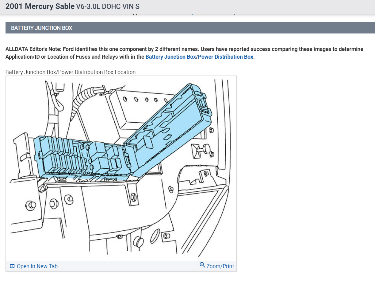

I've replaced all fuses , is what relay is it, and what box is it in.
Jul 23, 2023 at 1:20 PM

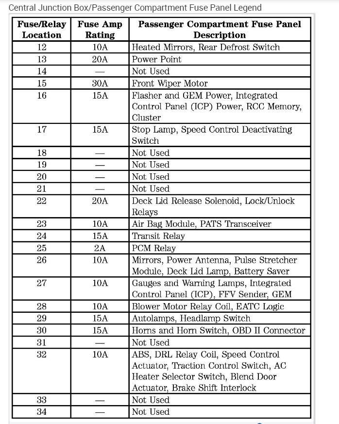

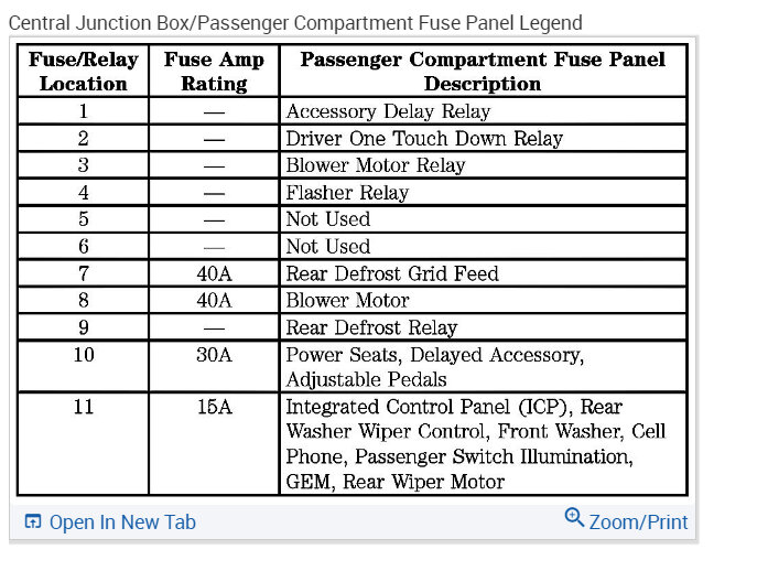

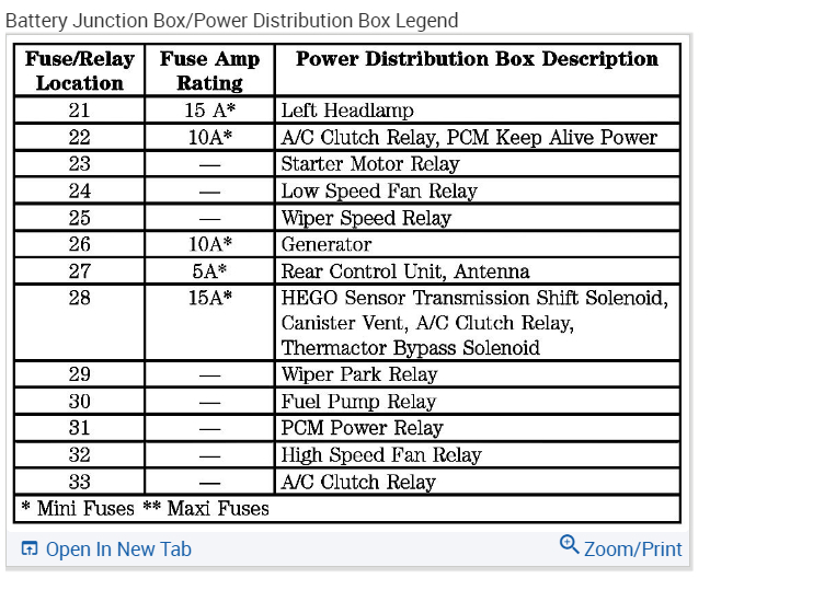

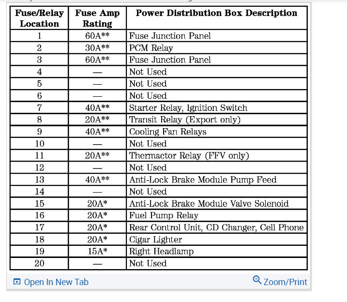

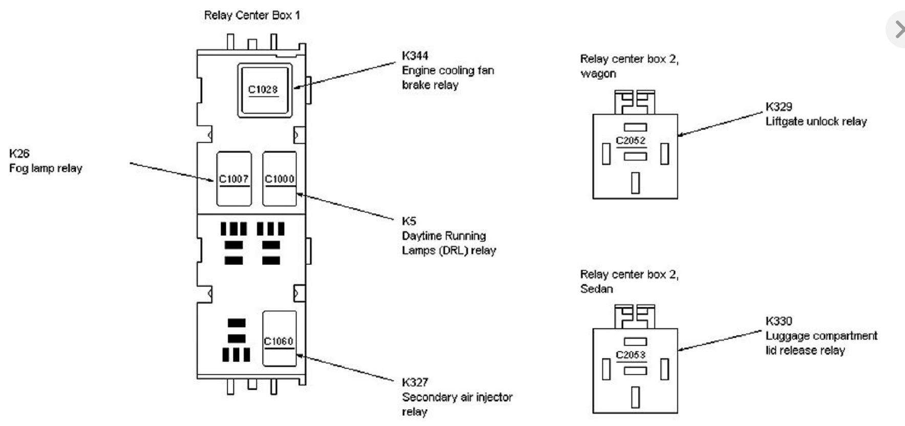

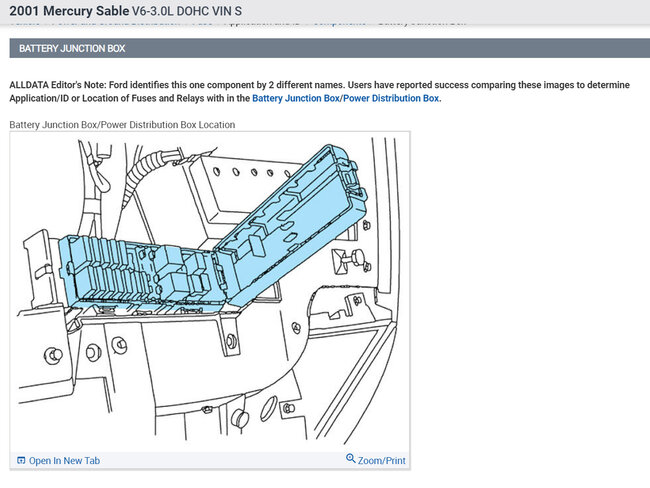

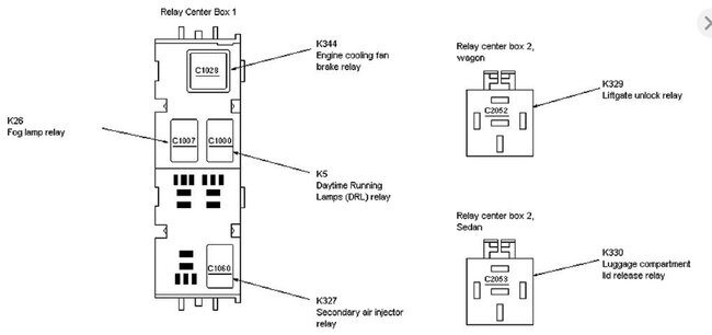

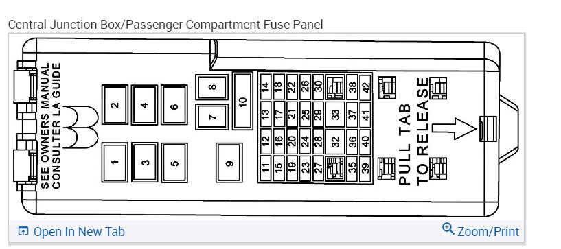

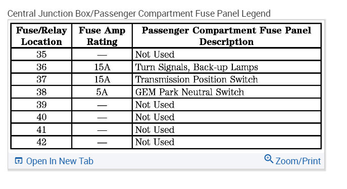

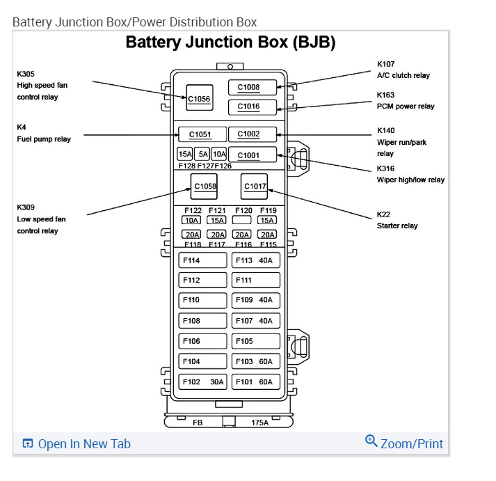

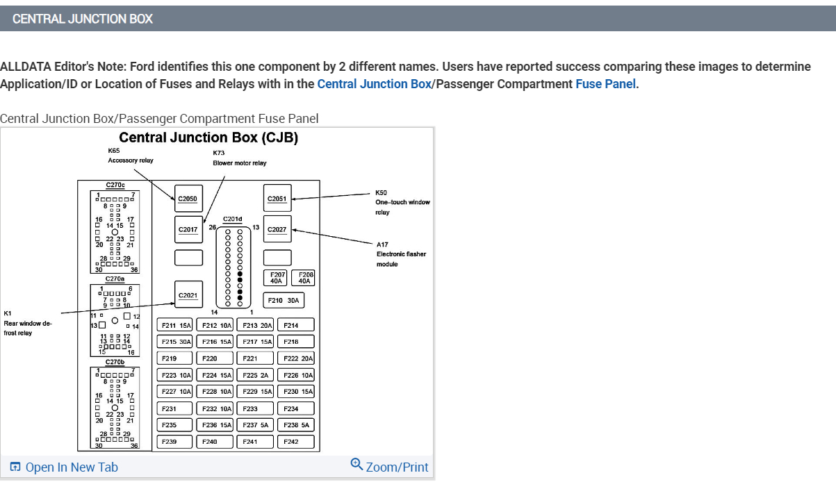

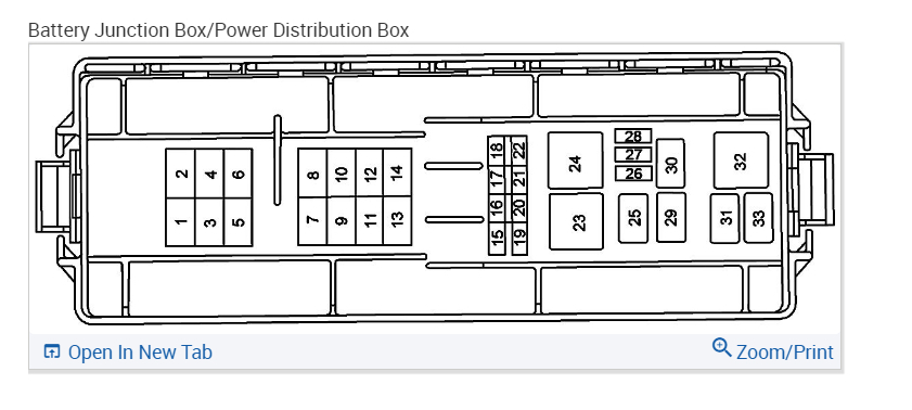

Gotcha, here is the fuse box and relay locations so you can reinstall the fuses and relays.
