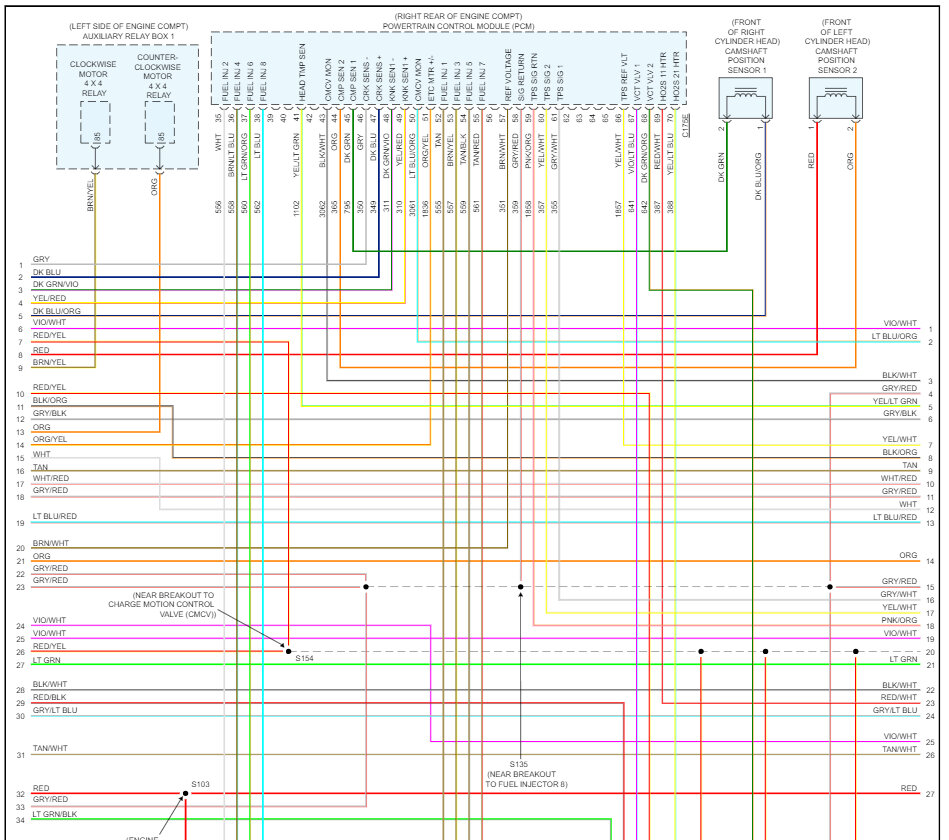

The issue more than likely is the wiring between the PCM (powertrain control module) and the injector in question (#4). Most common location of damaged wiring is at the large square connectors mounted behind the metal bracket on the passenger side firewall (bulkhead) area of the engine compartment. Either a pin was pulled out of the connector, or wire was damaged/broken. 80% of my wire diagnosis have been found with visual inspection.

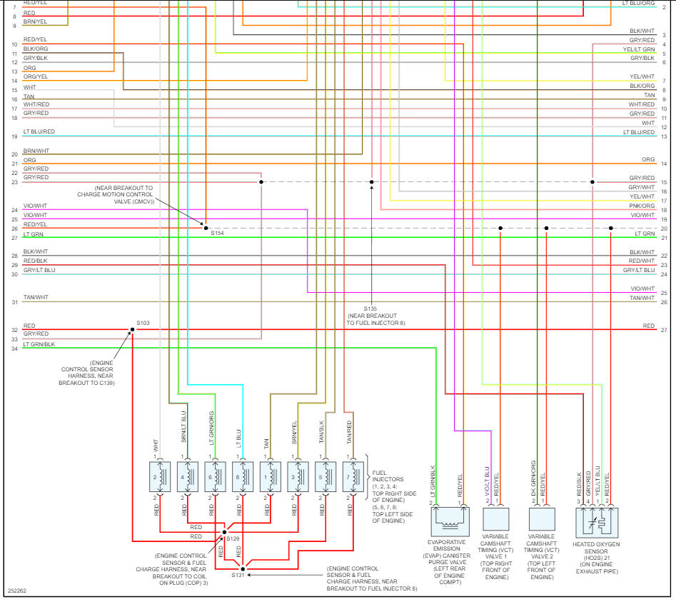

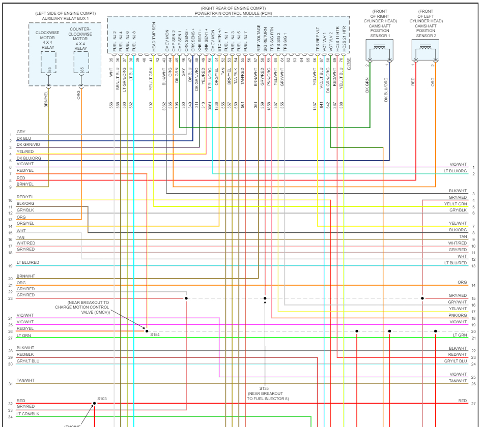

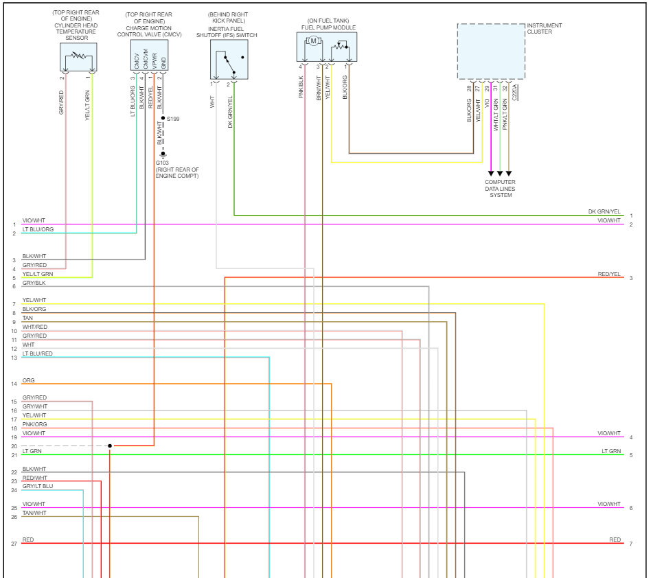

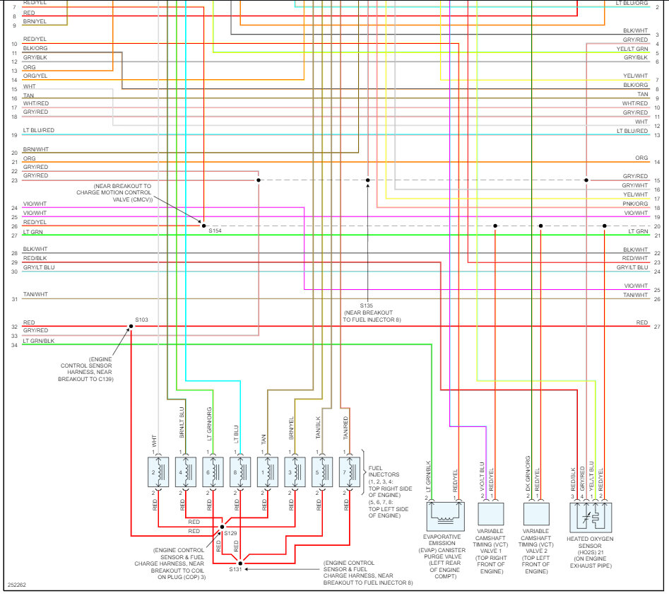

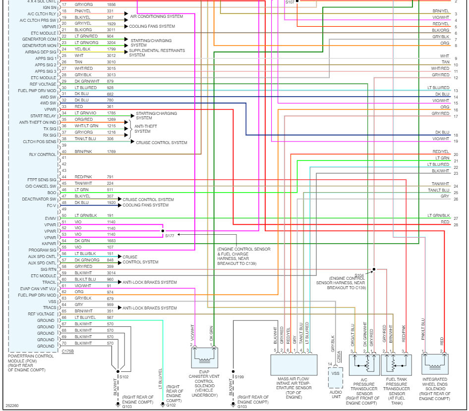

Code P0204 for a 2007 Ford F-150 indicates an issue with the fuel injector circuit for cylinder 4. So, I would check the injector connector for broken wires or corrosion.
Here is a guide to help check the connections and the engine wiring diagrams so you can see which wires to test:
Also, with the key on check for 12 volts at the red wire for the injector connector. Check out the images (below). Please let us know how it goes.

Okay, i unplugged the connector from the #4 injector and ran an ohm test. It is bouncing all over the place, From 8 to in the 60s and 70s. All other plugs stay steady at around 12. Thoughts?

I misunderstood, I thought you were testing the injector not the connector, you must unplug the PCM to check the connections, please go over the guide above.
