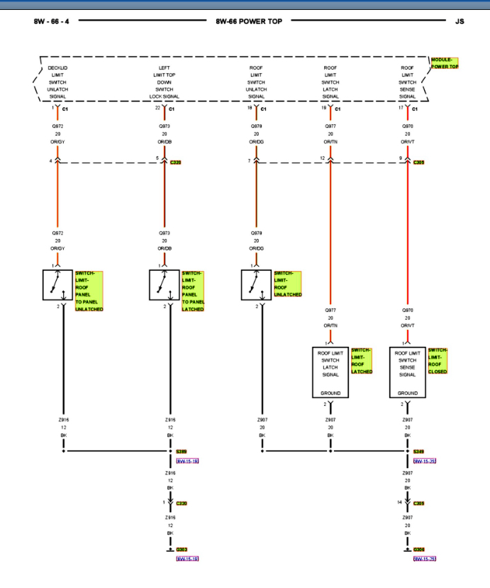

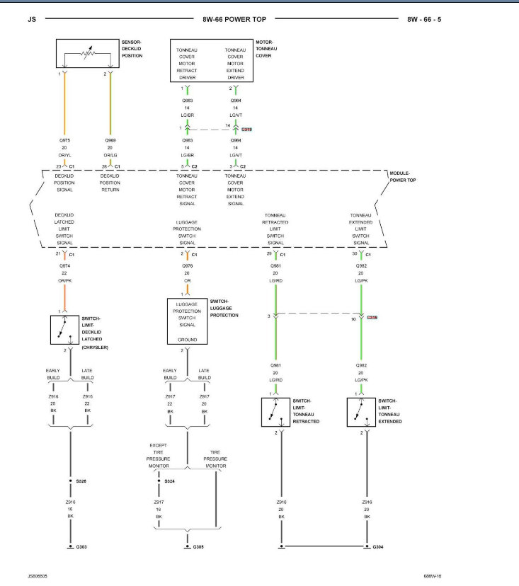

If this is only happening after the vehicle sits in the sun, then it is likely heat related.
Basically, when the top gets hot, there are times that electrical components fail.
So, let's confirm that this truly only happens when it is hot by moving the vehicle to a shady area when it is failed and when it cools down, does it operate normally?

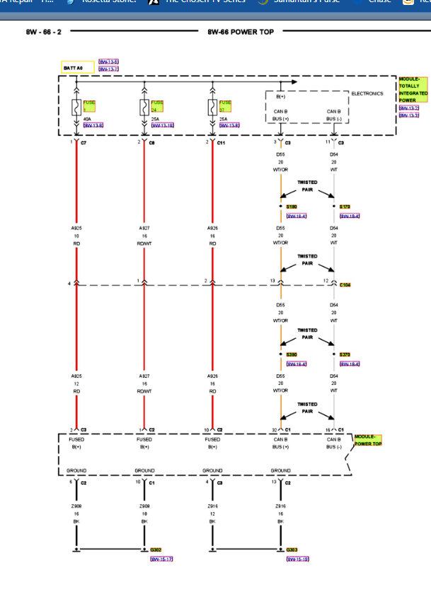

If that is the case, then we need to check the voltage going from the TIPM to the module to find out if we are losing power from the TIPM.
The TIPM is basically a fuse box that has circuit boards and logic contained in it and these are very common to fail so we need to start with this.
The first wiring diagram is what we will need to check on the 3 fuse B+ wires should be 12 volts.
So, let's start with this and go from there. Thanks

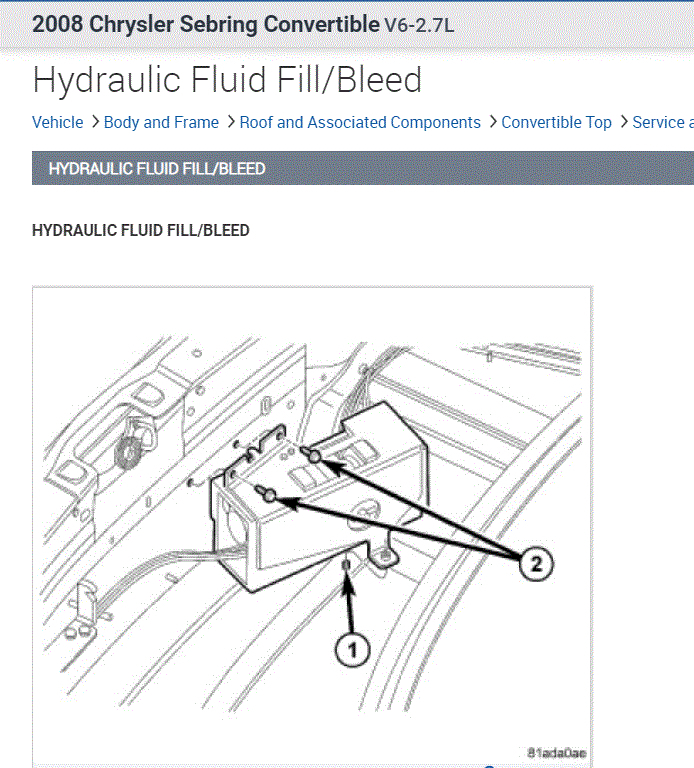

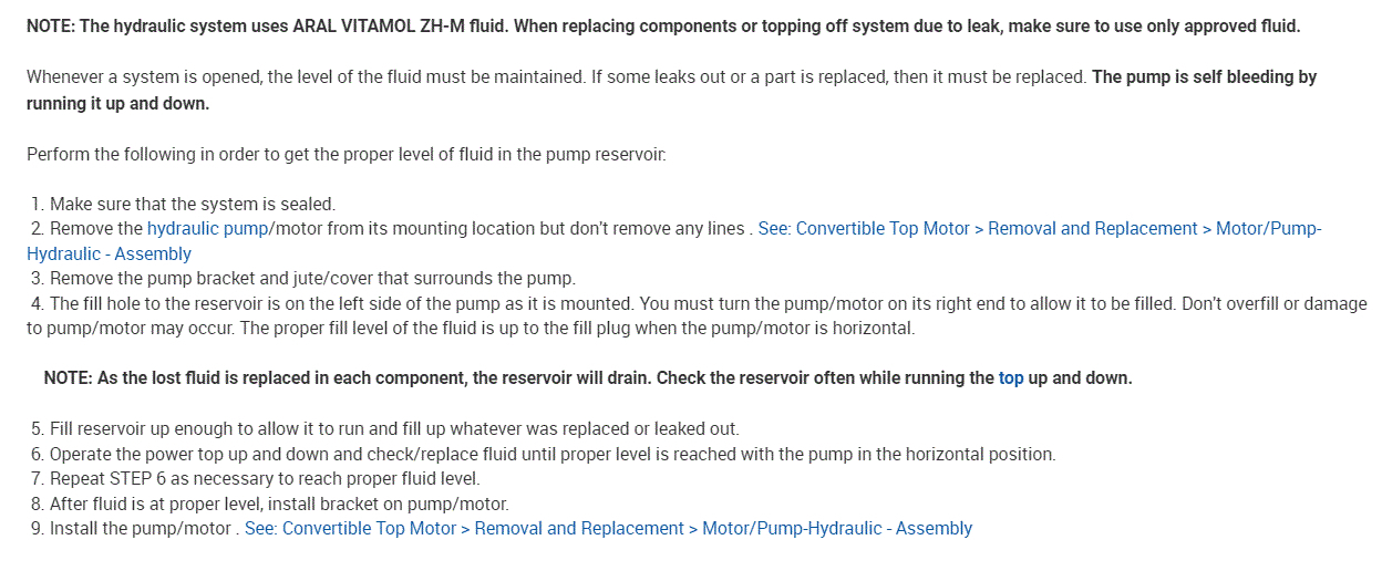

The first thing I suggest is to check the hydraulic level in the pump reservoir. It sounds like it may be low. If you look at the pics below, they provide the procedure for checking.
If the fluid is good, then what needs to be done is a can-scan. CAN stands for controller area network. Basically, all the different computers/modules are tied together via a few wires. This type of scan will retrieve codes regardless of the module storing them.
Here is a link that shows how it's done:
https://www.2carpros.com/articles/can-scan-controller-area-network-easy
The purpose of the scan is because the power top is controlled by a module. The module controls how far it opens, closes, the boot, and every operation of the top. If the fluid level is good, the scan should identify what is happening.
Let me know what you find.
See pics below.
