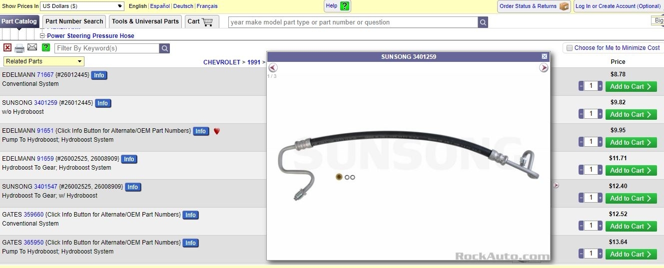

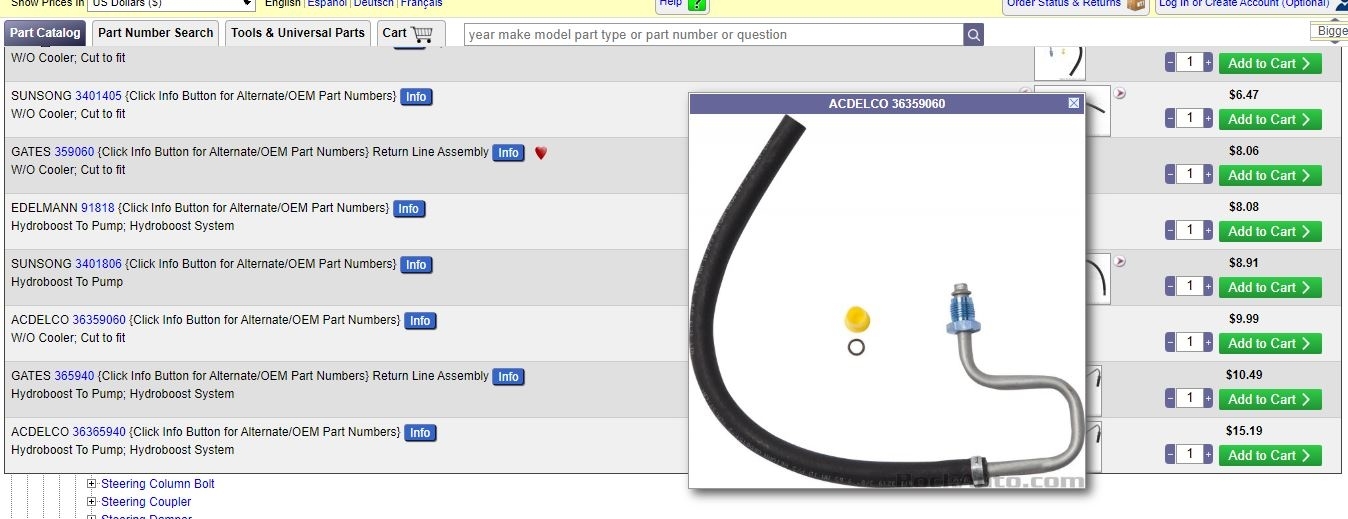

Yes, it sounds like a pressure hose fails.
https://www.2carpros.com/articles/power-steering-problems
I attached the replacement hoses for you to view.
You will need an 5/8 wrench to remove the fitting from the pump for the pressure hose.
You will need an 18mm crows foot to release the lines from the steering box.
