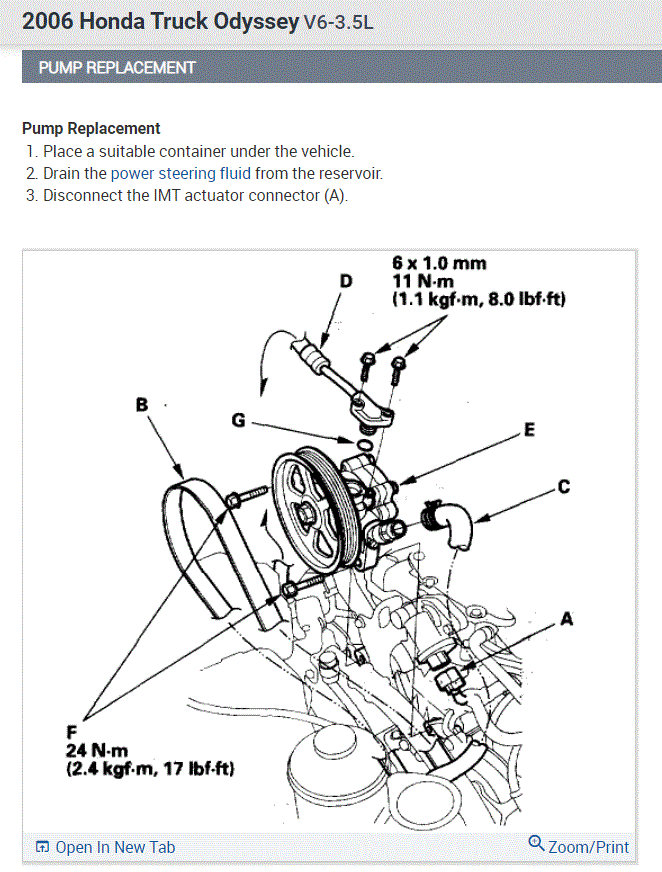

If you are referring to the power steering pump, the manual calls for 1.6 hours of labor. It shouldn't be too difficult.
To get you started, here is a link that shows in general how one is replaced. You can use this as a guide.
https://www.2carpros.com/articles/how-to-replace-a-power-steering-pump

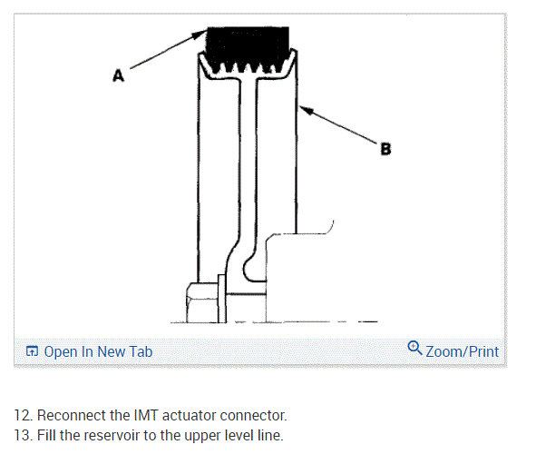

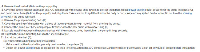

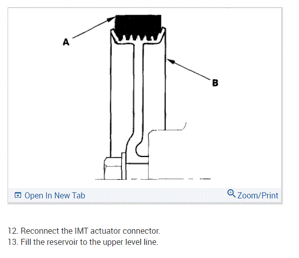

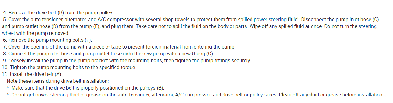

If you look at the attachments below, they provide the directions specific to your vehicle. Take a look through them and see if you have questions.
Take care, and again, let me know if I can help.
See pics below.
