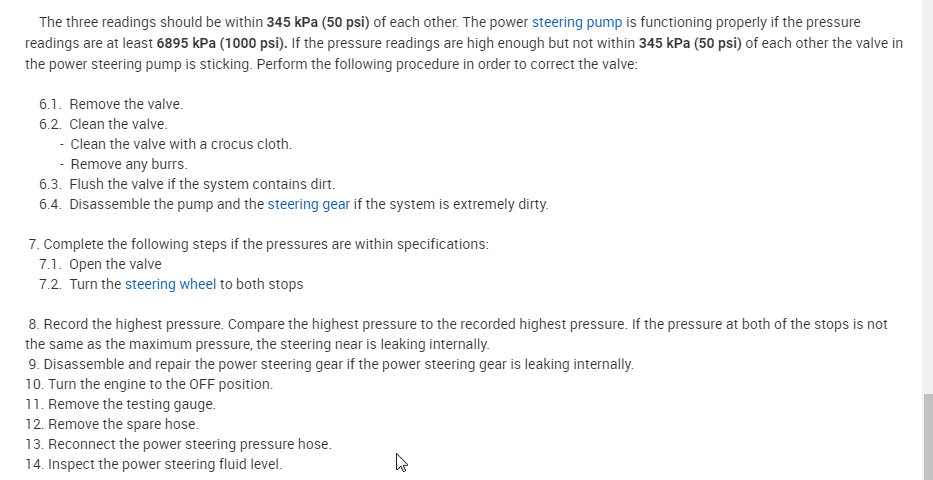

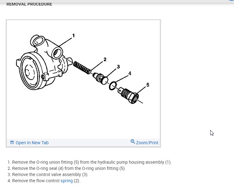

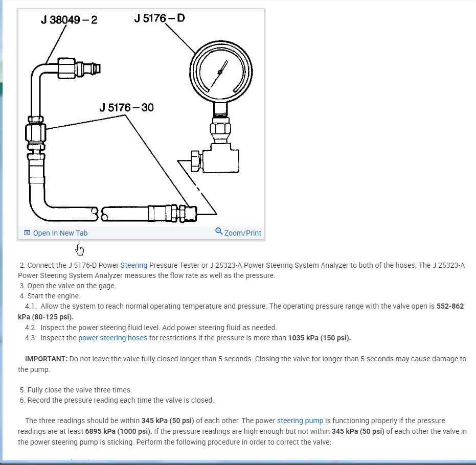

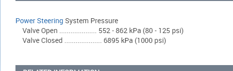

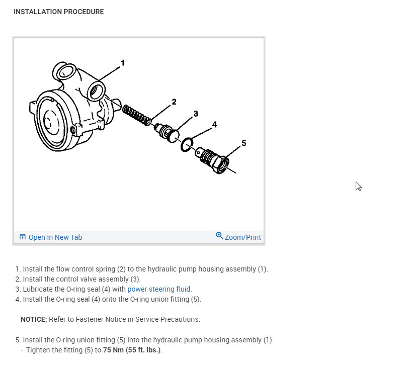

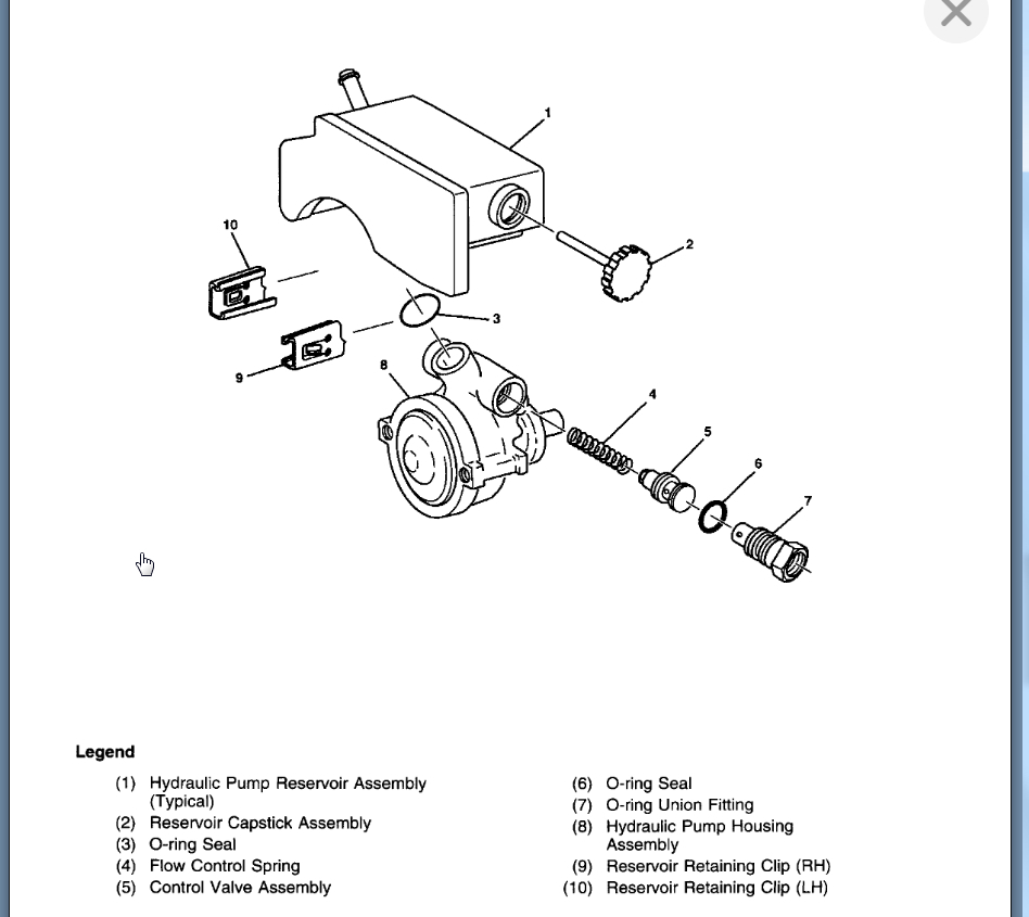

I assume you are referring to the pressure switch? I am not sure of another power steering switch so please let me know if this is not what you were talking about.
I included a lot of information about the pressure switch which is actually called a flow control valve on your vehicle. Let me know if you need more or different information. Thanks

I've been trying to find this part in auto parts stores like AutoZone with no luck. Can you show me a picture of this part?

The issue you are having trying to find this is most likely because it is sold as part of the pump. They show how to remove it for cleaning purposes.

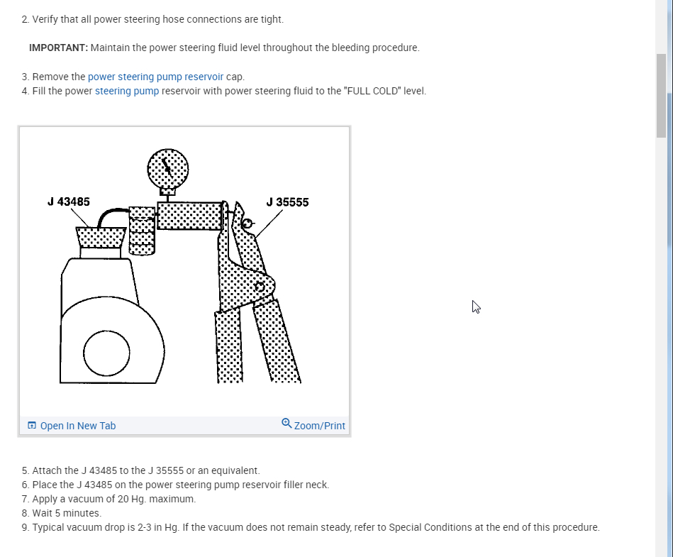

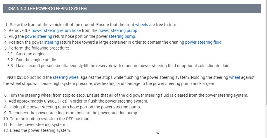

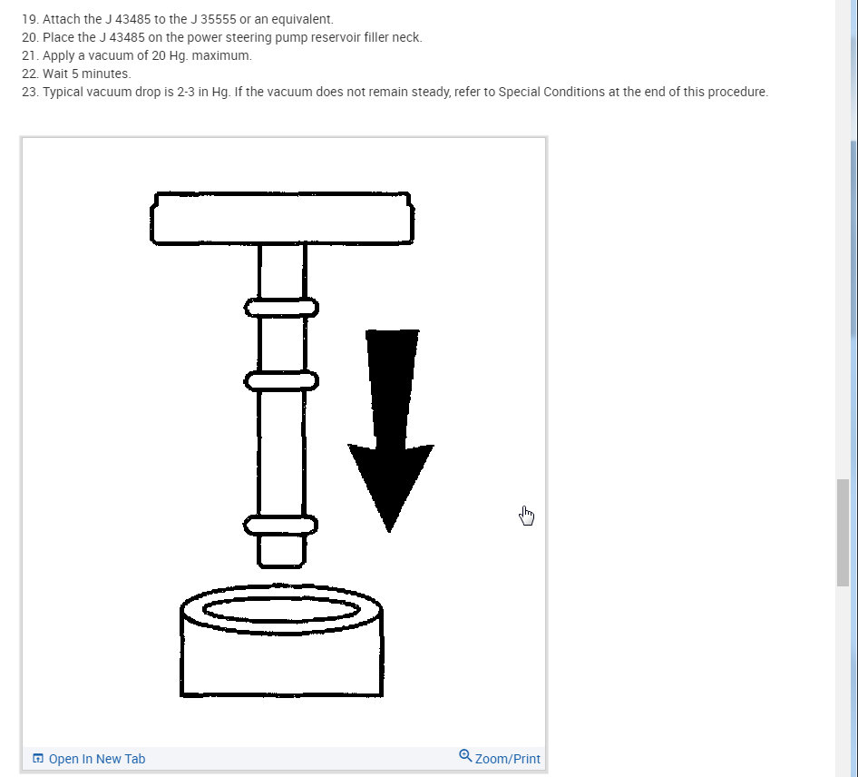

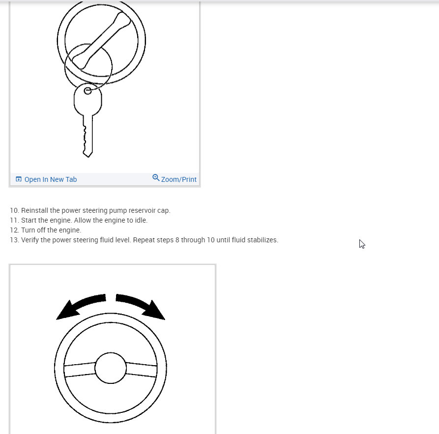

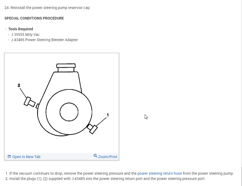

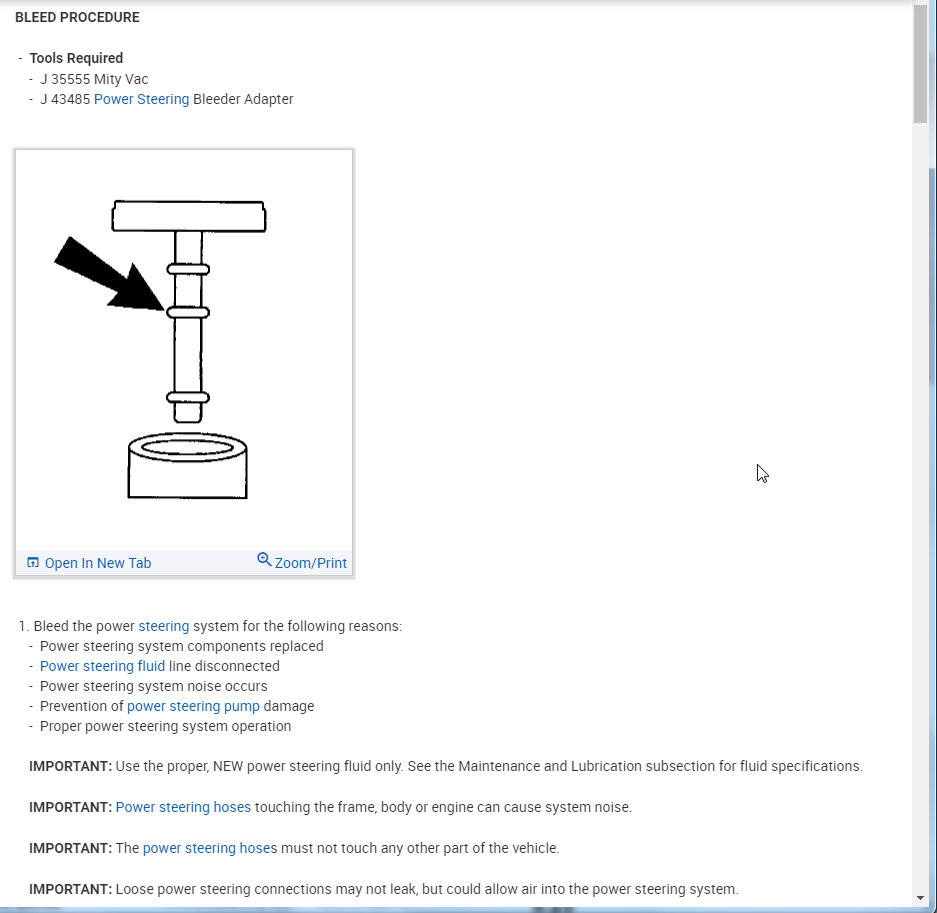

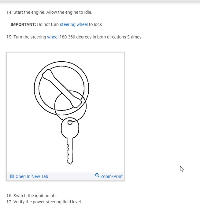

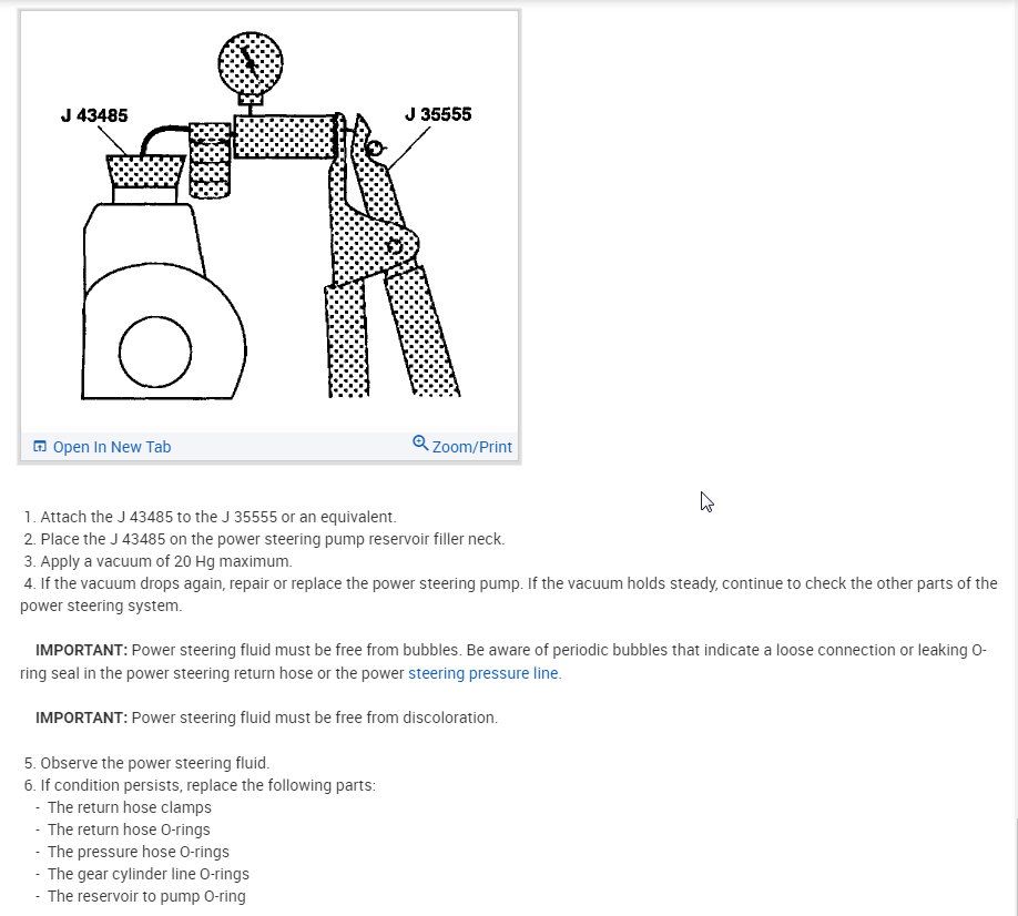

Sorry for the confusion. The fluid itself will smell burnt. Just get a quart of new fluid and smell that. Then smell your fluid in the reservoir and it should be similar. If it smells bad compared to the new fluid then you need to change it.

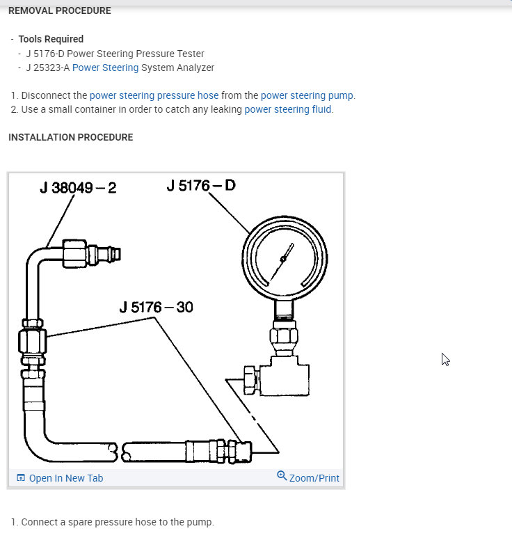

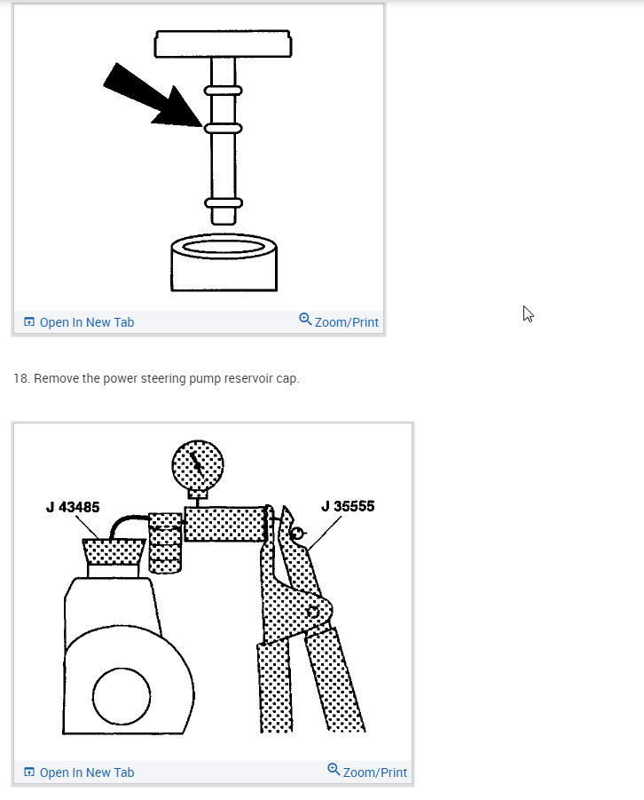

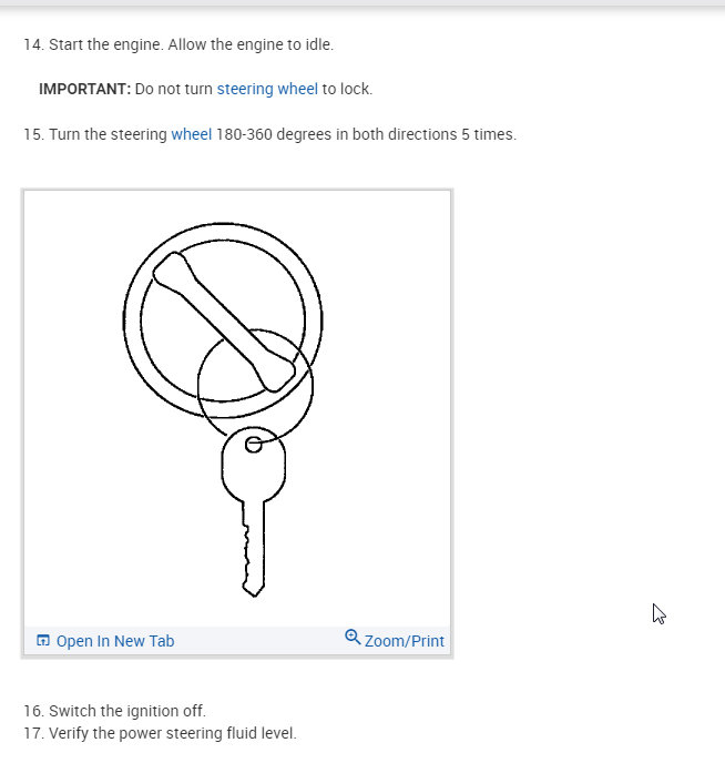

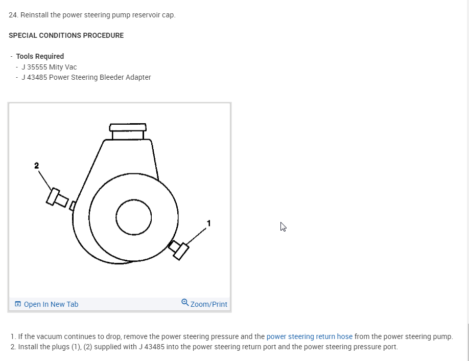

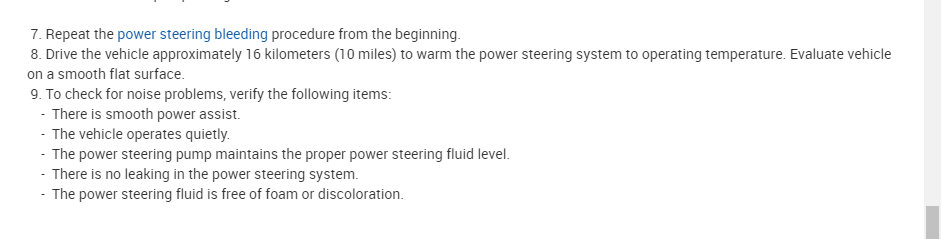

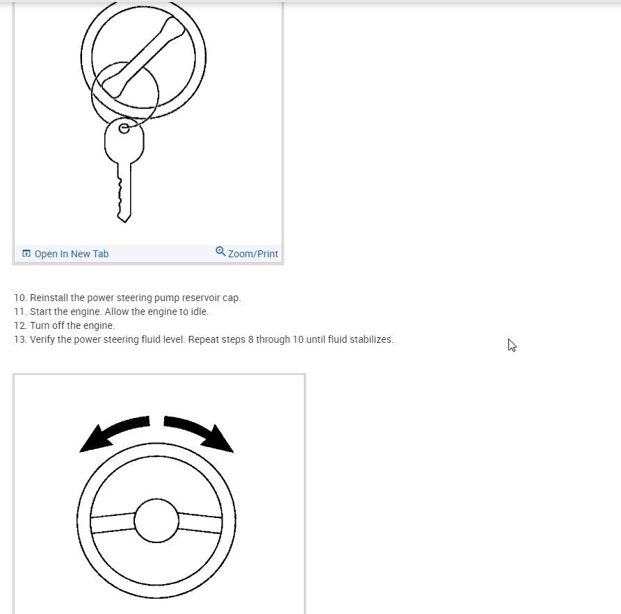

Here is the procedure for draining and bleeding the system.
Nov 4, 2019 at 6:12 PM
