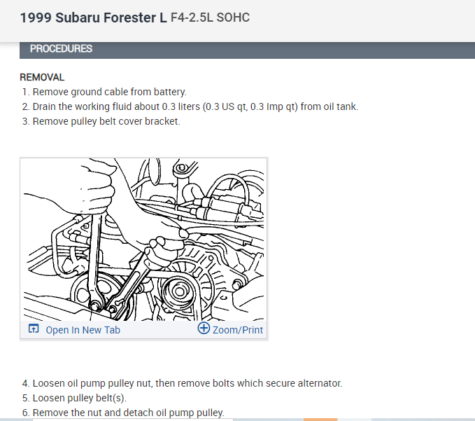

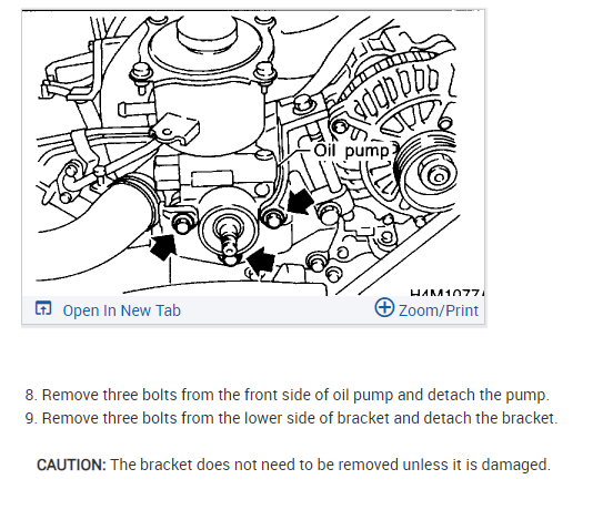

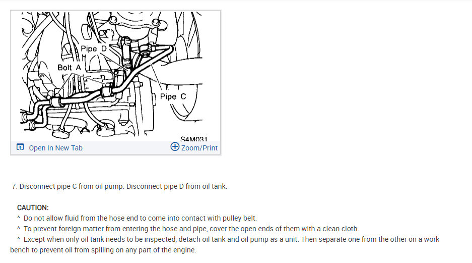

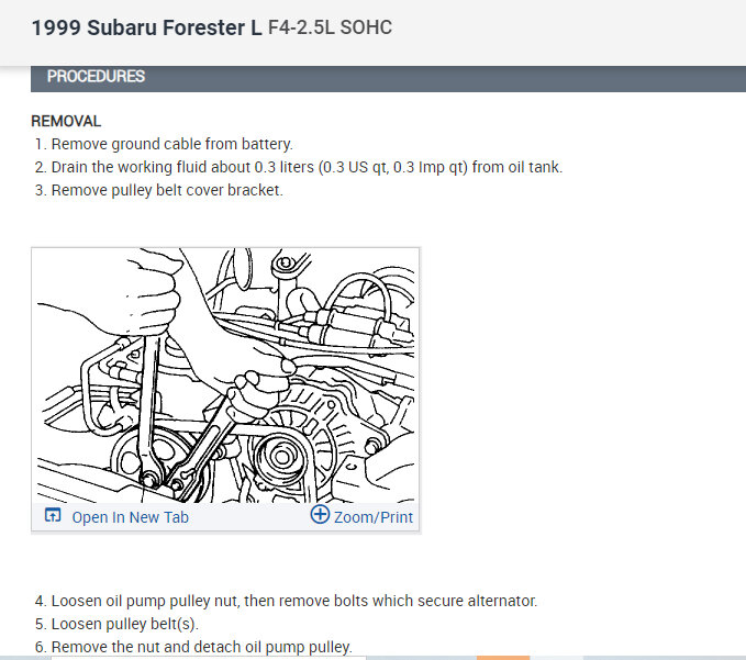

I am thinking of buying a car and one of the issues the current owner mentioned was that the power steering went out but is still drivable. I am curious what the possible problems could be aside from the pump going out and how to determine if that is in fact the issue. And if it is the power steering pump, I could use some step-by-step details about how to do it myself if possible.
