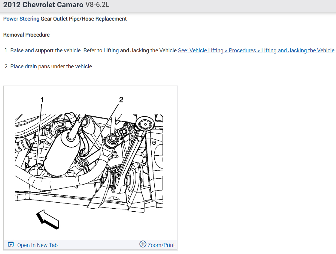

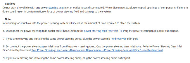

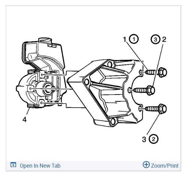

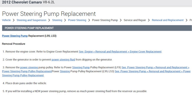

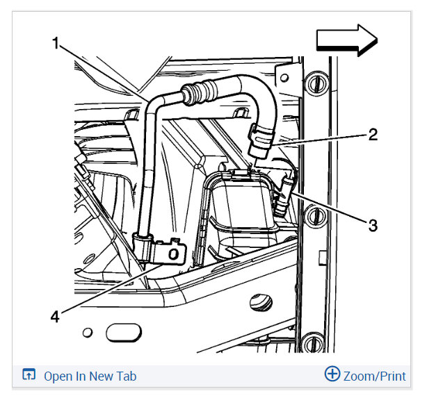

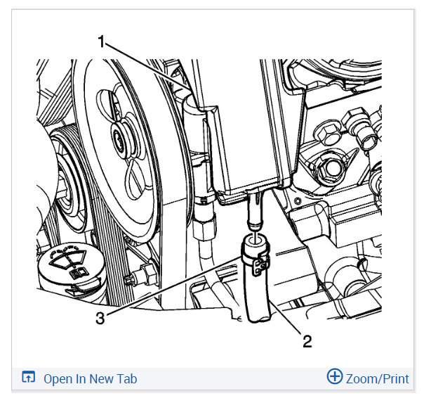

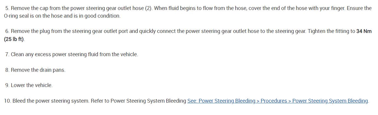

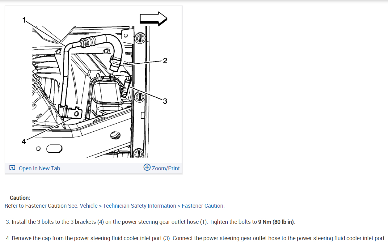

Okay, so, my power steering pump blew because my buddy was doing donuts in my car. I replaced the pump. I think I'm missing an O-ring. There's 2 that came with it. I put the smaller one on the tip of the HP hose going into the pump Where's the other one go?
