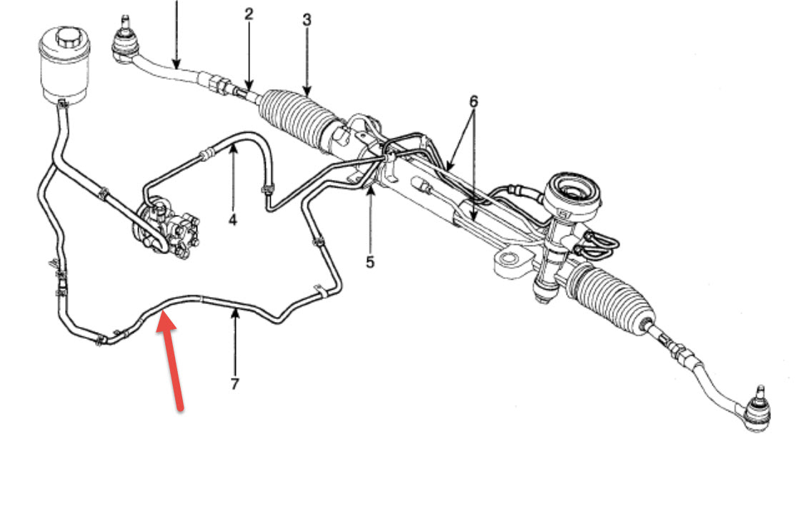

I'm planning to replace my power steering pump, and decided to do a flush while I'm at it. Could I get a diagram of where the return line comes from the gear or rack?

it should be the line with a clamp on the reservoir.
