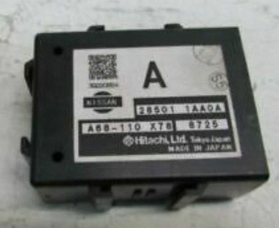

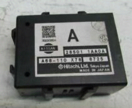

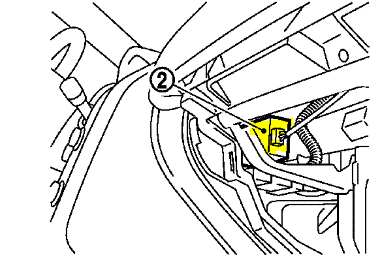

There is a power steering control module under the dash above the steering column that may be causing pressure control issues. See pic 1 below. Pic 2 shows what the module looks like.
