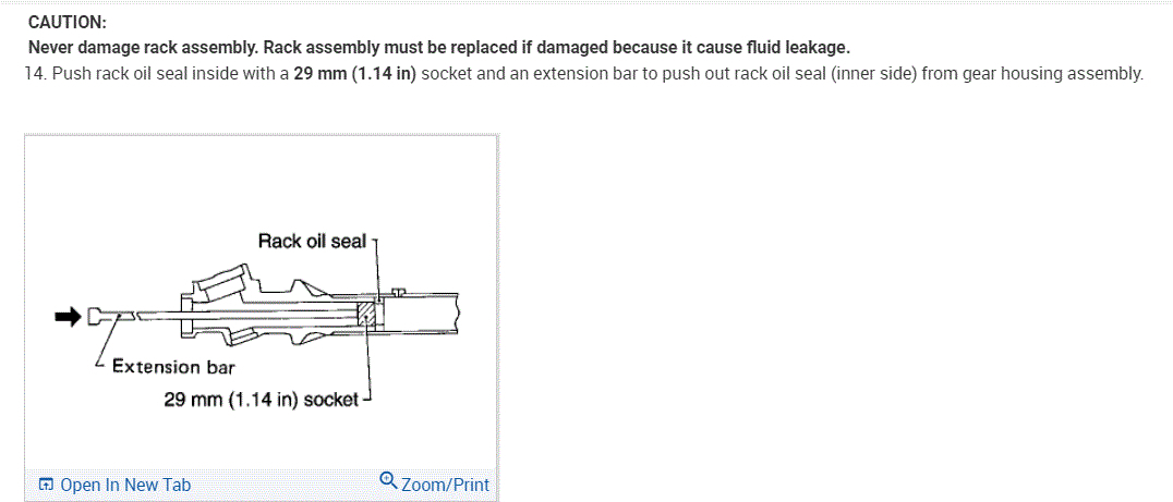

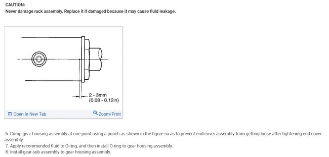

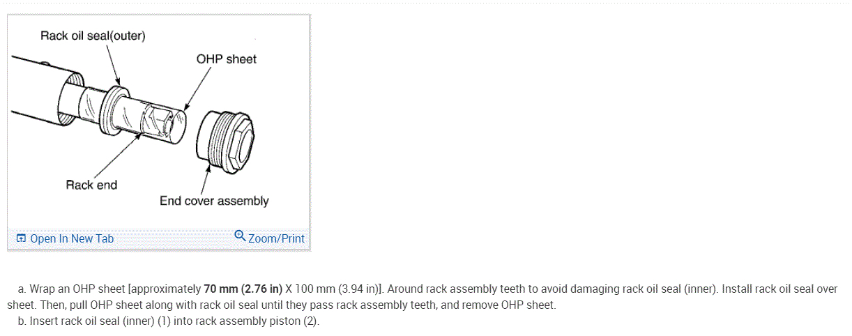

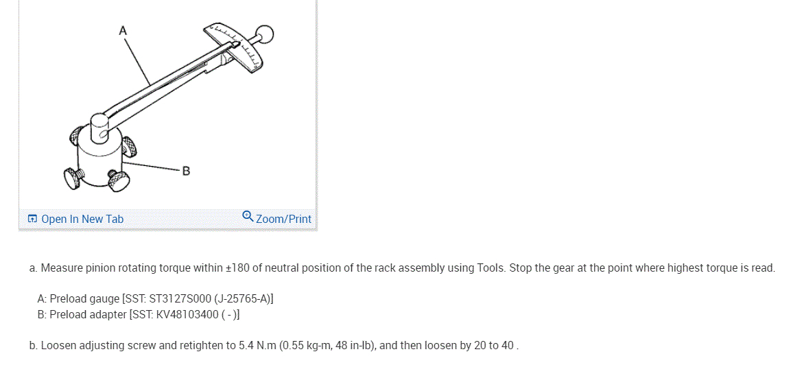

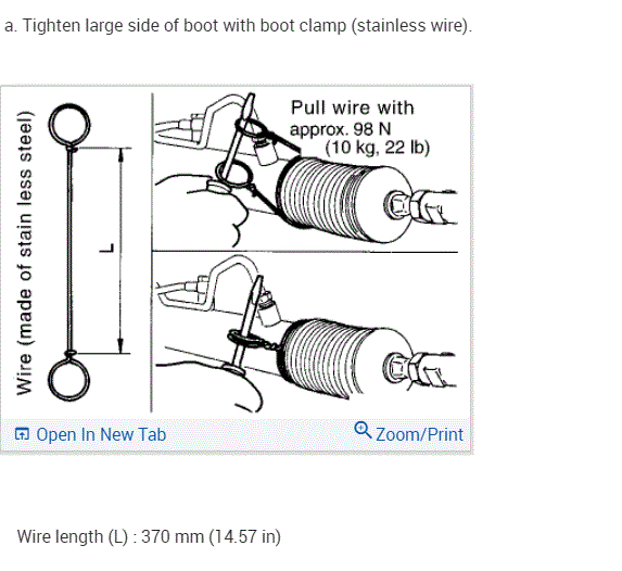

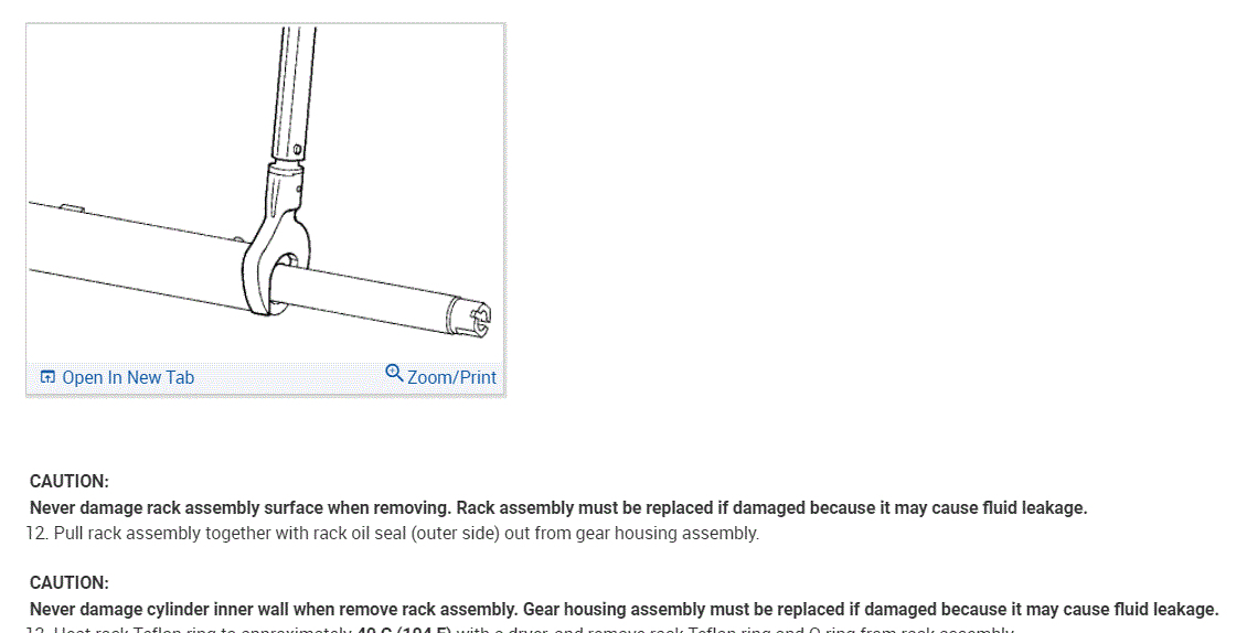

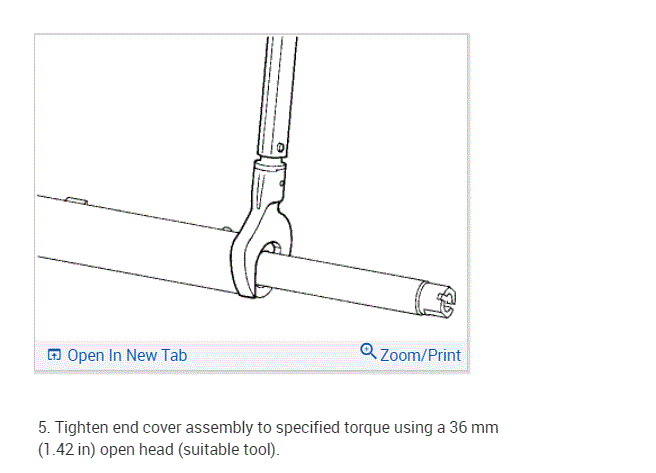

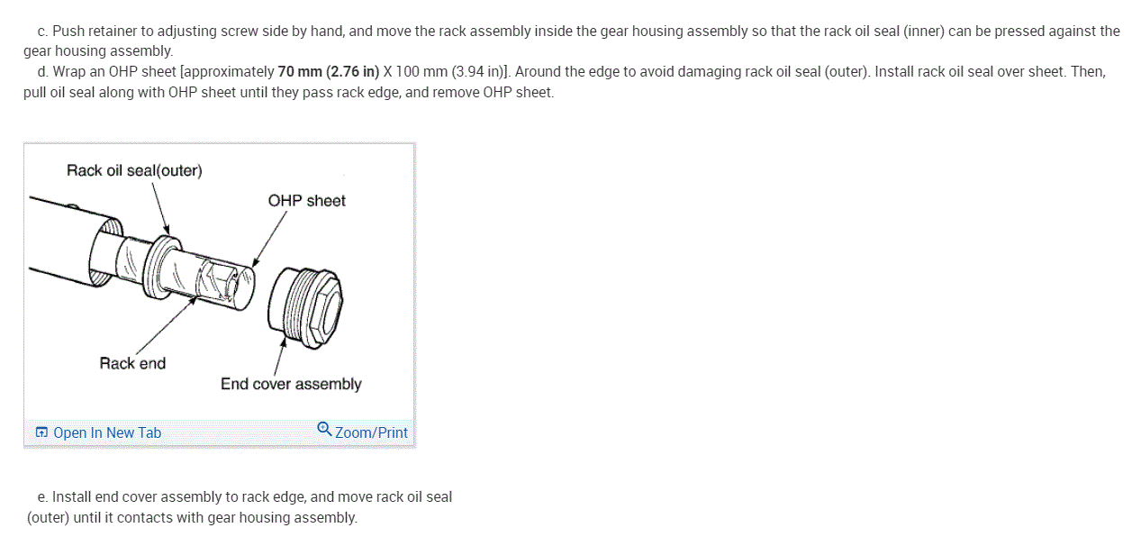

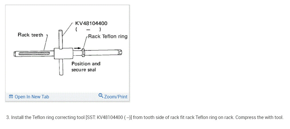

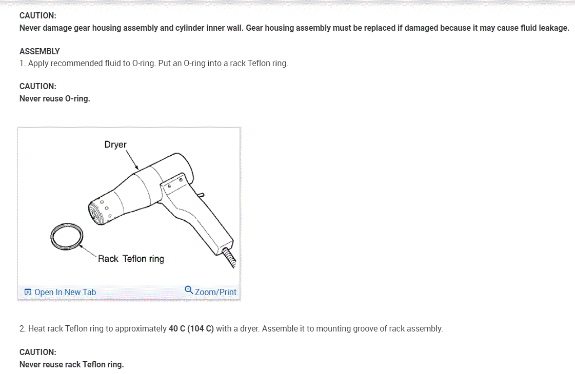

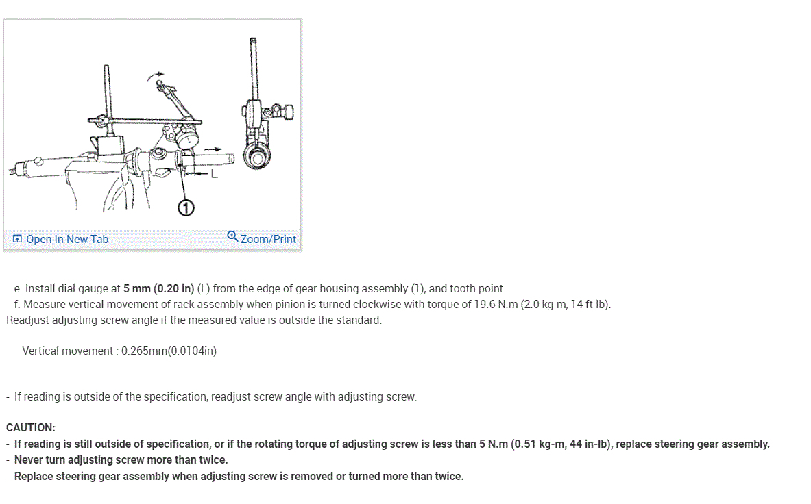

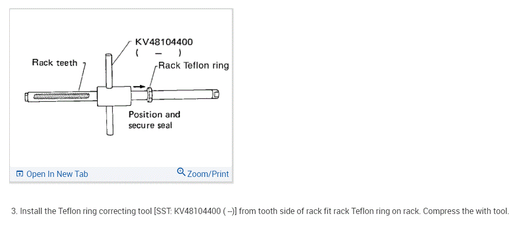

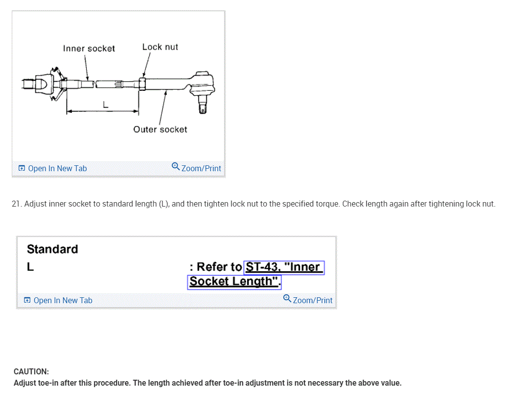

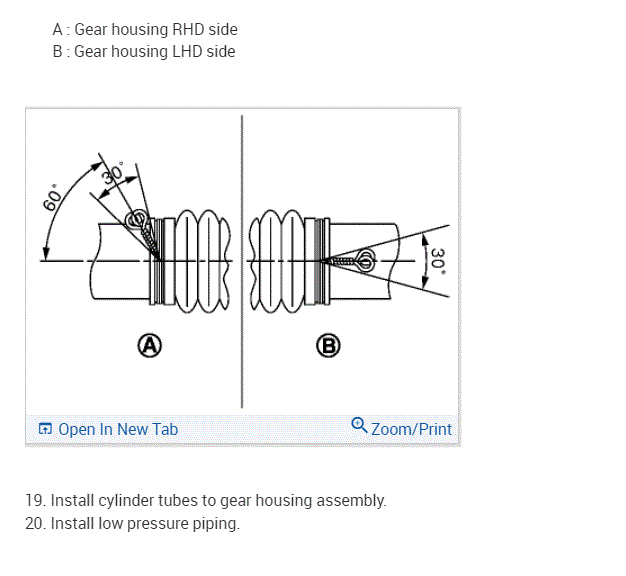

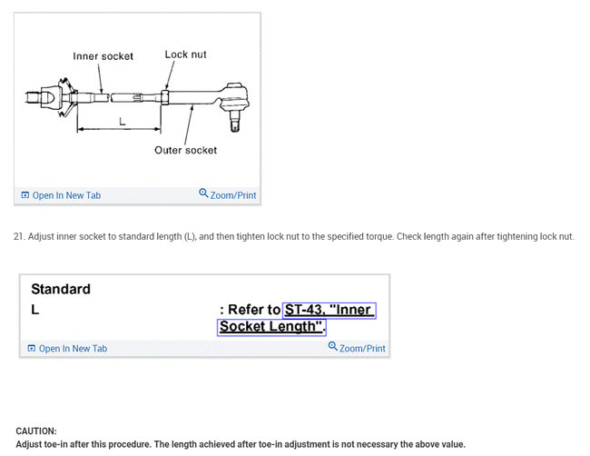

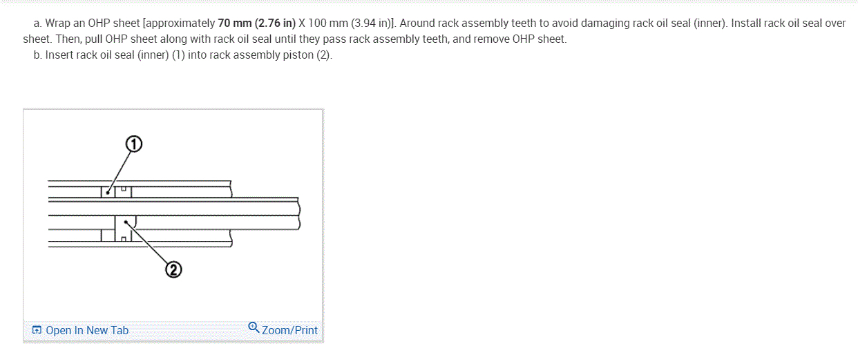

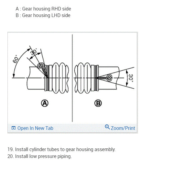

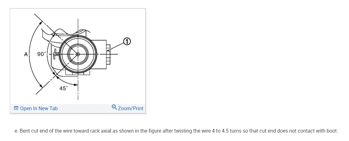

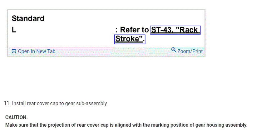

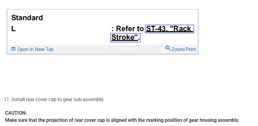

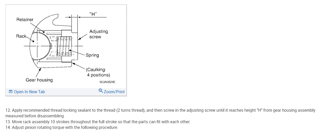

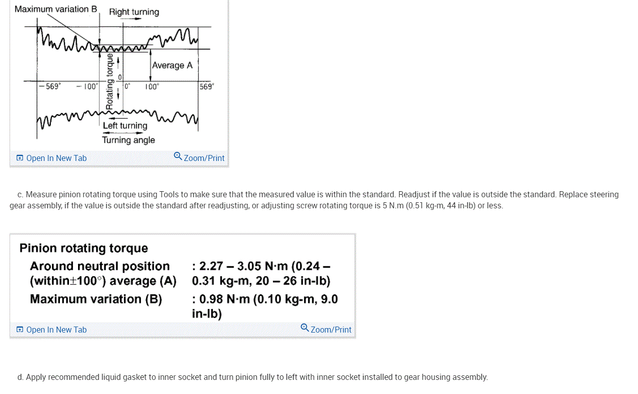

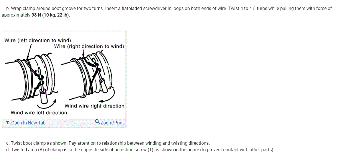

Hi Veronica,

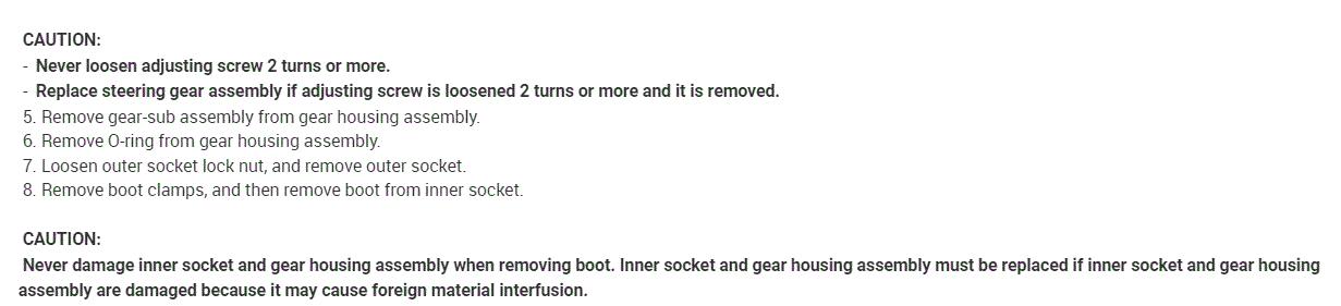

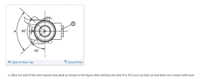

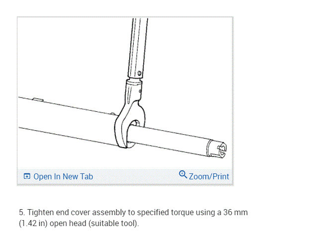

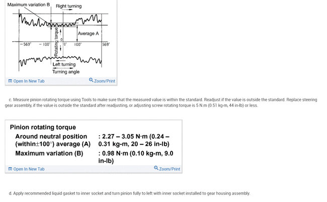

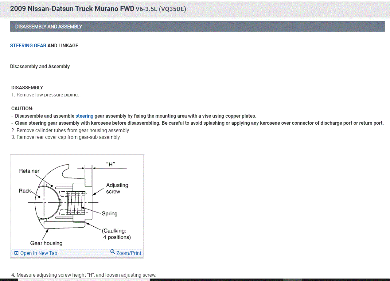

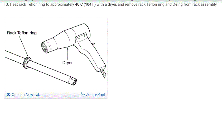

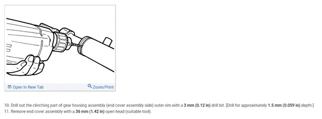

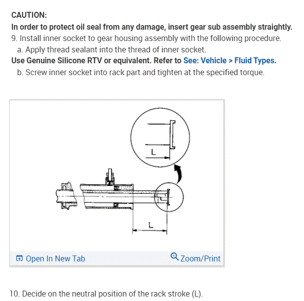

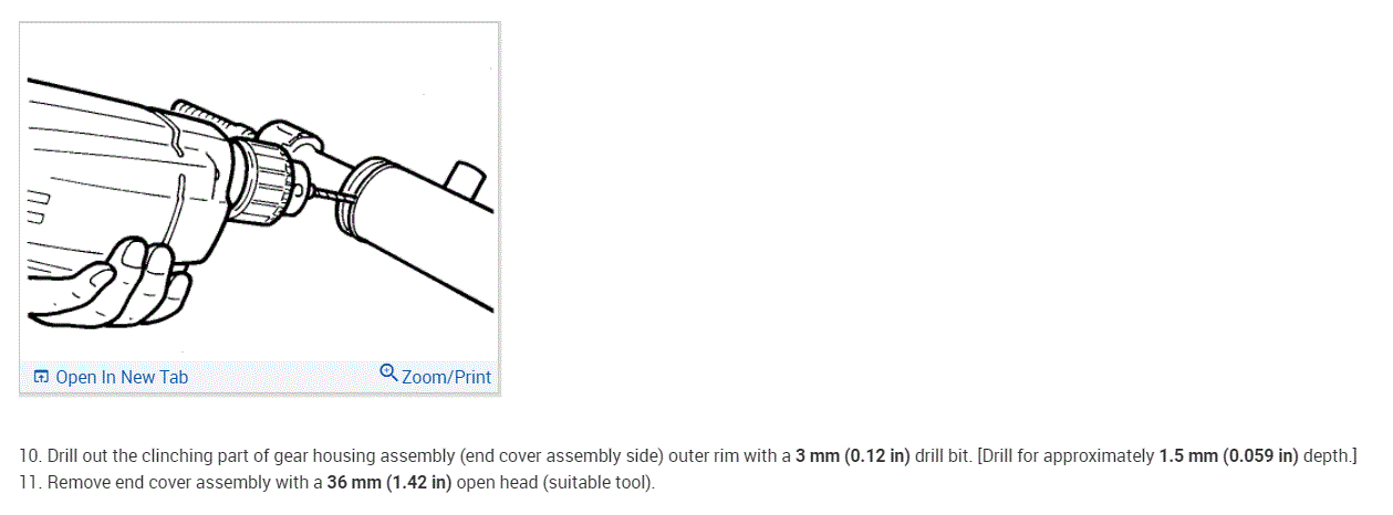

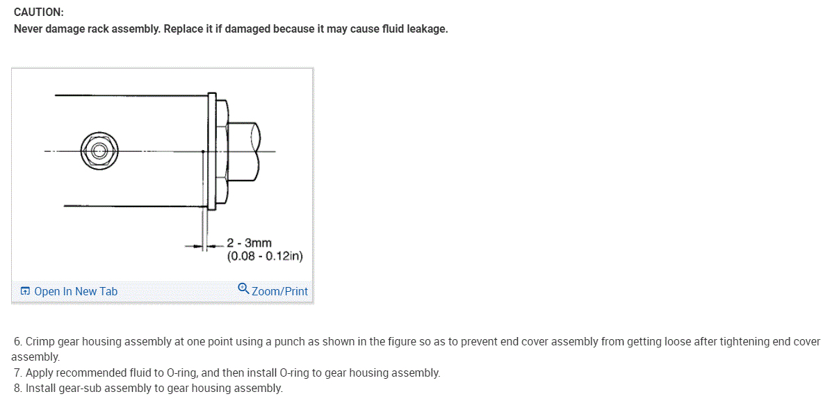

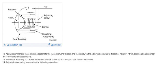

It's nice to see you, but I wish it were under different conditions. As far as rebuilding the one you have, I attached the extensive directions below. I'm not sure what prices you are getting for a new or remanufactured one, but I took a minute and looked it up on Rockauto.com and found you can get one for $255.79 after the core return. That would also come with new inner tie rods. It's just a thought because rebuilding can take a lot of time. Here is the link:
https://www.rockauto.com/en/catalog/nissan,2009,murano,3.5l+v6,1442299,steering,rack+and+pinion,7388
Regardless, the directions are listed below for the rebuild. Let me know if there is anything I can do to help or if you have other questions.
Take care and I wish you a Happy New Year.
See pics below.

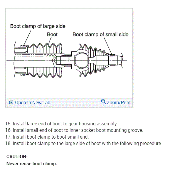

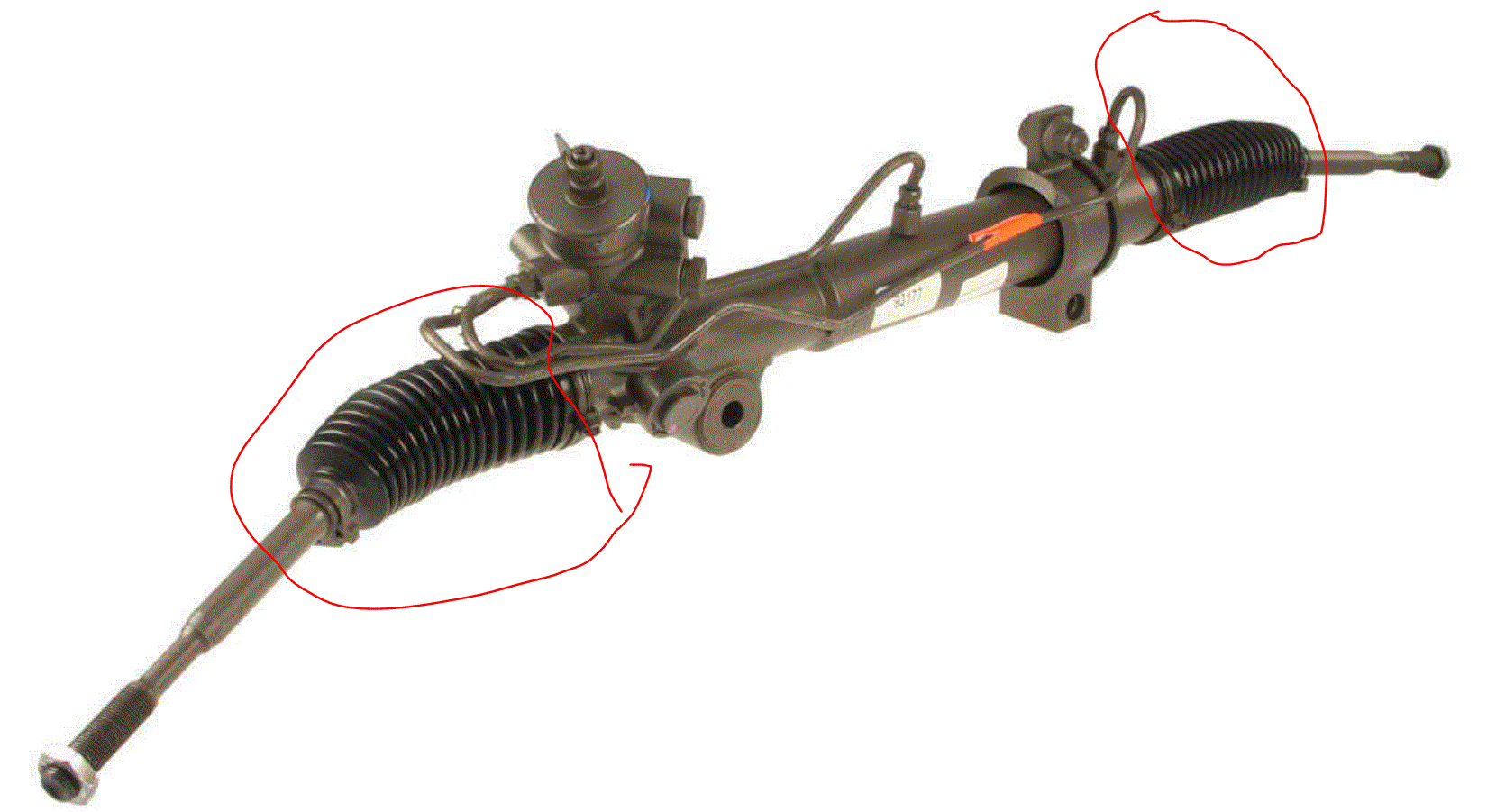

Hi Veronica,

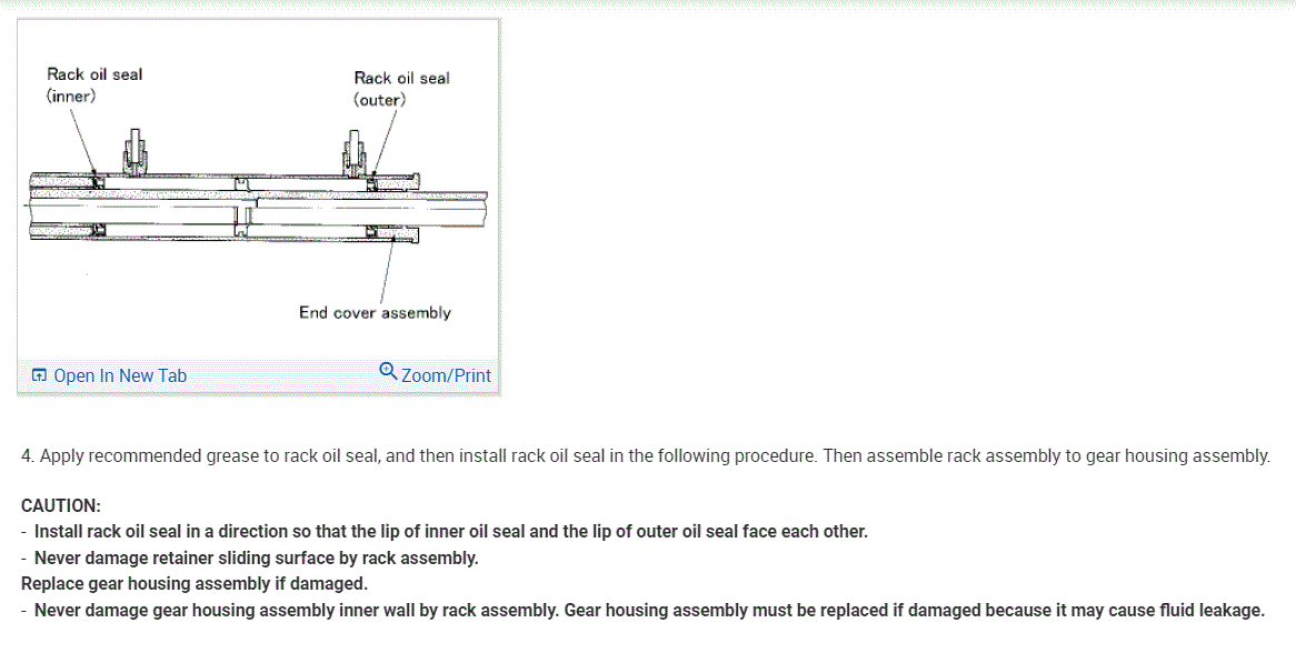

In most cases, the rack and pinion will leak at the rubber boot on each end or on one end. The bushing and seal in them start leaking and it goes into that boot (see pic 1). The boot, once so much gets in it, starts to leak. Check to see if that is where it is leaking.
A plug would prevent power assist and is unlikely. I would think it is more than likely related to the pump. If there was a clog, I would expect the pump to make a noise (much like when trying to oversteer) indicating excessive pressure.
Other than the noise, do you have power assist? Also, here is a link that explains how to flush the power steering system. You may want to start simple with something like this.
https://www.2carpros.com/articles/power-steering-fluid-flush
Also, you indicated two leaks. Here is what I suggest. Look under the vehicle for where it's wet. Use a cleaner to wipe it down and dry it. Then drive the car and inspect it again after the drive. See if there is evidence of where it is coming from.
One other thought (sorry if I'm driving you nuts). You are having a shifting issue. You indicated one of the leaks is below the trans/rack, is the transmission fluid full? If it's getting low, that could be half the problem. The pan gaskets are known to leak. Let me know about that.
Let me know what I can do to help.
Take care of yourself, and Happy New Year.
See pic below.
