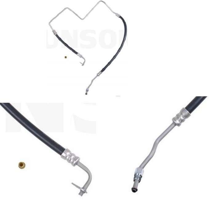

Can I change out a line on my rack and pinion? Or do I need to replace the whole unit because they are permanent lines?

Power steering hoses are replaced separately.
Here's a link to a video that might be helpful:
https://youtu.be/BGBUv5r9fk0
Be careful with the soft metal line nut on the end. It's always a good idea to start it, then run it in a good two or three turns by hand before using a wrench on it. That will insure it isn't cross-threaded. If it gets forced in while it's cross-threaded, the threads it goes into will be damaged, then that part will also have to be replaced.
