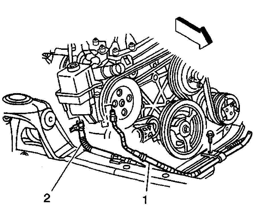

Here are the directions for pump replacement. The attached pictures correlate with the directions.
___________________________________________
POWER STEERING PUMP REPLACEMENT
Power Steering Pump-Replacement
Removal Procedure
1. Remove the radiator air intake baffle.
2. Remove the air cleaner assembly.
See Pic 1

5. Disconnect the power steering pressure hose (1) from the power steering pump.
6. Disconnect the power steering cooler hose (2) from the power steering pump.

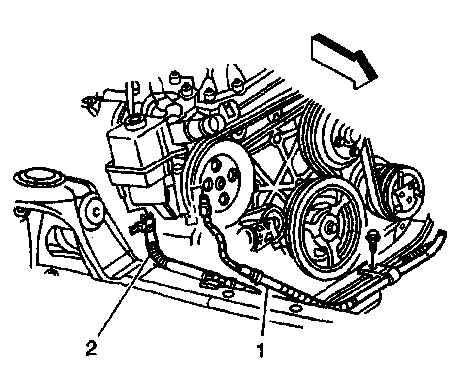

7. Disconnect the wiring harness from the wiring loom on the power steering pump.
See Pic 2

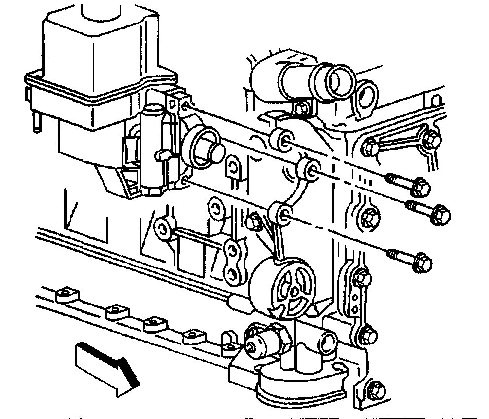

8. Remove the power steering pump mounting bolts.
9. Remove the power steering pump.
10. Remove the power steering pump pulley.

1. Install the power steering pump pulley.
Notice: Refer to Fastener Notice in Service Precautions.
See Pic 3

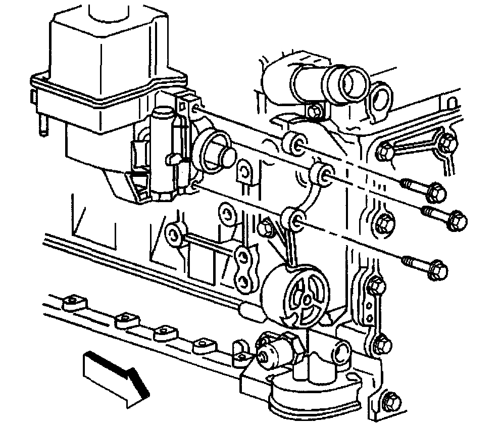

2. Install the power steering pump.
3. Install the power steering pump mounting bolts.
Tighten the power steering pump mounting bolts to 25 Nm (18 ft. lbs.).
See Pic 4
4. Install the power steering cooler hose (2) to the power steering pump.
5. Install the power steering pressure hose (1) to the power steering pump.
Tighten the power steering pressure hose to 25 Nm (18 ft. lbs.).
