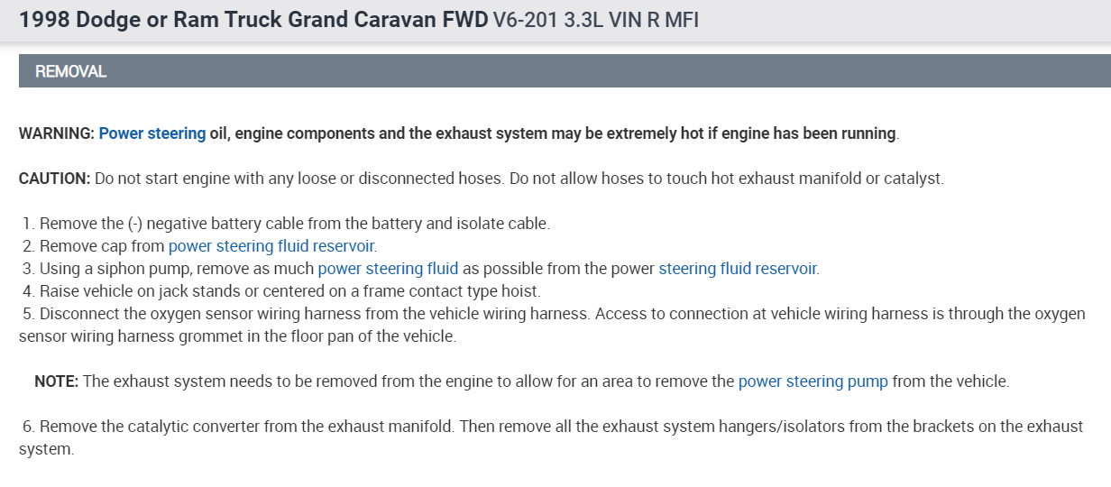

My book says I need to disconnect the catalytic converter, rear O2 wiring harness, and shift the exhaust back and left out of the way.
Is this all necessary to get the pump and lines out?
Oct 31, 2022 at 11:34 AM

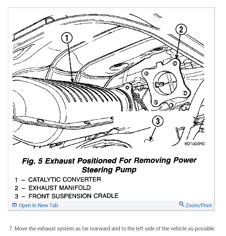

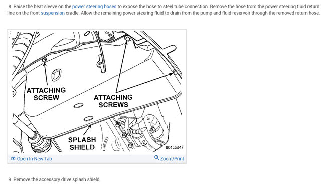

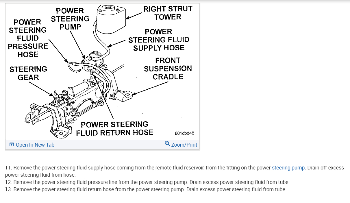

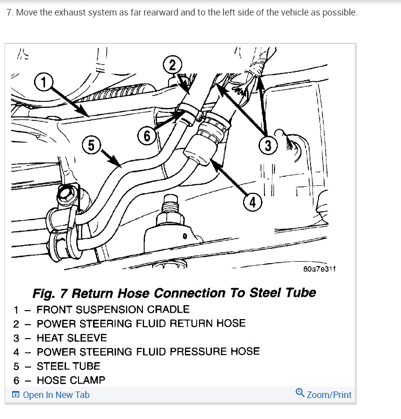

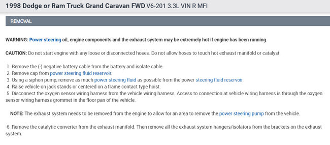

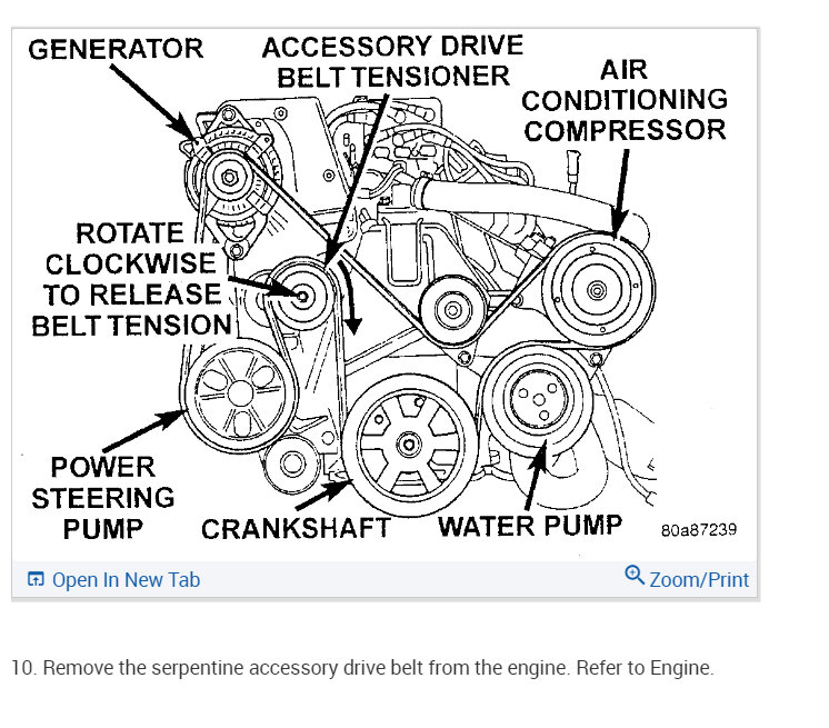

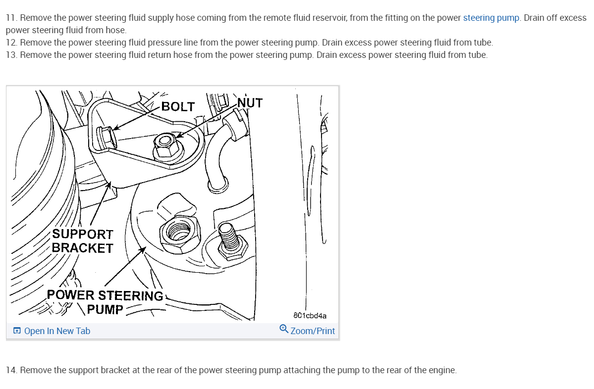

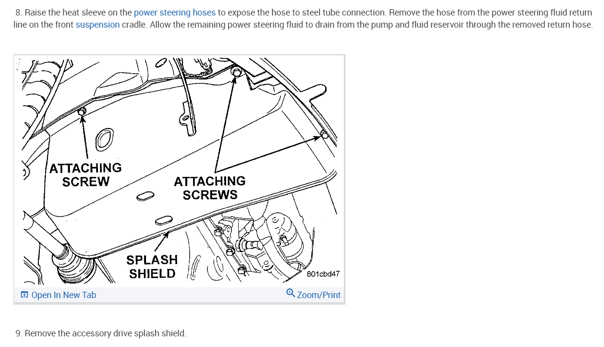

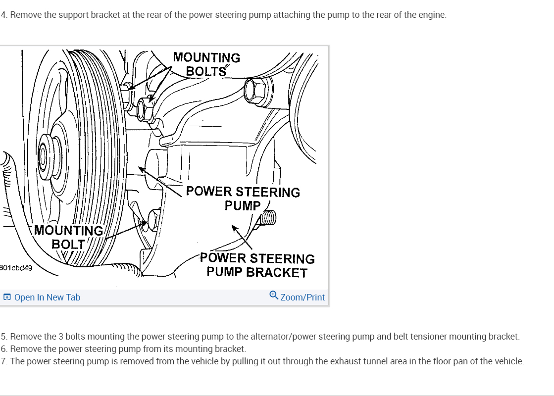

Yep, it looks that way, the pump is on the rear of the engine so there is limited room. here are the instructions to remove the power steering pump step by step featured in the images below. Check out the images (below). Let us know what happens and please upload pictures or videos of the problem.
