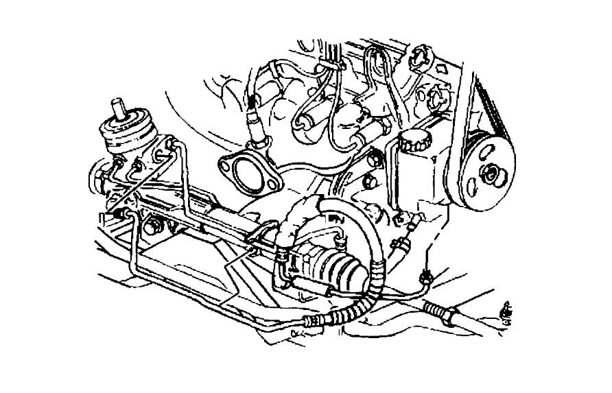

Good evening,
Can you see the fluid moving in the pump from the fluid fill?
Sounds like the pump is providing pressure to the steering gear.

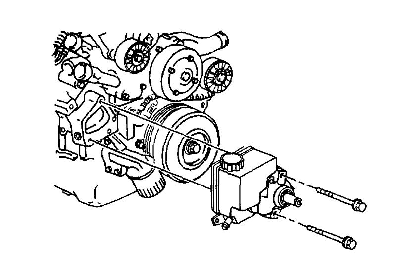

NOTE: The content of this article / image reflects the changes called out by TSB: 05-02-32-004.
Power Steering Pump Replacement
Removal Procedure
1. Remove the accessory drive belt.
2. Raise and support the vehicle. Refer to Vehicle Lifting.
3. Remove the tire and wheel assembly.

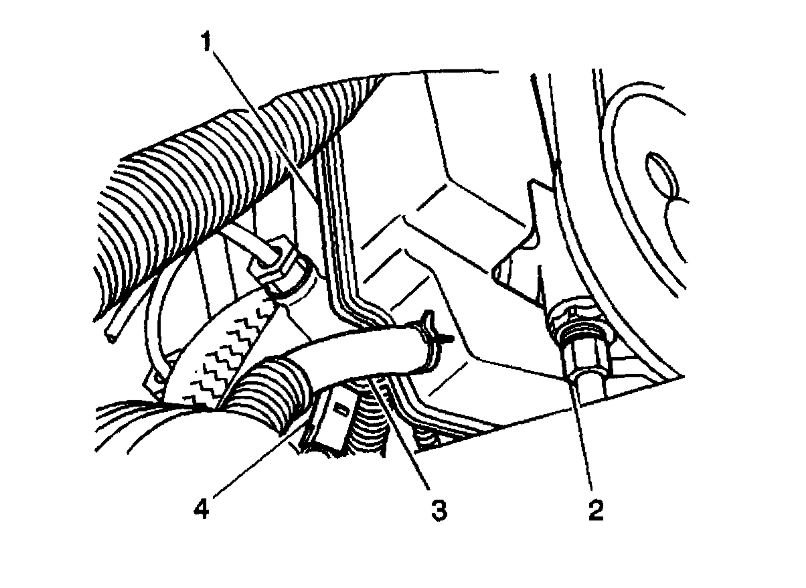

4. Disconnect the power steering pressure hose from the power steering pump.
5. Disconnect the power steering return hose from the power steering pump.
6. Disconnect the harness connector (4) from the power steering pump (1).
7. Remove the power steering mounting bolts from the power steering pump.
8. Remove the power steering pump from the engine.
9. Remove the power steering pump pulley from the power steering pump.
10. Remove the power steering pump reservoir from the power steering pump.
