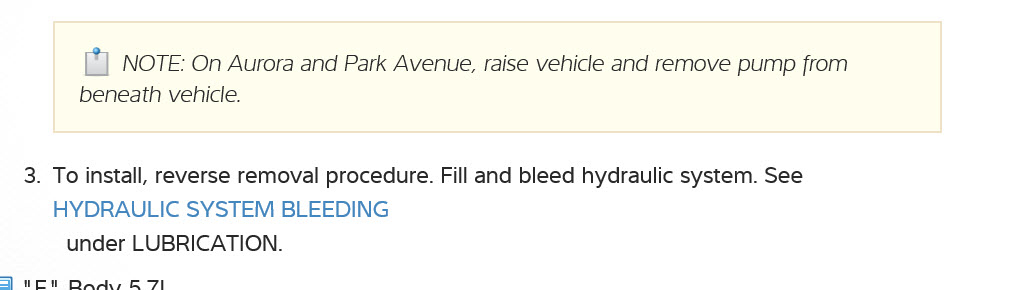

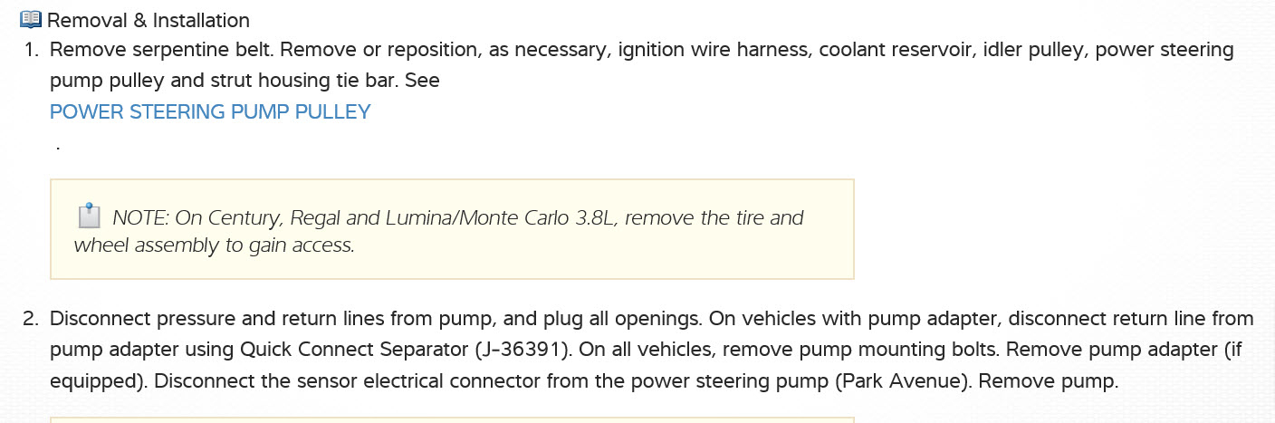

see pics you will need a special tools to remove and install pulley auto parts may rent it.
