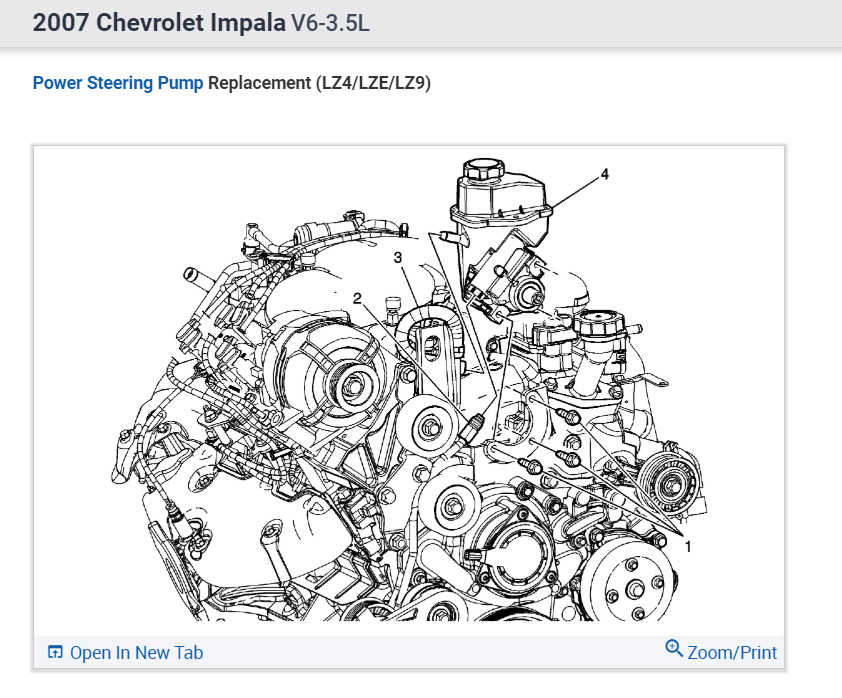

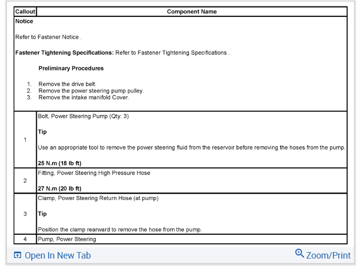

Yes, this is because the pump is sucking in air causing the fluid to overflow. here is a guide to help walk you through the repair with instructions and diagrams below to show you how on your car:
https://www.2carpros.com/articles/how-to-replace-a-power-steering-pump
