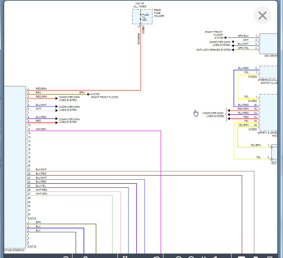

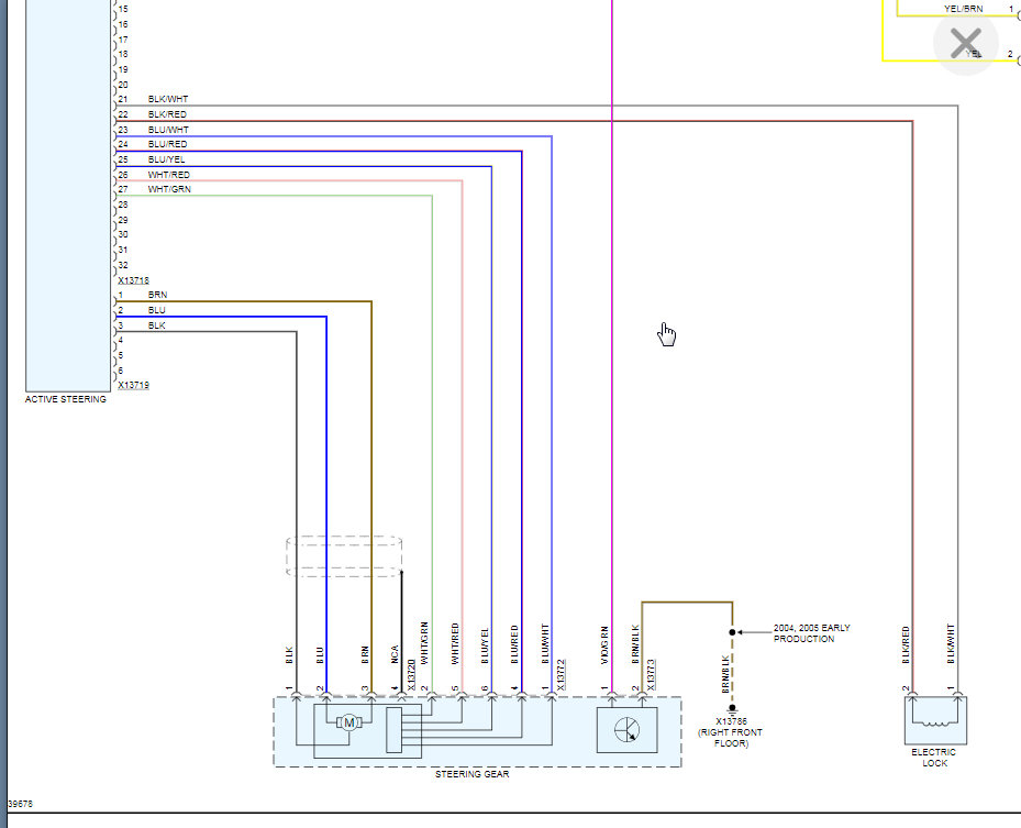

Okay. It is appears you have electric power steering pump so we need to find out if you have power going to the pump.
I attached the wiring diagram below that shows the wiring coming into the gear so we need to check for voltage especially on the wiring to the motor itself.
Let me know if you have questions on this. Thanks
