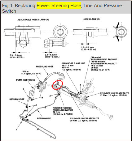

I am attaching a picture for you with the pressure switch circled in red. Do you think this could be the hang up pulling out the pressure hose? Sometimes there are clamps (metal or plastic) that are used to attach to frame/body to keep secure. Hope this helps! Let me know if you have any questions.
