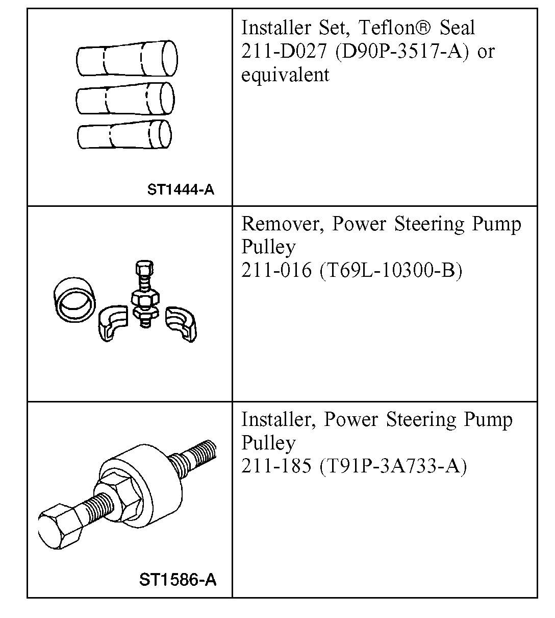

Here are the directions specific to replacing the pump. Most likely, you will need to rent a tool for pulley removal and replacement. Here is a link that shows how it is done.

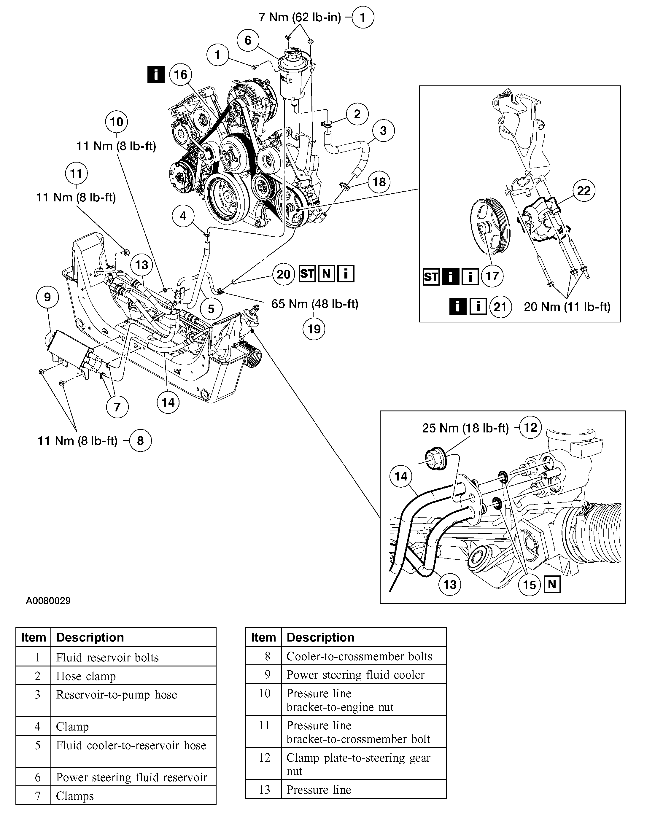

Pic 2
Part 1 Of 2
Pic 3
Part 2 Of 2

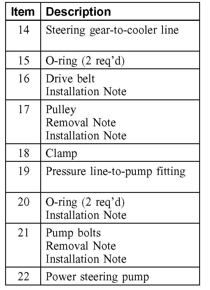

Pic 4

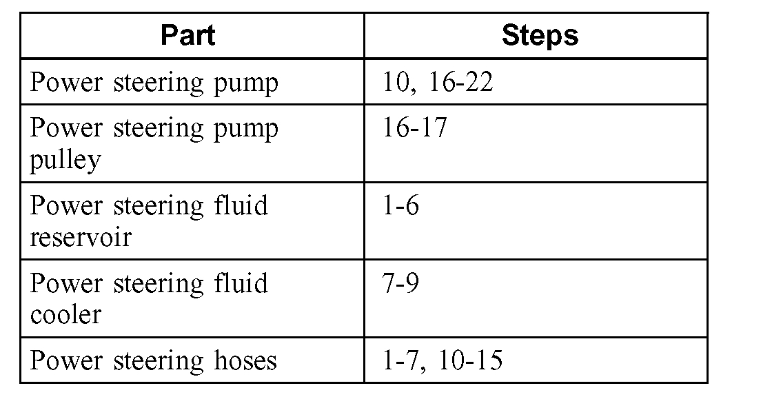

4. Remove the parts in the order indicated in the illustration and table.
To remove individual parts, only carry out the listed steps:
5. To install, reverse the removal procedure.
6. Fill and leak test the system.

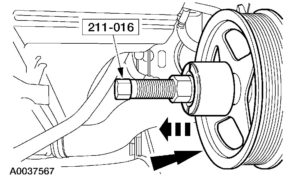

Item 17: Pulley Removal Note
Pic 5
1. Using the special tool, remove the pulley.

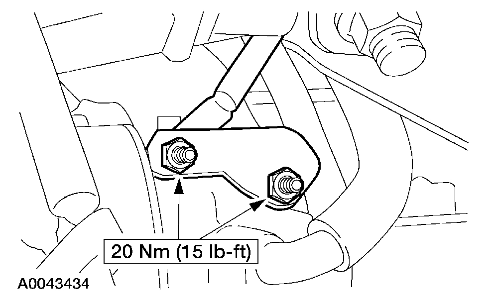

1. Remove the nuts and position the bracket and cable aside.
- Remove the pump bolts.

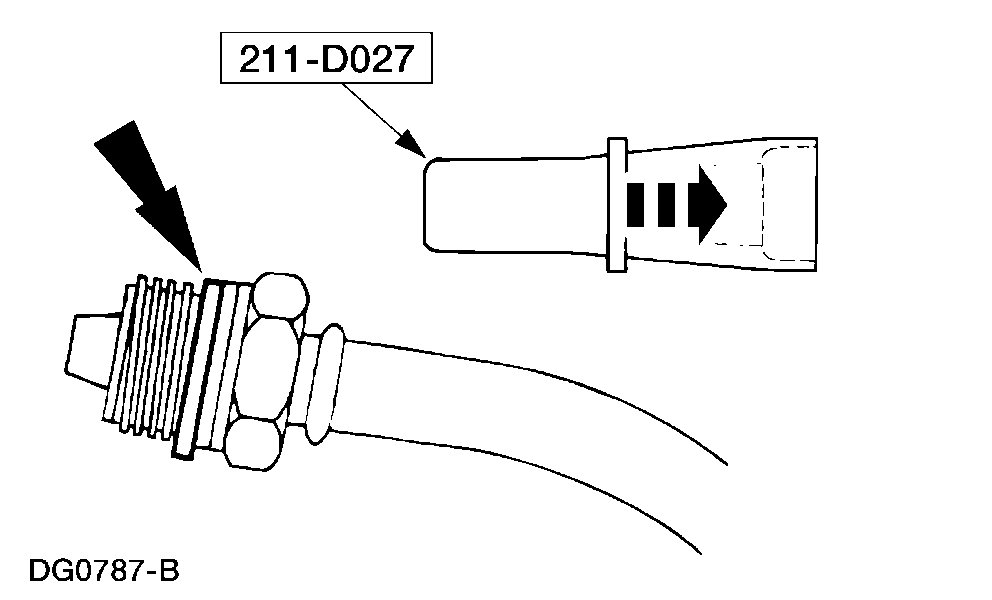

Item 20: O-ring Installation Note
Pic 7
1. Using the special tool, install a new Teflon seal on the pressure line fitting.

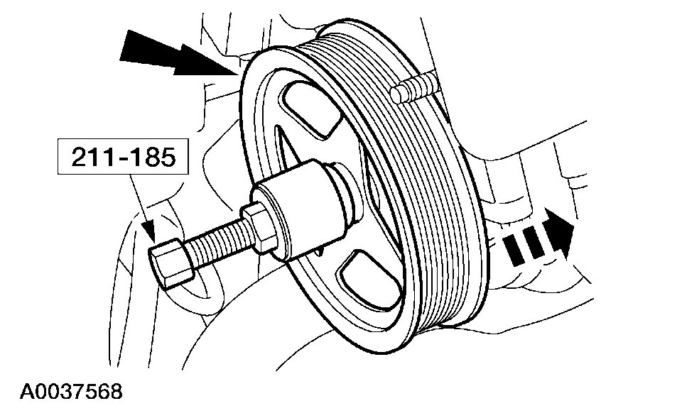

Item 17: Pulley Installation Note
Pic 8
1. Using the special tool, install the pulley.

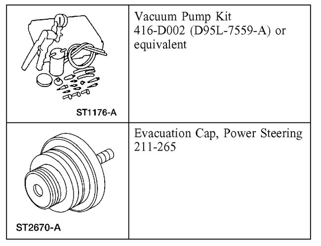

Power Steering System Purging
Special Tool(s)
Pic 9
CAUTION: If the air is not purged from the power steering system correctly, premature power steering pump failure can result. The condition can occur on pre-delivery vehicles with evidence of aerated fluid or on vehicles that have had steering component repairs. Failure to follow these instructions may result in personal injury.
1. NOTE: A whine heard from the power steering pump can be caused by air in the system. The power steering purge procedure must be carried out prior to any component repair for which power steering noise complaints are accompanied by evidence of aerated fluid.
Remove the power steering pump reservoir cap. Check the fluid.
2. Raise the front wheels off the floor.
3. Tightly insert the stopper of the vacuum pump into the reservoir.
