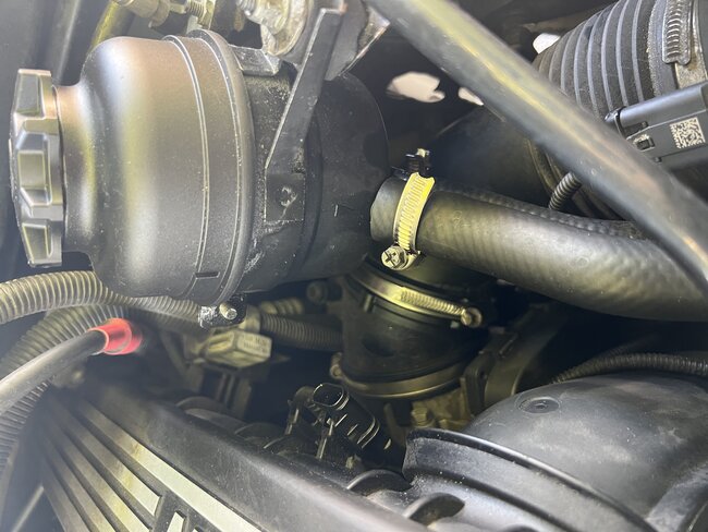

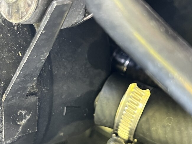

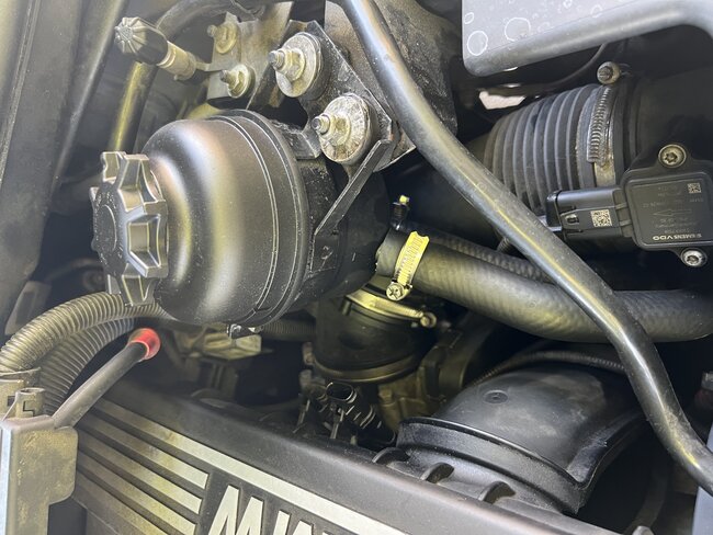

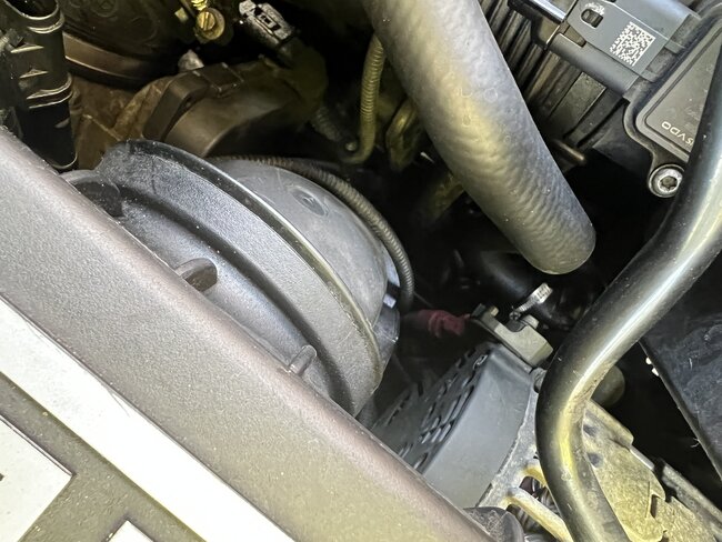

Here is picture of reservoir and hoses/clamps. All new.
Apr 15, 2023 at 9:31 AM

I do hear it. If the fluid is full and there is no air in the system, suspect a worn pump. If it still provides normal assist, you can continue driving it that way. Otherwise, the pump will likely need to be replaced.
Let me know your thoughts.

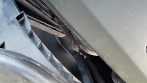

The mechanic changed the steering pump and we put in CHF fluid, but the noise is still there. However, noise came after I started driving it. When turning the car on, and when in idle, I would turn the wheels and the sound wasn't there. Only after the mechanic told me to take it for a test drive did the sound come back. After driving, when idle if I rev up the acceleration the sound whining sound was there even without turning the wheel.
He said we will have to look on Monday to see what the issue could be. I don't take it because of the steering pump. Can it be something with tension belt, serpentine belt, bearings, related to the A/C compressor? In regard to my A/C, I get the cold air however when I blast it to full strength it's really loud.

Anything is possible. If you remove the serpentine belt, start the engine and see if the sound is gone. If it is, then spin the belt-driven accessories by hand to see if anything feels tight or is rough when turning.
I did hear the noise in the second video. That is a traditional power steering pump noise. Also, I listened to the first video you sent and the noise in that video was only when turning. Is that still the same?
