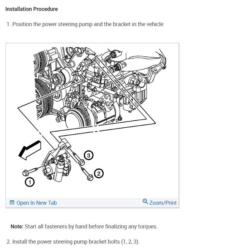

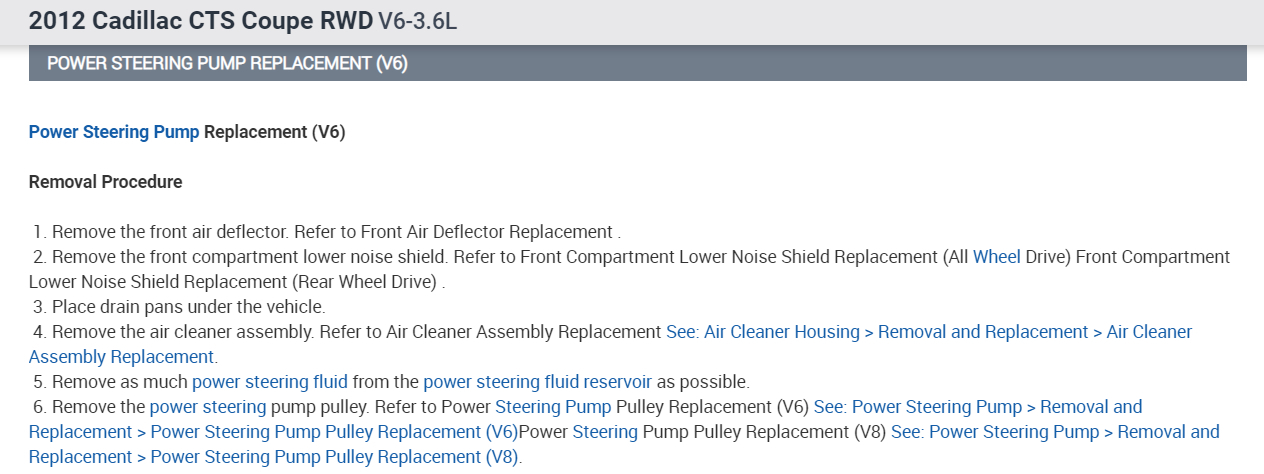

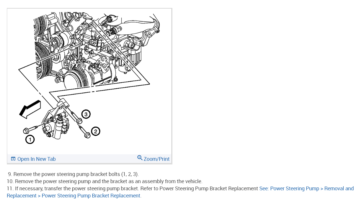

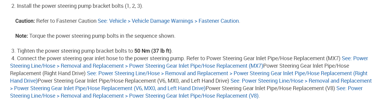

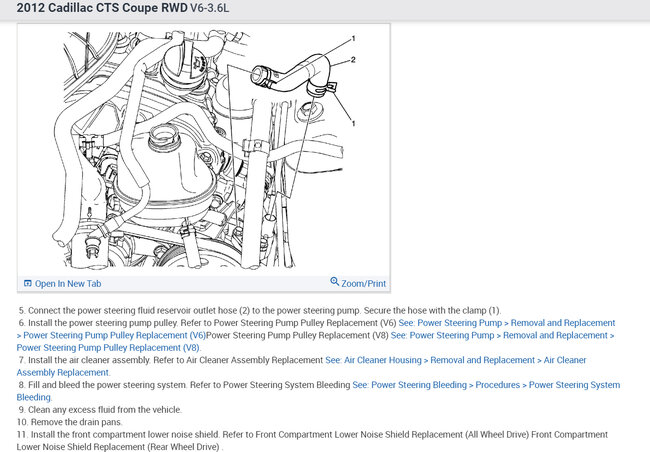

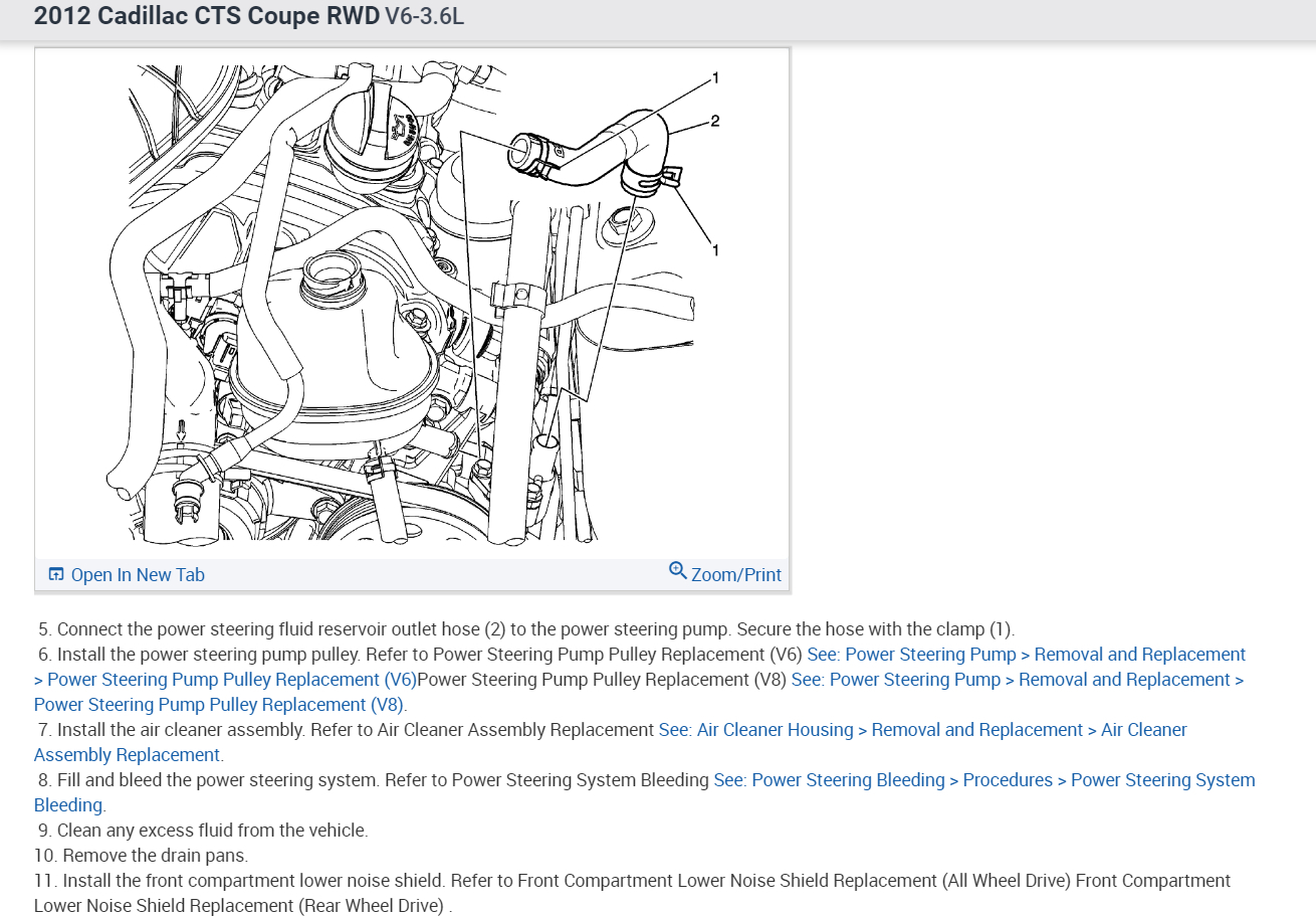

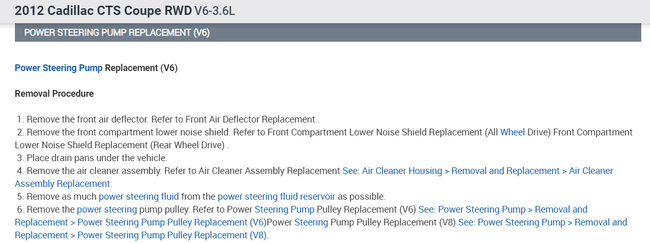

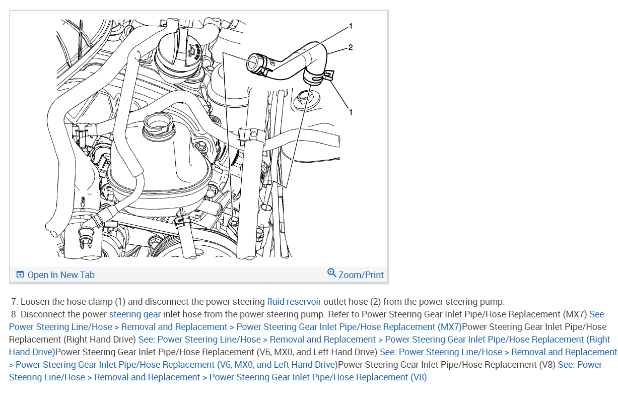

9 times out of 10 it will be the power steering pump. Here is how to replace the pump in the images below.
