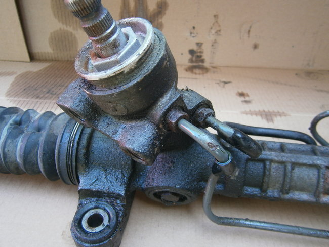

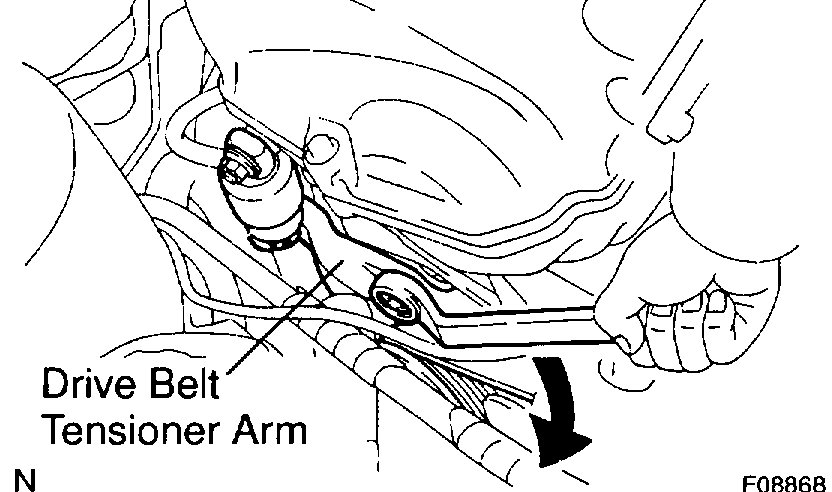

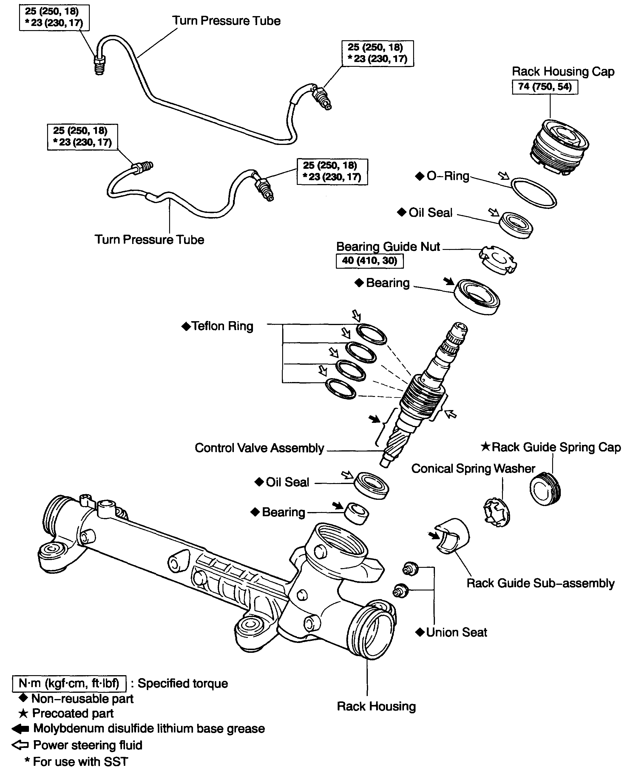

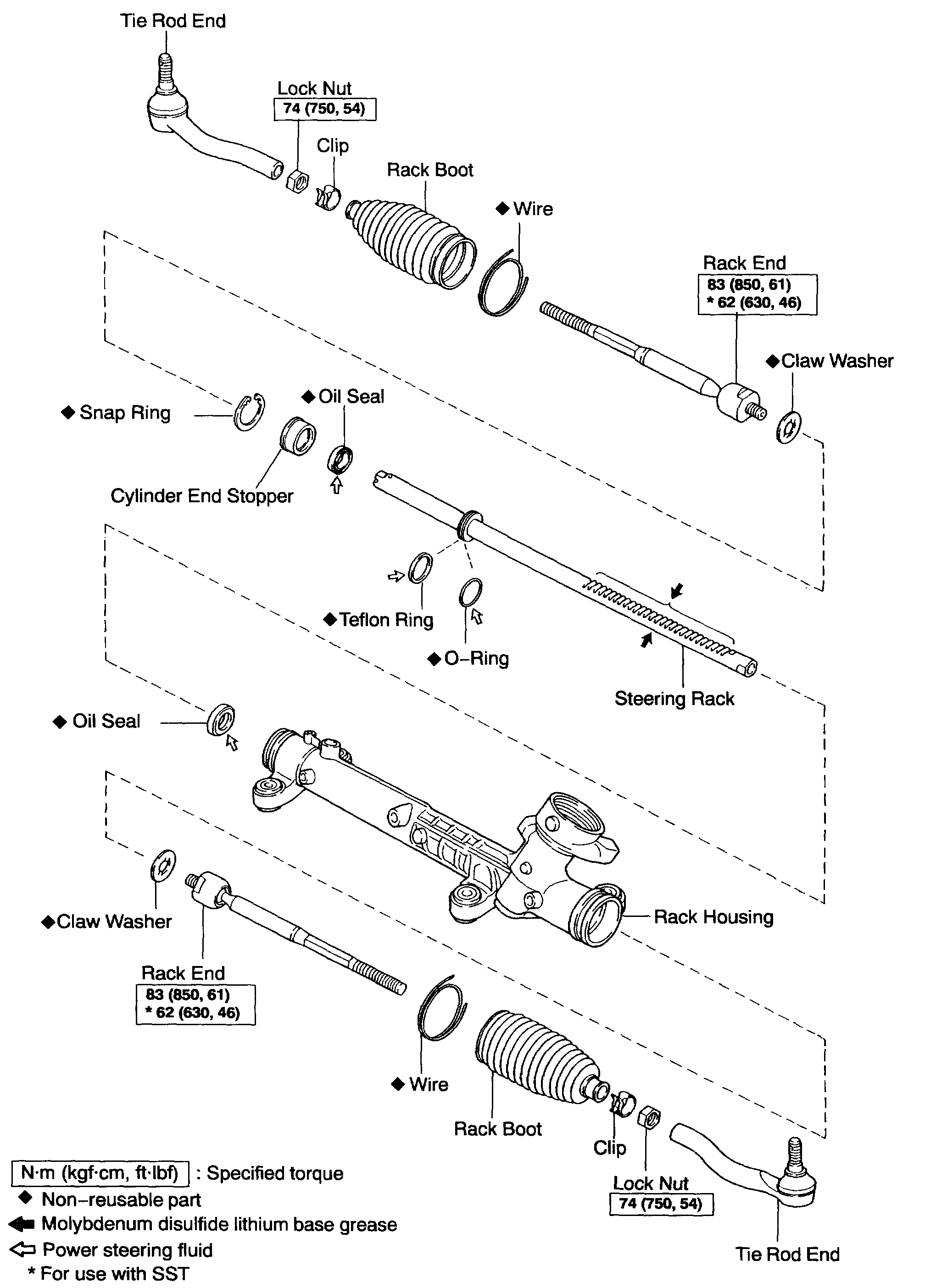

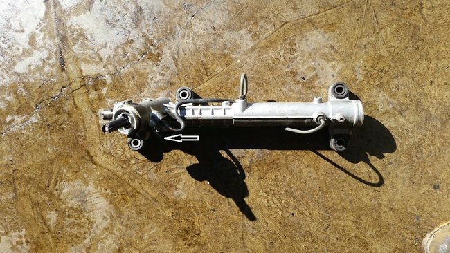

Okay, it's one of the steel lines on the rack. You may be able just to replace that steel line. However, here are the directions for rack replacement. The attached pictures correlate with the directions.
_________________________________________________
Removal and Installation
Vehicle Steering and Suspension Steering Steering Gear Service and Repair Procedures Removal and Installation
REMOVAL AND INSTALLATION
Part 1 Of 3
pic 1

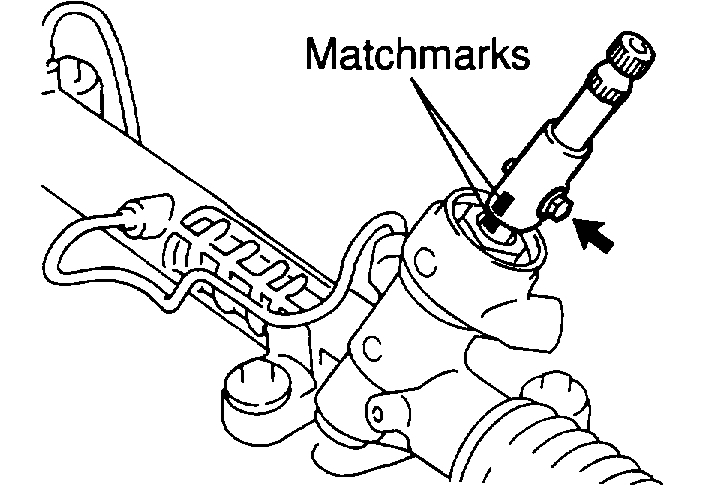

Part 2 Of 3
pic 2

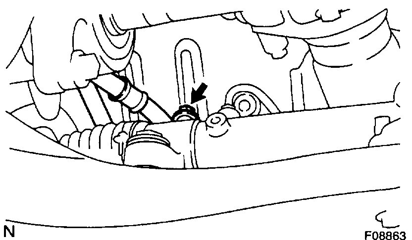

Part 3 Of 3
pic 3

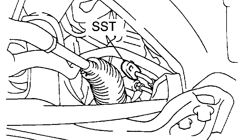

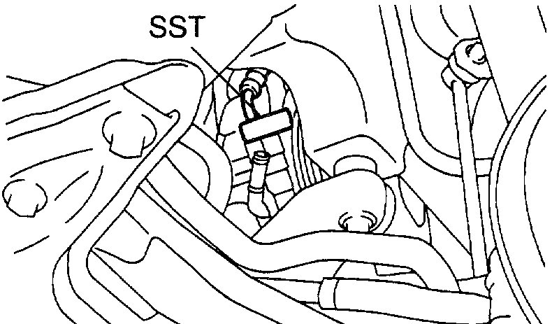

7. DISCONNECT PRESSURE FEED AND RETURN TUBES
Using SST, disconnect the pressure feed and return tubes.
SST 09023-38400
pic 5

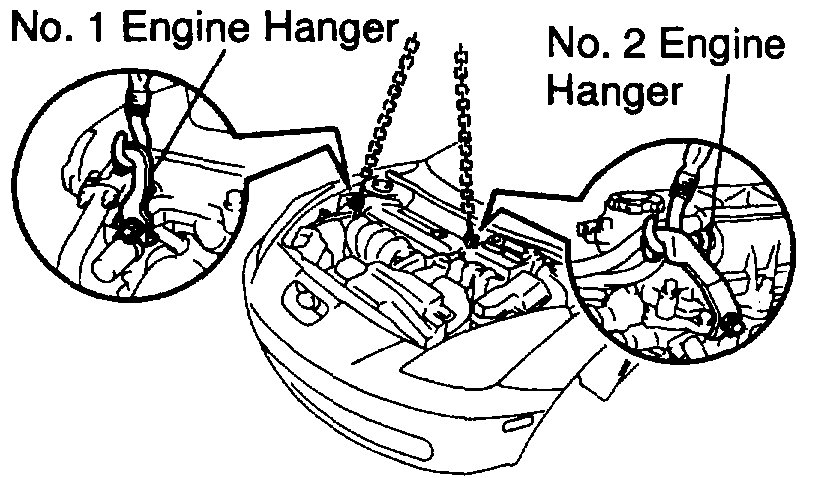

11. ATTACH ENGINE SLING DEVICE TO ENGINE HANGERS
a. Remove the 4 bolts and No. 2 cylinder head cover.
b. Disconnect the PCV hoses from the cylinder head cover.
c. Install the No.1 and No. 2 engine hangers in the correct direction.
1Z-FE Engine: Part No.:
No.1 engine hanger: 12281-22021
No.2 engine hanger: 12281-15040 or 12281-15050
Bolt: 91512-B1016
Torque: 38 Nm (388 kgf-cm, 28 ft. lbs.)
2ZZ-FE Engine:
Part No.:
No.1 engine hanger: 12281-88600
No.2 engine hanger: 12282-88600
Bolt: 91512-61020
d. Attach the engine sling device to the engine hangers.
CAUTION: Do not attempt to hang the engine by hooking the chain to any other part.

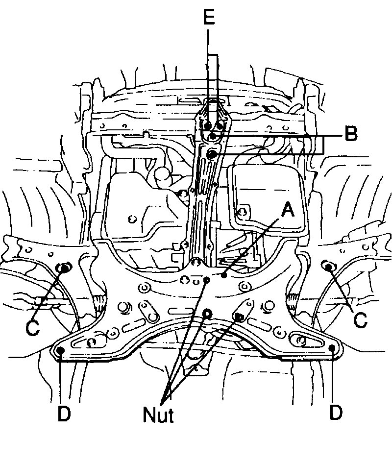

14. DISCONNECT ENGINE REAR MOUNT INSULATOR AND FRONT SUSPENSION MEMBER
Remove the bolt (bolt A) and 3 nuts, and disconnect the engine rear mount insulator and front suspension member.
15. DISCONNECT ENGINE FRONT MOUNT INSULATOR AND FRONT SUSPENSION MEMBER
Remove the 2 bolts (bolt B) and disconnect the engine front mount insulator and front suspension member.
16. SUPPORT FRONT SUSPENSION MEMBER WITH LOWER SUSPENSION ARM
Using a transmission jack, support the front suspension member with lower suspension arm.

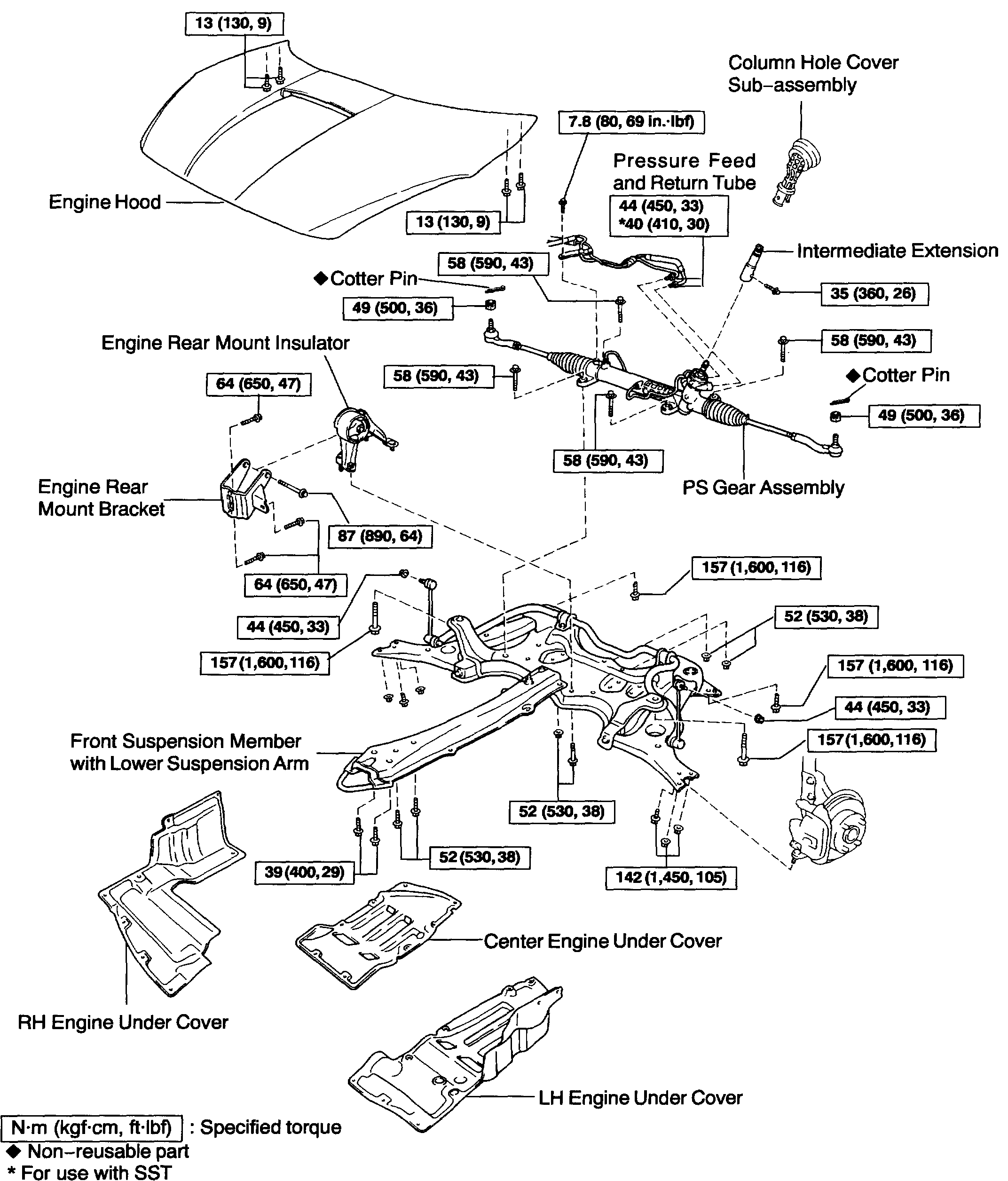

17. REMOVE FRONT SUSPENSION MEMBER WITH LOWER SUSPENSION ARM AND PS GEAR ASSEMBLY
Remove the 6 bolts (bolt C, D and E) and front suspension member with lower suspension arm and PS gear assembly.
pic 8
18. REMOVE PS GEAR ASSEMBLY
a. Remove the 4 bolts and PS gear assembly from the front suspension member.
b. Place matchmarks on the intermediate extension and control valve shaft.
c. Remove the bolt and intermediate extension.
19. REMOVE ENGINE REAR MOUNT INSULATOR AND ENGINE REAR MOUNT BRACKET
a. Remove the through bolt and engine rear mount insulator.
b. Remove the 3 bolts and engine rear mount bracket.

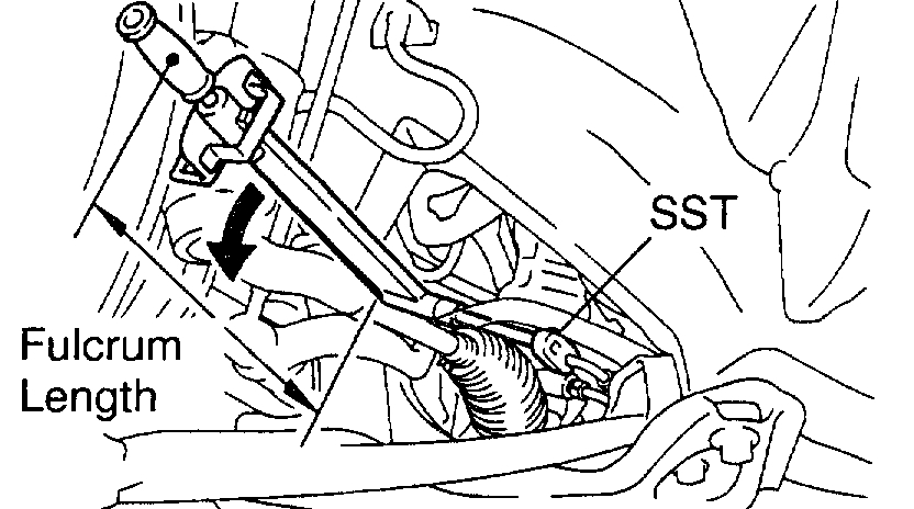

12. CONNECT PRESSURE FEED AND RETURN TUBES
Using SST, connect the pressure feed and return tubes.
SST 09023-38400
Torque: 40 Nm (410 kgf-cm, 30 ft. lbs.)
HINT:
^ Use a torque wrench with a fulcrum length of 345 mm (13.58 inch).
^ This torque value is effective in case that SST is parallel to a torque wrench.
