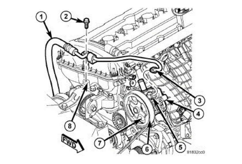

There are tubes on the steering gear and there are pressure lines that attach to the steering gear as well. I need to know which ones.
https://www.2carpros.com/articles/power-steering-problems

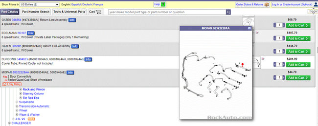

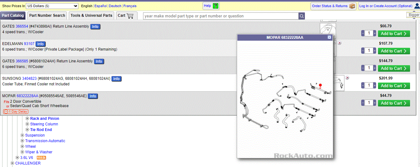

The second picture is more on point for the failure. That is a return line assembly.
https://www.2carpros.com/articles/power-steering-fluid-flush
The part is attached from Rock Auto. That price could vary from $60.00 to $200.00 depending on the line selected.
The labor is 1 hour or about 1250-150.

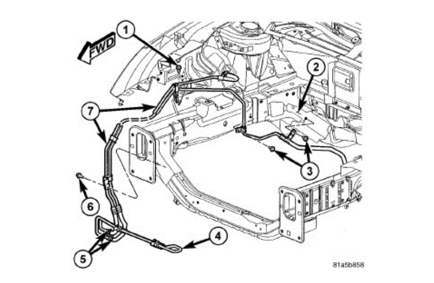

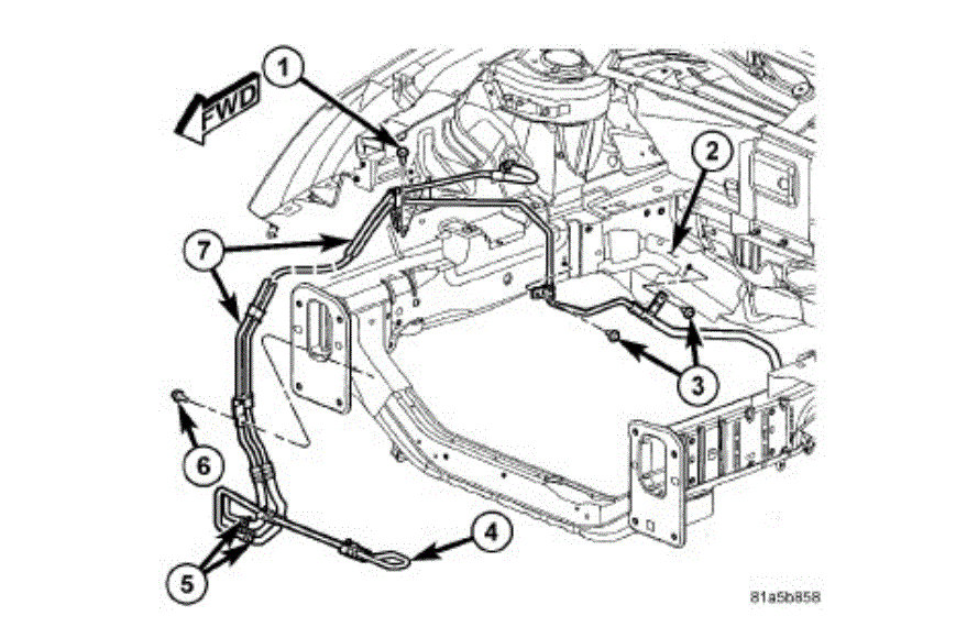

7. Remove the return hose (1) at the return tube (2). If equipped with a screw-clamp, be sure to save the original clamp for reinstallation.
8. Remove the hose clamps (5) attaching the fluid return hoses (7) to the power steering fluid cooler line (4). Separate the return hoses from the cooler line.
9. Remove the return hose routing clamp screws (3) securing the return hose (7) to the frame rail.
10. Remove the return hose routing clamp screw (6) securing the return hose (7) to the frame rail.
11. Lower the vehicle.
12. Remove the return hose routing clamp screw (1) securing the return hose (7) to the body.
13. Remove the return hose from the vehicle.
