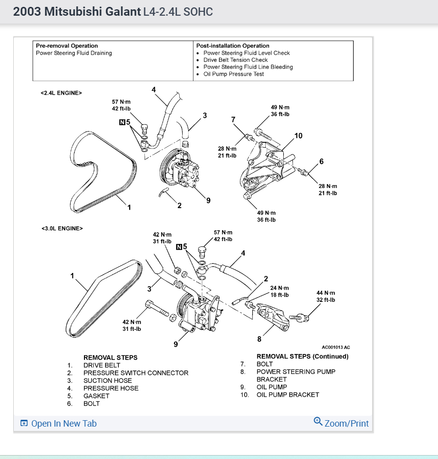

With the engine running, remove the power steering pump cap and use a flashlight to see if the fluid is circulating, if you can see the fluid moving around the pump is bad and you need a new one. here are the instructions on how to get the job done. Please let me know what happens and upload a short video of the problem so I can see what's going on.
